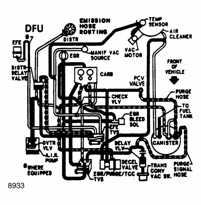

Vacuum lines diagram
JDL
  • 16,098 POSTS
This is for 5.0 calif automatic
https://www.2carpros.com/forum/automotive_pictures/170934_silverado_vacuum_lines_1.jpg

1986 Chevy Silverado V8 Four Wheel Drive Automatic
i have a 1986 suburban silverado there is no vacume digram under the hood. I want to hook the way it is supposed to go(cali or fed). 350 moter some vacum is connedted not all of it. From what I have found there is no ecm no cat(never was), 4 barrel carb egr ok engin is jasper air cleaner only has 1 hose connection for hot air moter. All vacum digrams welcome also proper air pump digram needed. Thanks in advance joe

What size engine? 5.0L, 5.7L etc. Gasoline or diesel?
Tuesday, December 29th, 2020 AT 1:53 PM (Merged)
JDL
  • 16,098 POSTS
https://www.2carpros.com/forum/automotive_pictures/170934_86_chevy_truck_1.jpg
Don't know if the above will work for you or not? Welcome to the forum.

NUNOIT
Just a fue? What is efe valve (heat riser), dtstr tvs (?) And is hose that connects to air cleaner (between vapor can and decel vav) just a bleed for vapor canianster, other than that I think I can make work. There is some weard valve that connects to vapor canister wonder what it is, has 4 ports 2 for vapor 2 for vac ill see if I can pix to post. Also carb has bowl vent where does it connect. (Pluged now) once again thanks joe

I believe tvs is thermal vacuum switch and efe is early fuel evaporation.
NUNOIT
5.7 gas

Hi, the autozone site has free diagrams. You have to register your vehicle, it's free. Then click on repair info. I believe the vav diagrams is under the emissions link. Wiring diagrams under chassis link.

I need to put vacuum hoses on

83CHEVY
But all the emssions have been removed all I have is the carb the vacuum supply and transmission mod. And power brakes
KHLOW2008
  • 41,815 POSTS
Since you only require the trans vacuum, forget about all others and get the vacuum direct from the source, which is the carburettor. One vacuum line would do.
