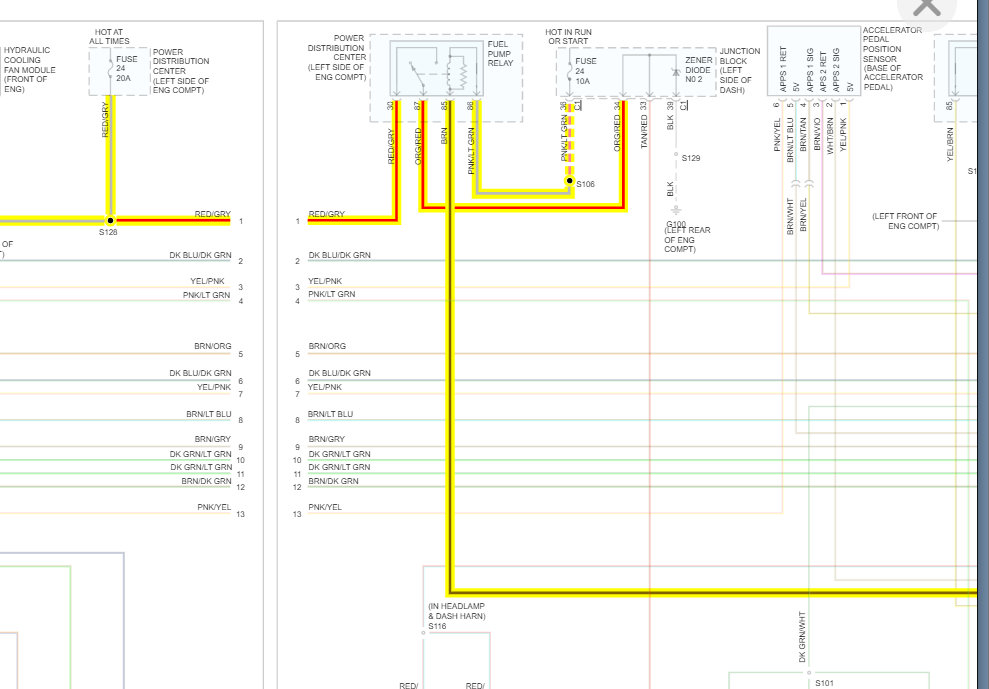

Please bear with me, it's a long one. In November my vehicle started not starting. I couldn't hear the fuel pump. I replaced the relay and fuse. I started fine for a few weeks. I noticed that the battery was draining and I had the alternator tested. It was bad. So, I replaced the battery and alternator. Started fine for a few weeks. This is all hit or miss. I replaced the fuel pump in December. It started fine until April. Now it's back to not starting. Sometimes it would and sometimes it wouldn't. It doesn't matter the time of day or how long I've driven it. Now I went to visit my mom the other day and it started fine. I was at her place for a few hours. Again, it wouldn't start. I couldn't hear the pump. About 5 minutes later it started. It idled rough for a few seconds then shut off. Will not start again.

There could be a couple things causing this, but we need to start with finding out what we have for power at the relay when this is happening.
Basically, if it is a new relay and new pump then we can assume for now that they are not the cause.
So that means we need to check for power and ground at the relay when this issue is happening. Clearly if the engine is starting then the issue is most likely not there.

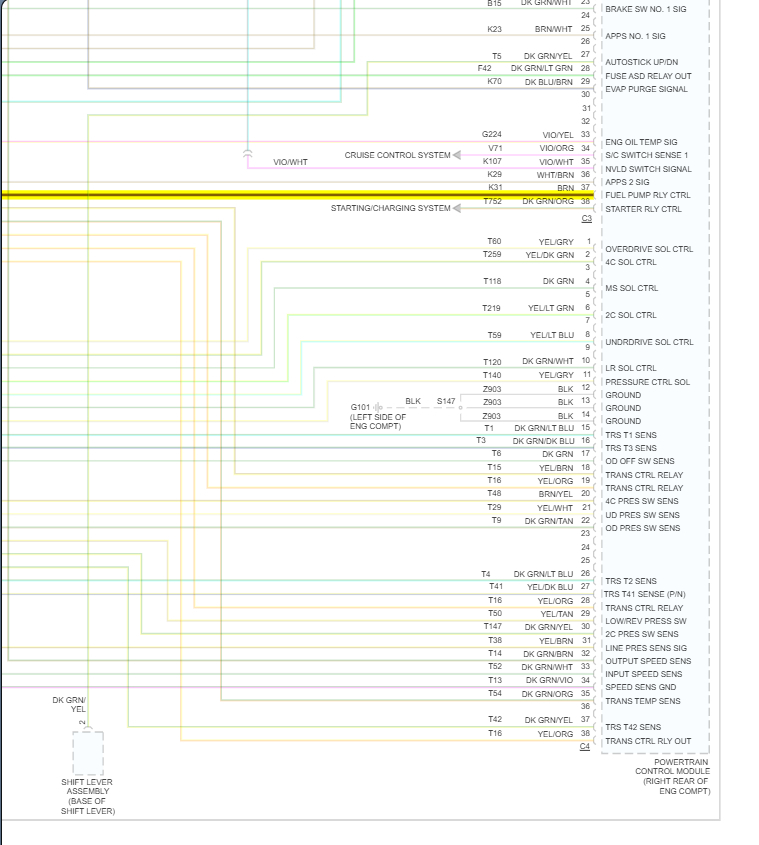

So that means we need to remove the relay and check for ground on the terminal to the PCM. Basically, what is happening is the Fuse 24 from the fuse block on the left side of the dash, is supplying power to the control side of the relay. The PCM grounds the relay on the Brown wire and this causes the contacts in the relay to close sending power from fuse 24 in the engine compartment fuse block to the fuel pump.
The way to check and see if the PCM is grounding the relay is to put your meter on battery positive and then the black lead on this terminal then turns the key on. The meter should read battery voltage if the PCM is grounding the relay.
If not, then the PCM is the issue.
If it is, then we need to check for power from both fuses and then check the wiring to the fuel pump if that all checks out.
Please run through this and let me know what you find with this, and we can go from there.

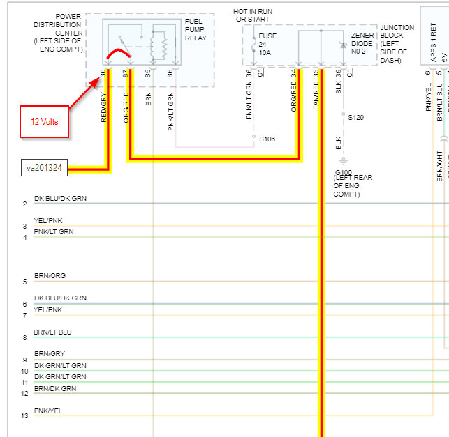

Okay, here is what I did so far: I used a test light and the relay and fuse are getting power. I unhooked the wires from the pump and used a battery charger to hook them on to the red and black wires and the pump ran. I also peeled back some of the black wire hooked the wires back on to the pump. I then got gator clips and hooked one end to the black wire from the pump to a good ground. Turned the key and nothing. Pump didn't run. I'm thinking it's the red power wire. Could I have a bad relay or somewhere the red power wire is bad between the fuse box and the pump.
Tuesday, May 10th, 2022 AT 10:57 AM
Just want to make sure I understand because I think you are on the issue.
You checked pin 30 of the fuel pump relay and have 12 volts? If so, jump 30 to 87 and the pump should come on.
If this comes on, then your wiring and pump are fine. This means we will have a relay issue or a control side issue.
The next thing to check is for 12 volts with the key in the on position at pin 86 of the relay. If you have 12 volts here, then we need to check for a good ground on pin 85.
You check for a ground by moving your lead to a 12-volt source and then use this terminal as your ground and turn the key on. Your meter should read 12-volts, or the test light should come on.
See the wiring diagram below for the details on this.
