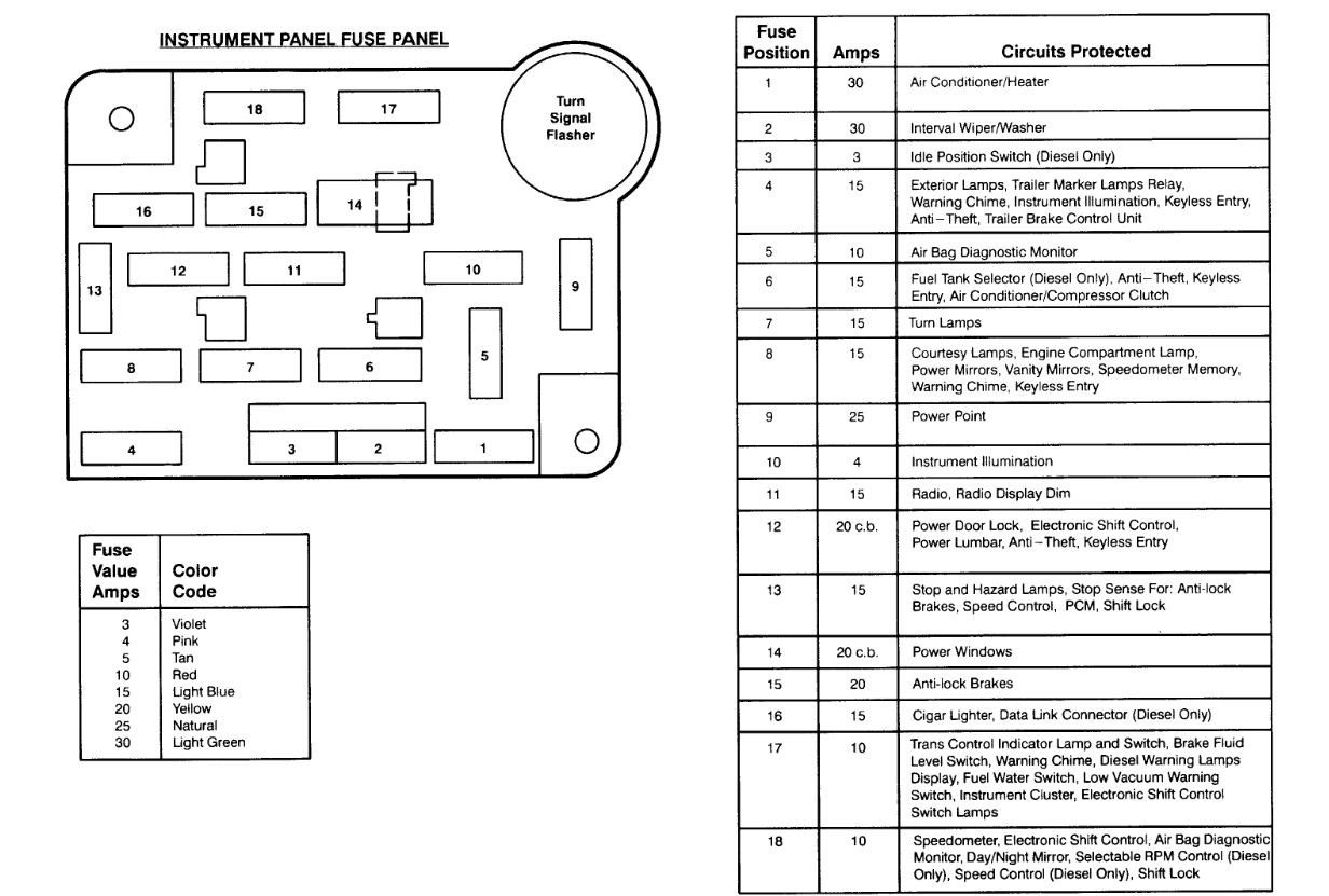

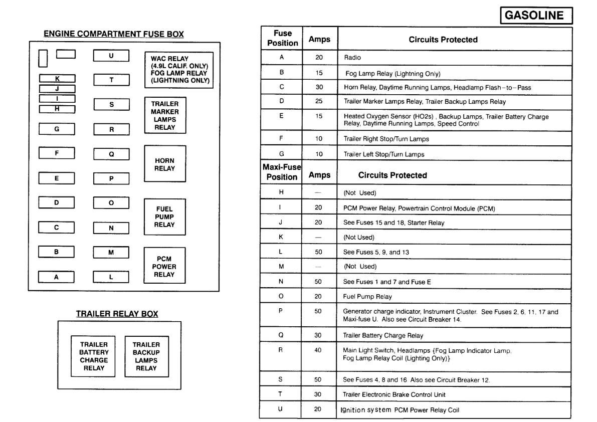

My truck will turn over but not starting. I have checked and found out that I am not getting spark, I can't hear the fuel pumps turn on and my OBD1 code reader is not working. My initial thought was that my ECM was bad. I just replaced the computer this morning and still nothing.
Thoughts?

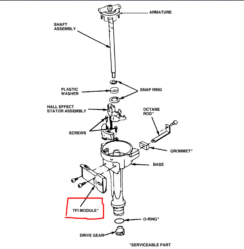

If you lost spark, my first suspect is the TFI module on the side of the distributor. That is what most people refer to as a spark module. Have you done anything with that part? This sounds like a fuel pump or the fuel pump relay has gone out. When you turn the key to the on position without cranking the engine over can you hear the fuel pump run in the tank for 5 seconds?
Please run down this guide and report back. Check out the diagrams (Below). Let us know what happens and please upload pictures or videos of the problem.
