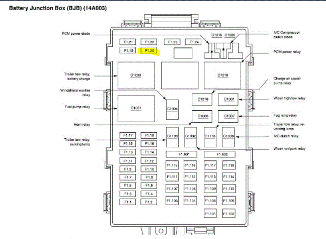

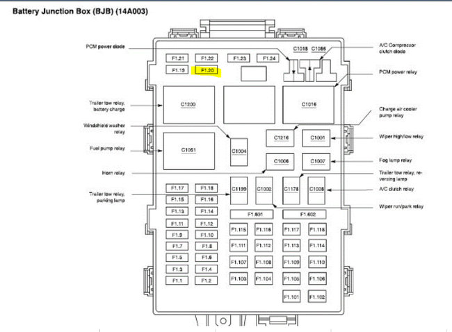

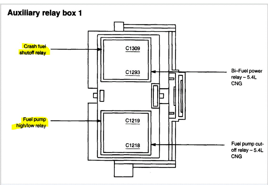

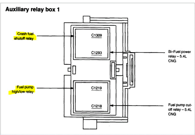

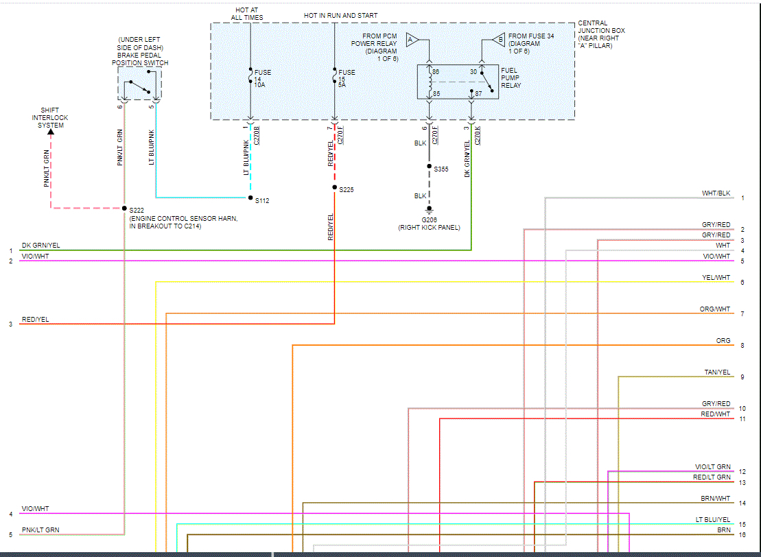

Have you checked fuses and the relays? This vehicle has a fuel pump relay and a fuel cut relay in the event of an accident. Both are located in the aux relay box. See pic 1.
In pic 2 below, I highlighted the fuel pump relay fuse. Check to make sure the fuse is good and there is power both in and out from the fuse. This is the fuse box under the hood.

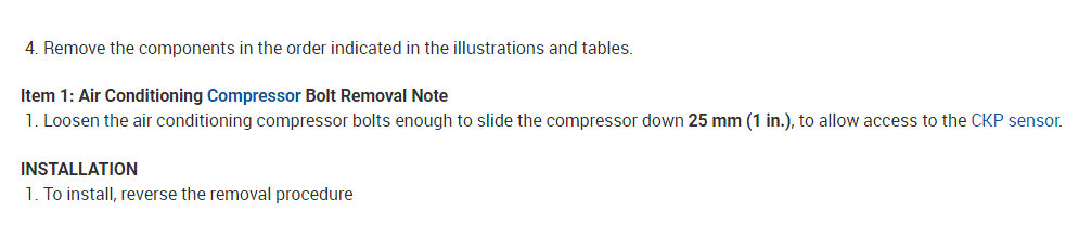

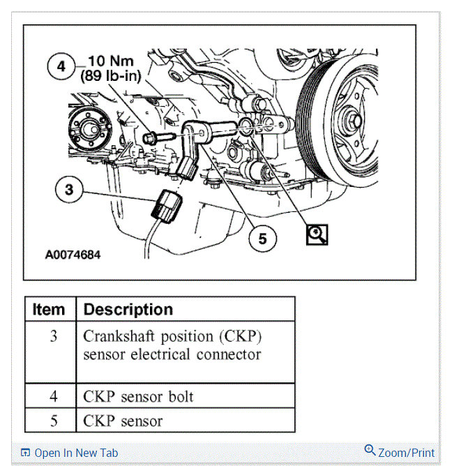

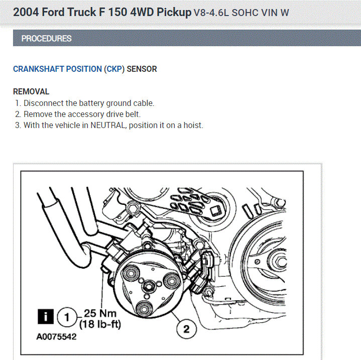

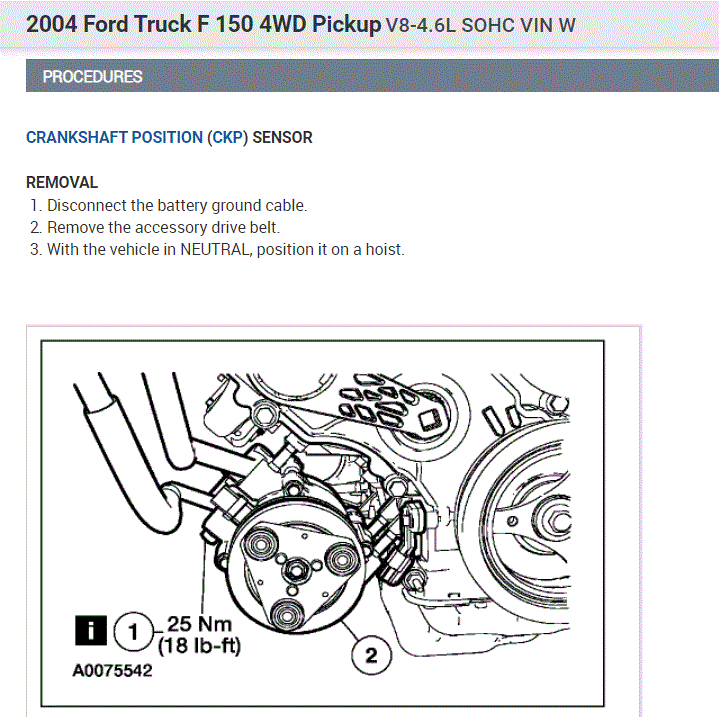

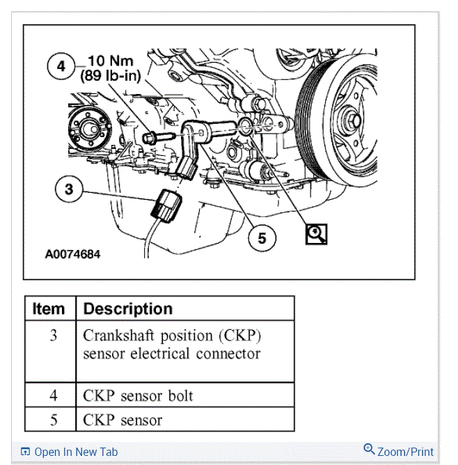

The crank sensor is new, but that doesn't mean it isn't bad. If you have a live data scanner, you can use that to see if there is an RPM signal. If there isn't, I would try a different crankshaft position sensor.
Here is a link to help:
The attachments below are specific replacement procedures specific to your vehicle.

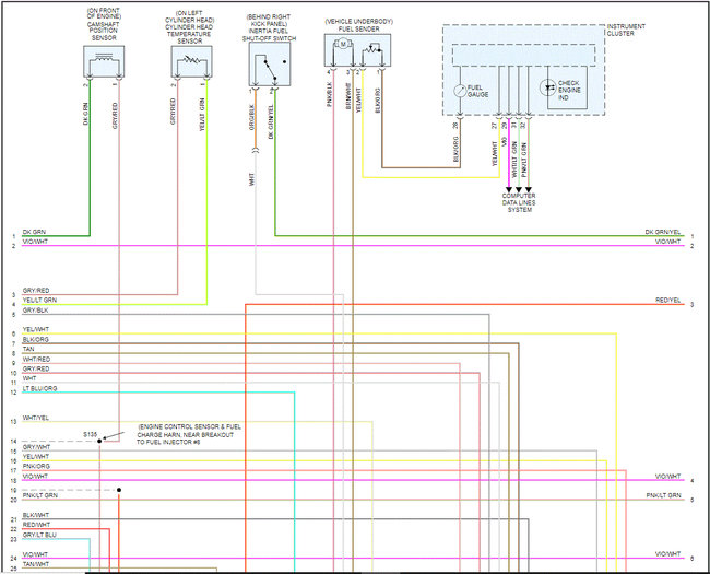

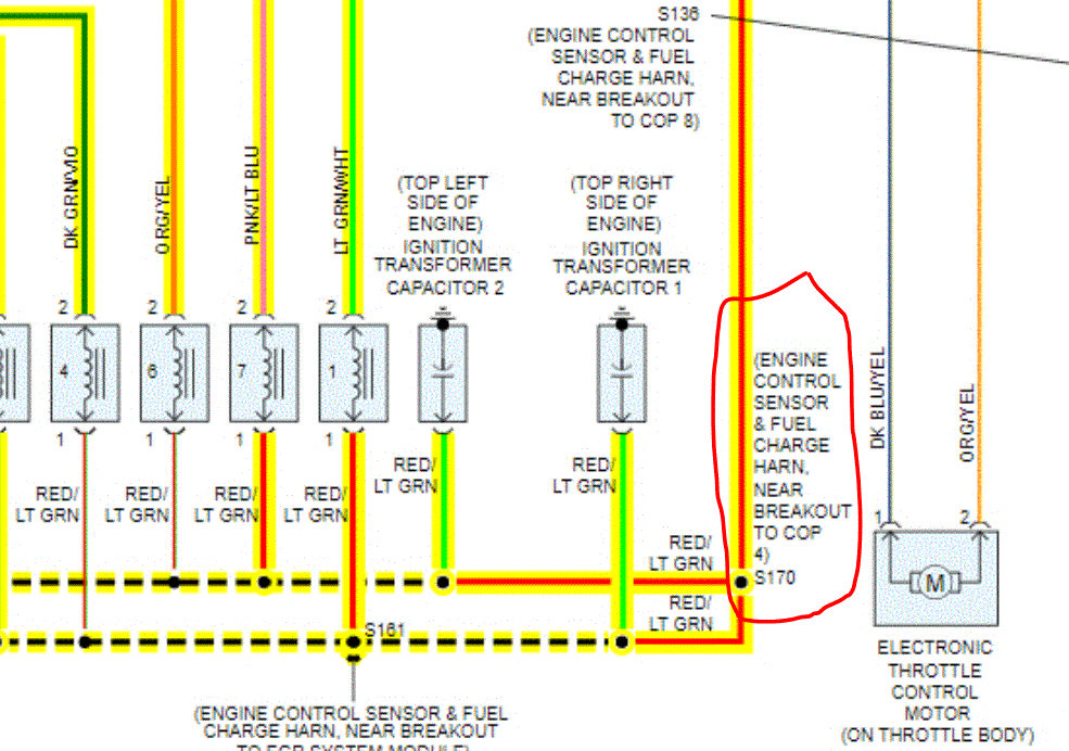

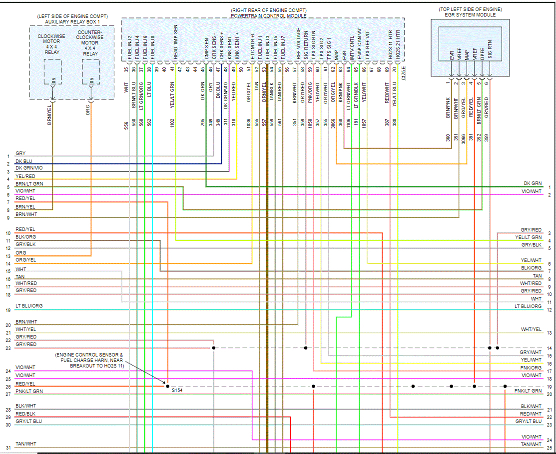

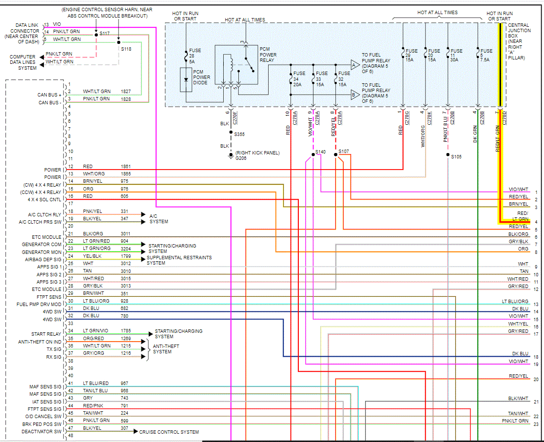

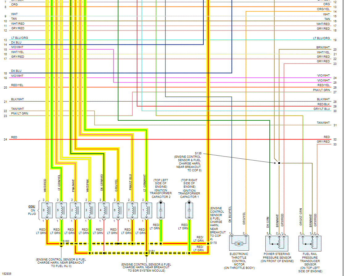

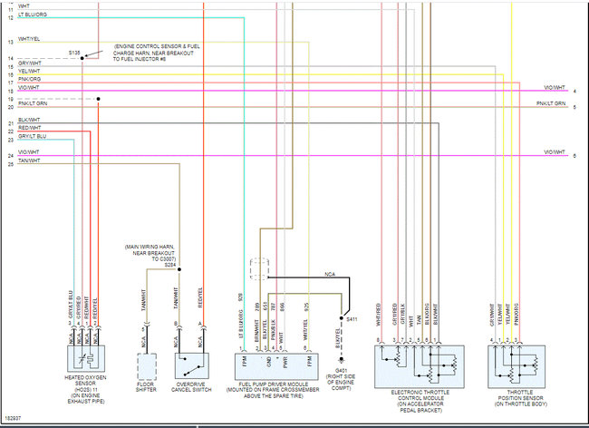

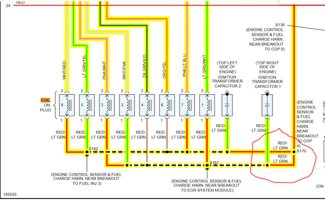

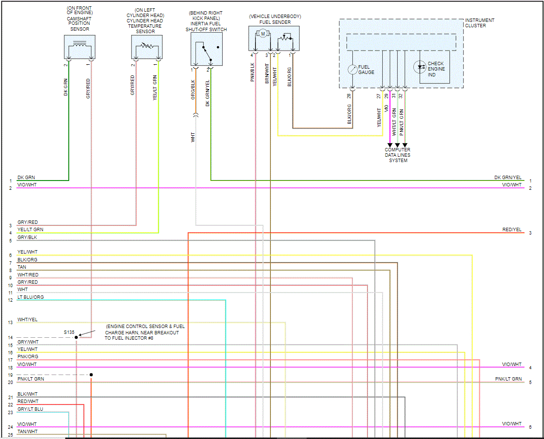

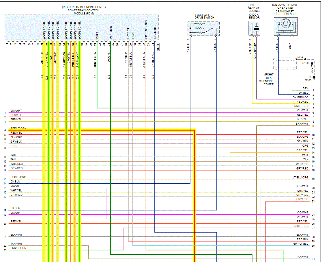

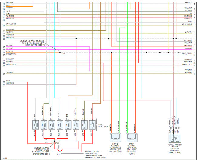

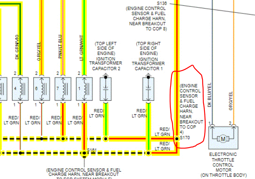

Okay, if I am reading the schematics correctly, the coils have power at all times, but the ground is provided by the PCM. That is what would actuate the coil to fire. Take a look a pic 1 below.
I highlighted everything with the coils. Note there is a red/lt green wire that I circled. That is coming from the central junction box and should have power and should have power when the key is in the start or run position. Check for power and let me know if it's there.

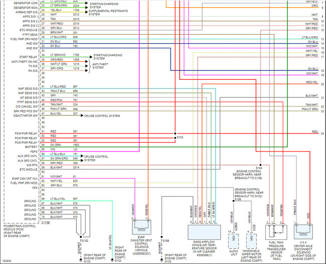

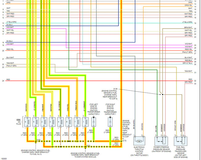

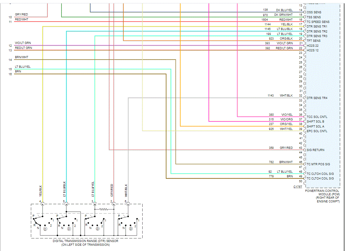

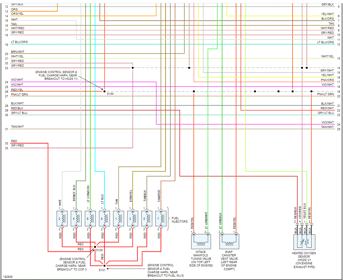

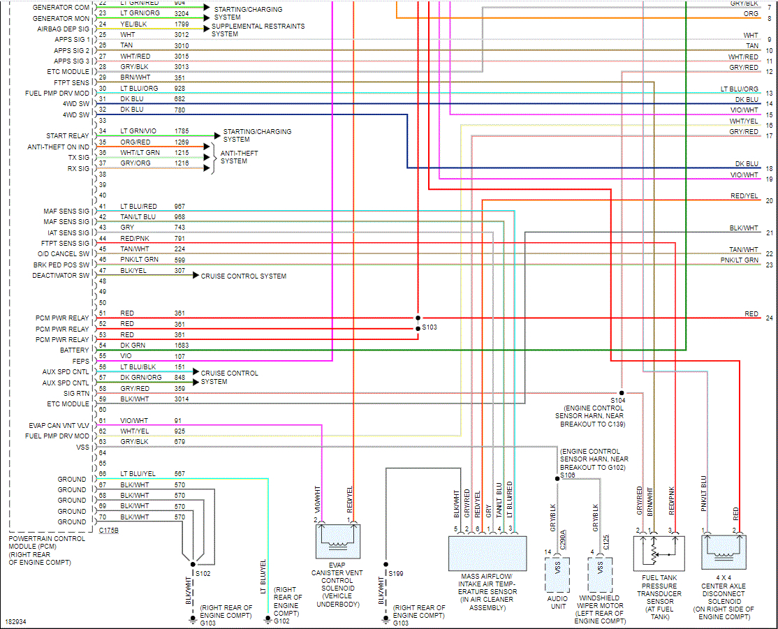

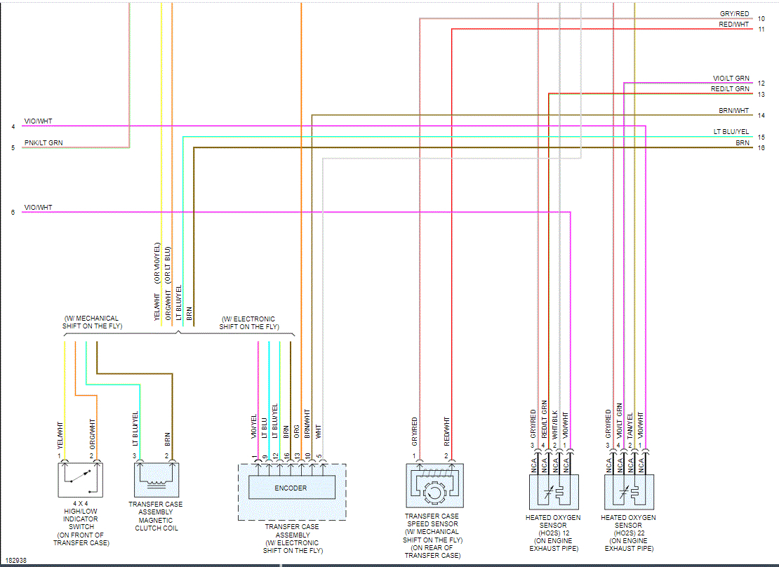

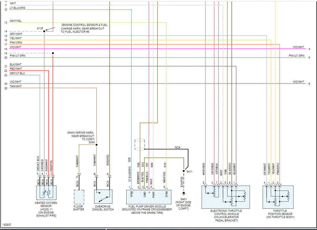

The remaining pics include the entire powertrain management wiring schematics. I had to cut them in half to make them readable, but I did overlap them so you can follow from one to the next. I wanted you to have them as a reference. Additionally, I highlighted all the wiring to the PCM from each coil. All highlighted wires are tied into the coils and power to them. Since power is coming from the red/lt green wire, the PCM must be providing a ground path. That is why I'm suggesting checking that wire for power. If it isn't there, we need to see where it's lost. If it is there, we need to move to the PCM.
I remember in one post you indicated there is power to the coils. I want to confirm that is the wire you checked.

I have power to the coils but it is not battery voltage. It starts at 5.0 volts and drops to 1.5 volts. But I have power on both wires to coils.
Saturday, June 5th, 2021 AT 1:25 PM

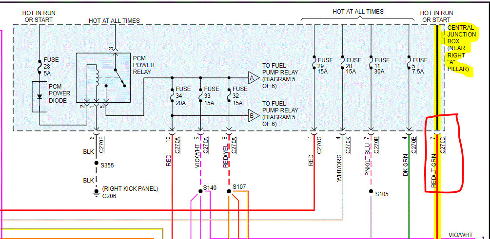

  • 110,194 POSTS

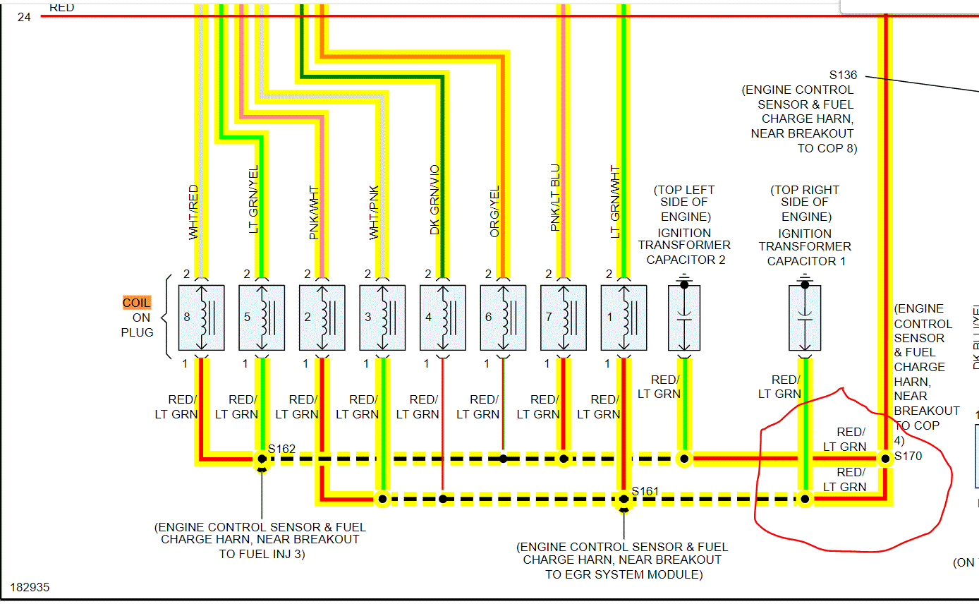

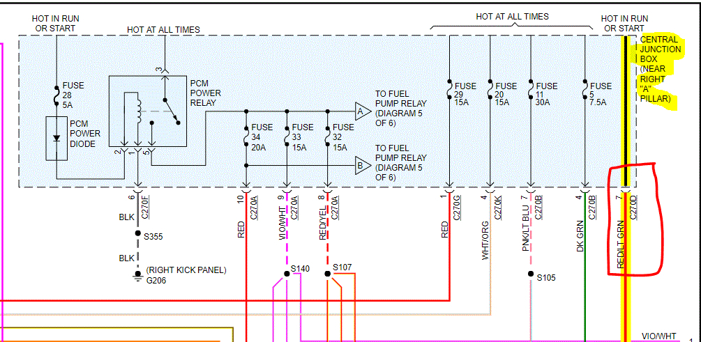

You shouldn't have power on both wires. One is power, the other is open until the PCM provides a ground path. Also, the voltage shouldn't drop. Were you able to locate the splice I mentioned? When you have a voltage drop when under a load, it's usually a faulty connection.
If you look at the pic below, it shows the splice I'm referring to. Also, go back to the central junction box, locate the red wire with a light green tracer, and see if there is 12v there. See pic 2 below.
Let me know what you find.
Saturday, June 5th, 2021 AT 8:36 PM
JOHN JONES4
  • 5 POSTS
Joe, thanks for all your help. That wire was the culprit. About three inches from the engine harness connector the wire was chafed into it had been rubbing against the accumulator. Again thanks for all your help.
