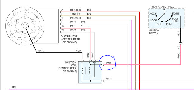

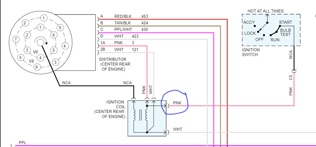

The crankshaft position sensor was my first thought, but this doesn't have one. If you have no spark, at the coil there will be a pink wire. It should have power with the key in the run or start position. Check to see if that is present. See pic below.
See pic below.
Wednesday, August 2nd, 2023 AT 7:13 PM
RELMS7432
  • 13 POSTS
I checked for spark on multiple locations and got rapid flashes on my tester, so I believe that I have spark. From the plugs, the sequence was 1 strong flash followed by several weaker ones repeated. The flashes from the ignition coil were always strong. From the distributor cap, the flashes were 1 strong followed by several weaker ones. Some were so weak that I could tell whether or not it was flashing.

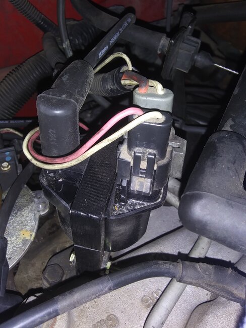

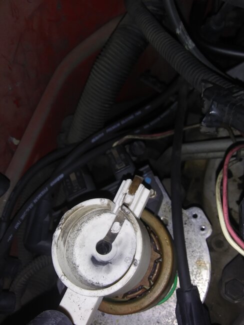

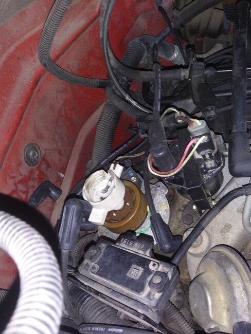

I replaced the distributor cap tonight. It still cranks without starting after driving at just under 210 degrees. Attached are some pictures of the distributor rotor button and ignition coil while I had everything taken off. There was a little corrosion on the inside of the distributor cap (not pictured) on the ends of the inside prongs. The rotor button looks a bit rough, and it’s only been on since May. When I replaced the original in May, the original rotor button was completely flat/not raised and blackened.
Also, I tried to wiggle the distributor clockwise and counterclockwise from the rotor button, but there was very little movement. It did move a little, but very little. Is that how you wanted me to test it?
Thursday, August 3rd, 2023 AT 7:37 PM
  • 110,192 POSTS
I noticed in the third pic, the orange wire near the coil connector looks burnt. Check to make sure there is no issue with it. Also, I can't tell in the picture where it is leading to. Let me know if you can tell.

For the orange wire, it looks like it is leading to either the fuse box or towards the ECM. I’m not quite sure since the wire goes way behind the engine while threaded into wiring heat shields.

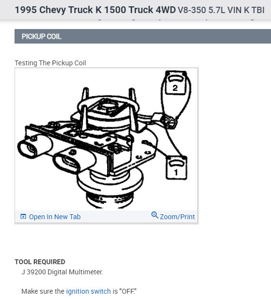

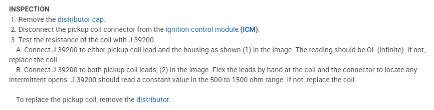

I was thinking about the erratic spark. Have you replaced the pickup coil in the distributor? Take a look below. I attached the directions to test it. See if it passes. That may be the entire problem.
Saturday, August 5th, 2023 AT 11:27 PM
RELMS7432
  • 13 POSTS
Well, the pickup coil is a bit complicated. When the ignition control module was changed in May, the tech broke the clip holding the pickup coil to the module and ended up using nylon zip ties to hold it. Since then, that tie had broken from the heat in the cap and I had replaced it with a stainless-steel tie. The pickup coil is held firmly in place by it with no wiggle but is not crushing it. There is heat resistant electrical tape around the tie where it is threaded between the 2 wires of the pickup coil to help mitigate damage to the wires. As far as I can tell, it is secure with no signs of damage except for a small amount of fraying around the yellow wire when it reaches the connection point of the ICM.
