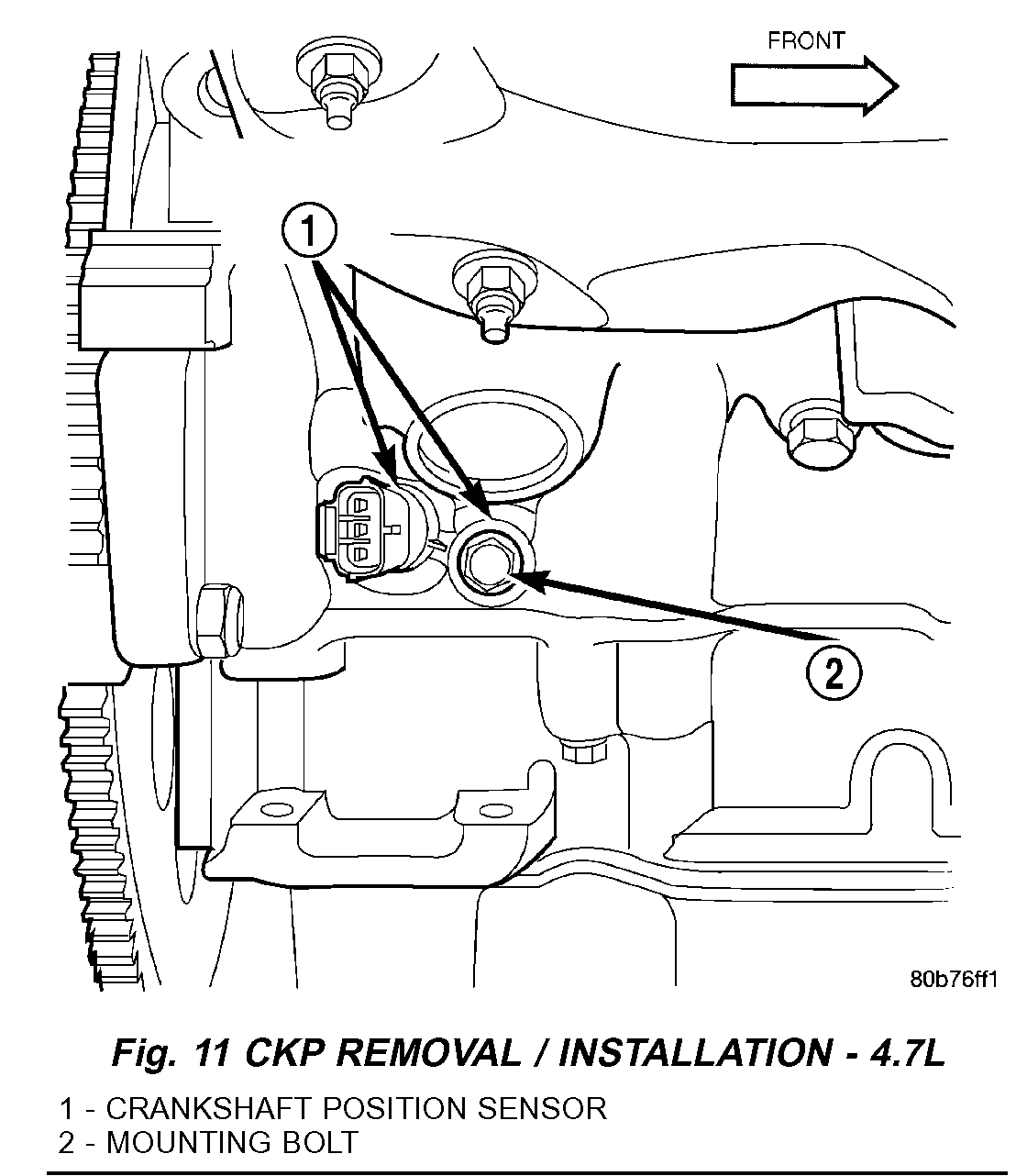

Since this happens when it is hot, the first thing I suspect is the crankshaft position sensor. It is not uncommon for them to fail and not set a code. Take a look at this link:
What you really need to do is check for spark and fuel when the engine refuses to start. Here are general directions for both:

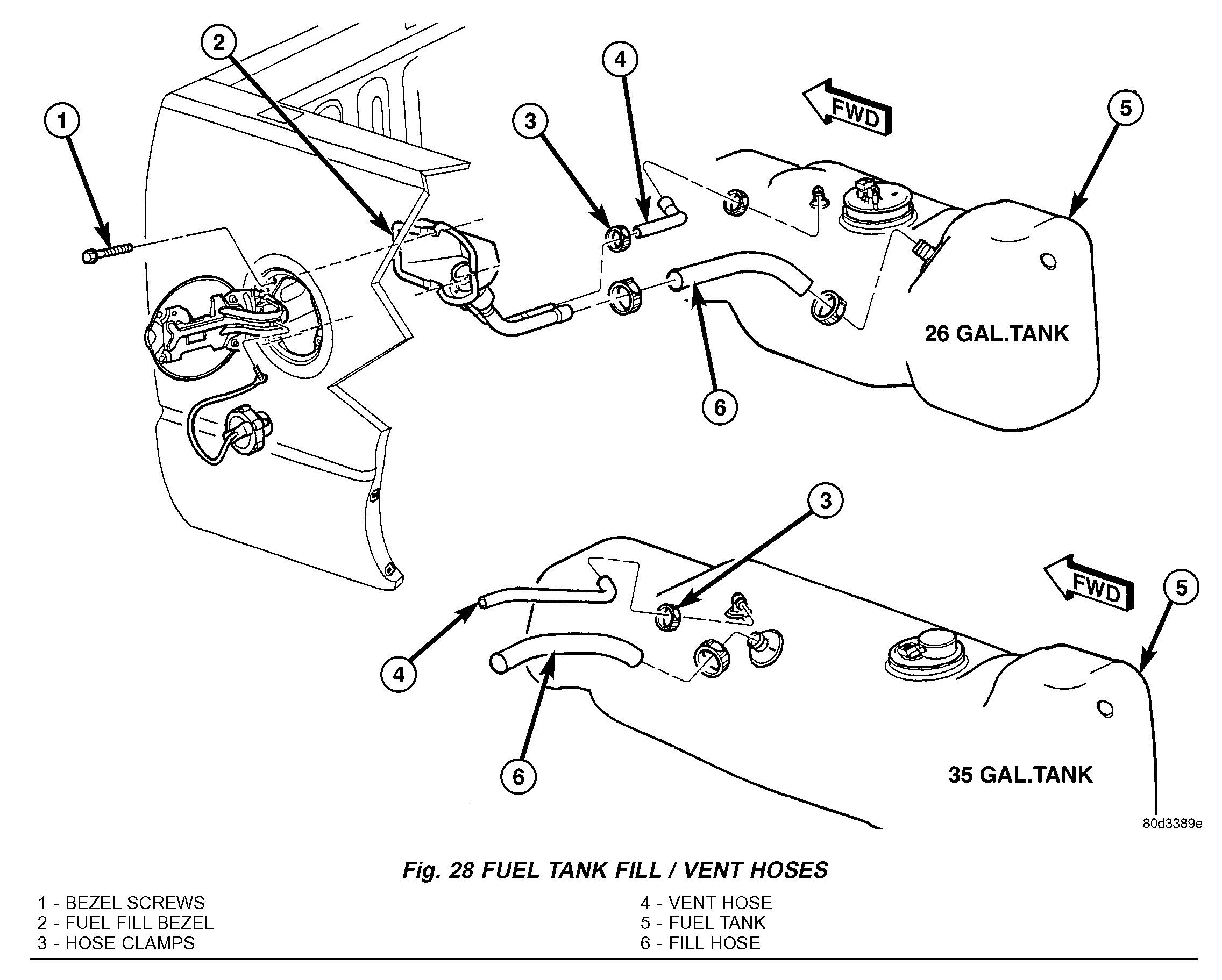

If you find the pump is bad, here are the directions for tank removal The attached pictures correlate with these directions.
Fuel Tank - REMOVAL
Fig.28 Fuel Tank Fill/Vent Hoses
1. Loosen clamp and disconnect rubber fuel vent hose (Fig. 28) at tank fitting.
2. Support tank with a hydraulic jack.

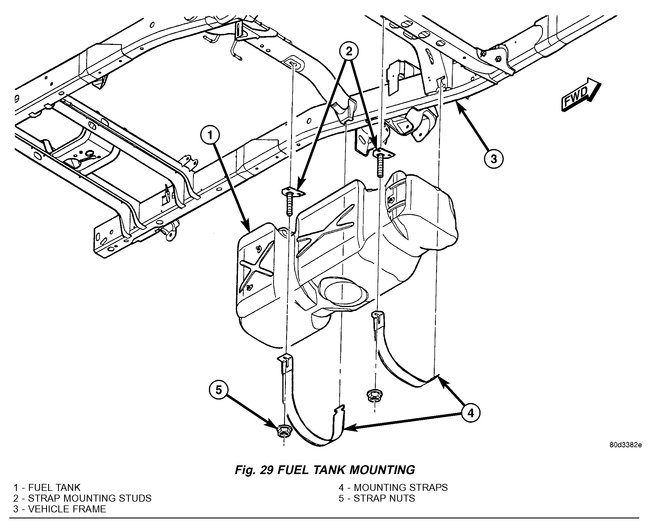

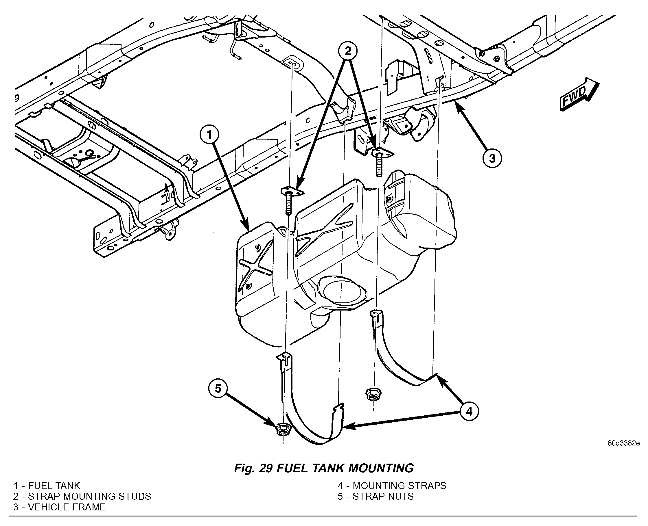

Fig.29 Fuel Tank Mounting
3. Remove 2 fuel tank strap nuts (Fig. 29) and remove both tank support straps.

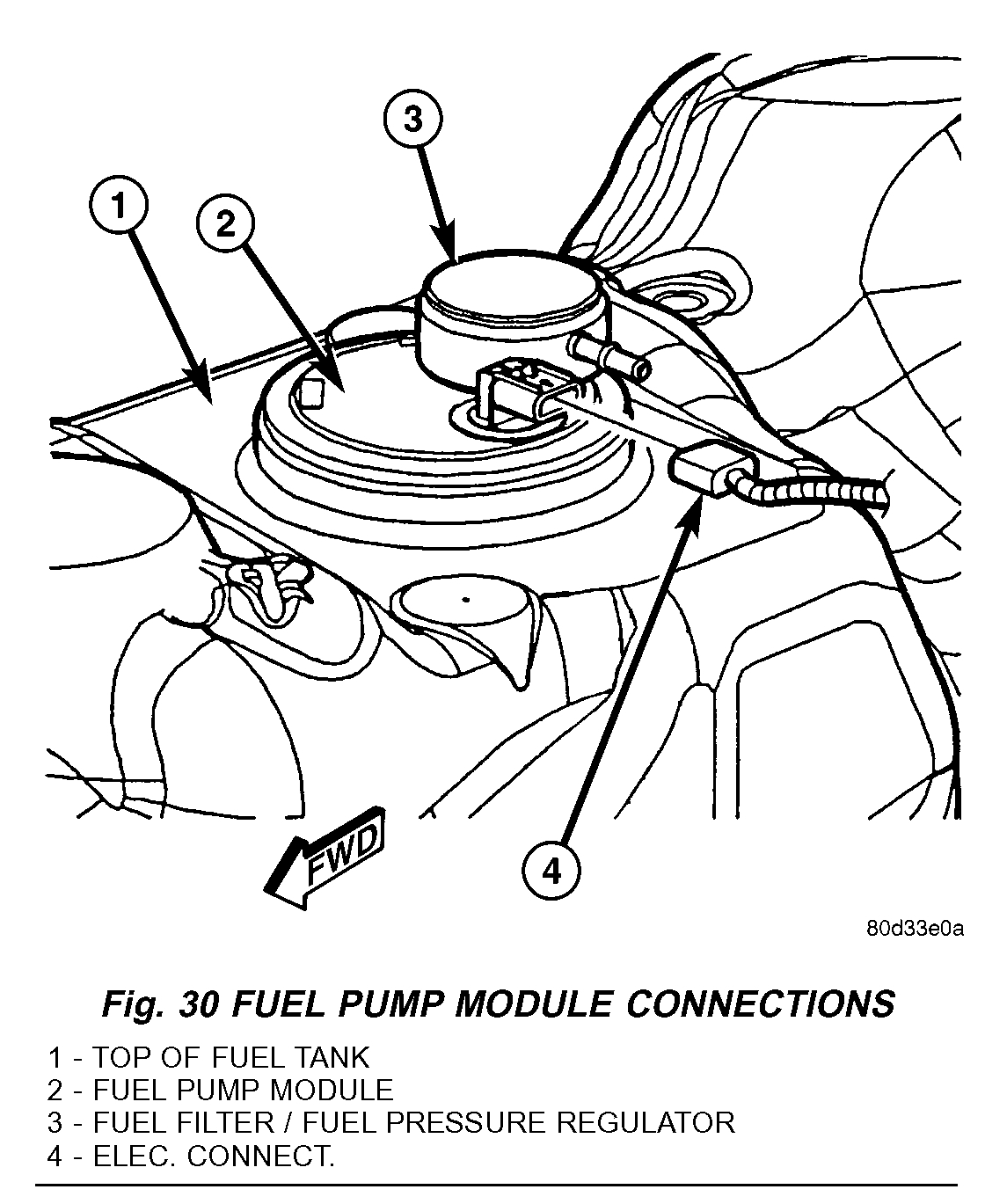

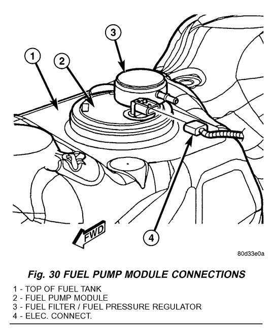

Fig.30 Fuel Pump Module Connections
4. Carefully lower tank a few inches and disconnect fuel pump module electrical connector (Fig. 30) at top of tank. To disconnect electrical connector: Push upward on red colored tab to unlock. Push on black colored tab while removing connector.
5. Disconnect fuel line at fuel filter I fuel pressure regulator (Fig. 30) by pressing on tabs at side of quick-connect fitting.

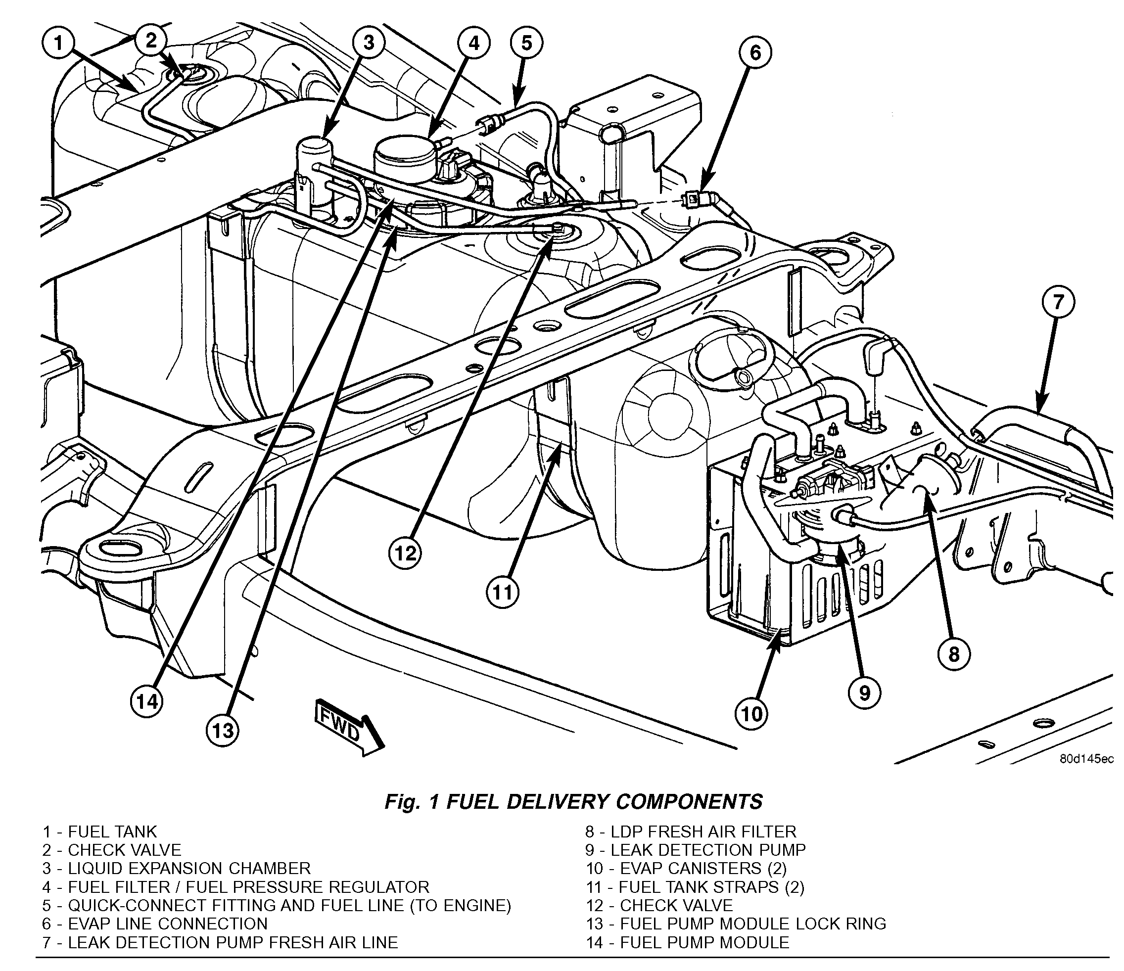

Fig.1 Fuel Delivery Components
6. Disconnect EVAP line at top of tank (Fig. 1).

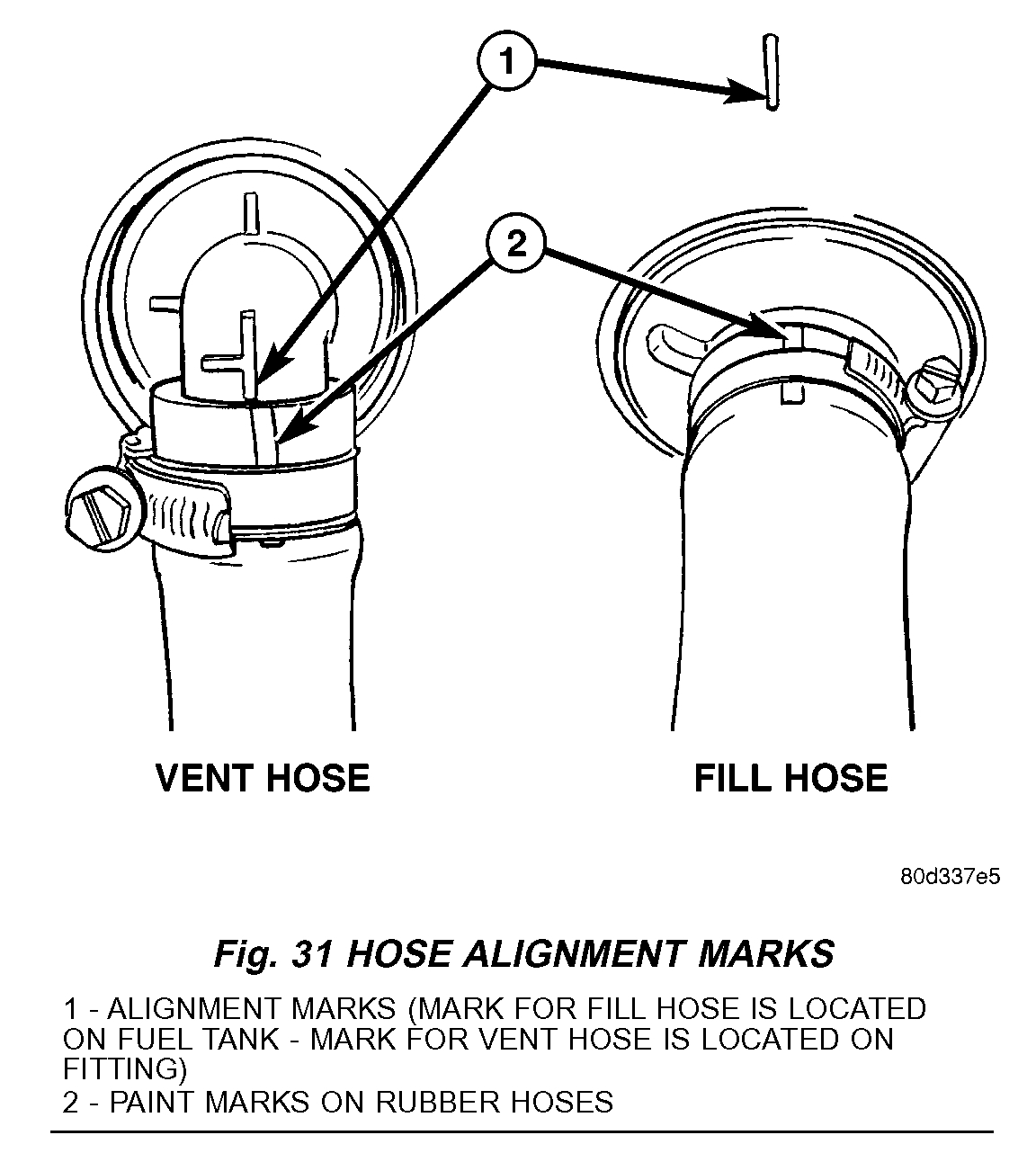

Fig.31 Hose Alignment Marks
2. Disconnect clamps and remove rubber fuel fill hose and fuel vent hose at fuel fill tube. Install these 2 hoses to 2 fuel tank fittings. Rotate hoses until paint marks on hoses line up with alignment marks (Fig. 31). Tighten both clamps.

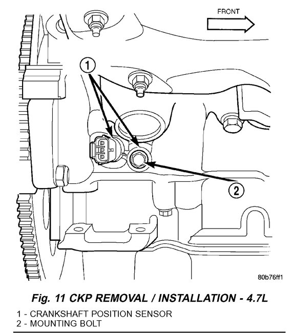

If you find there is no spark, here are the directions for replacing the sensor. If you have a live data scanner, check for an RPM reading while cranking in a no start situation. If there is no reading, chances are good the sensor is the problem. The last picture shows its location.
______________________________
REMOVAL
Fig.11 CKP Removal/Installation - 4.7L
The Crankshaft Position (CKP) sensor is located at the right-rear side of the engine cylinder block. It is positioned and bolted into a machined hole in the engine block.
1. Raise vehicle.
2. Disconnect CKP electrical connector at sensor.
3. Remove CKP mounting bolt.
4. Carefully twist sensor from cylinder block.
5. Remove sensor from vehicle.
6. Check condition of sensor O-ring.
INSTALLATION
1. Clean out machined hole in engine block.
2. Apply a small amount of engine oil to sensor O-ring.
3. Install sensor into engine block with a slight rocking and twisting action.
CAUTION: Before tightening sensor mounting bolt, be sure sensor is completely flush to cylinder block. If sensor is not flush, damage to sensor mounting tang may result.
4. Install mounting bolt and tighten to 28 Nm (21 ft.lbs.) torque.
5. Connect electrical connector to sensor.
