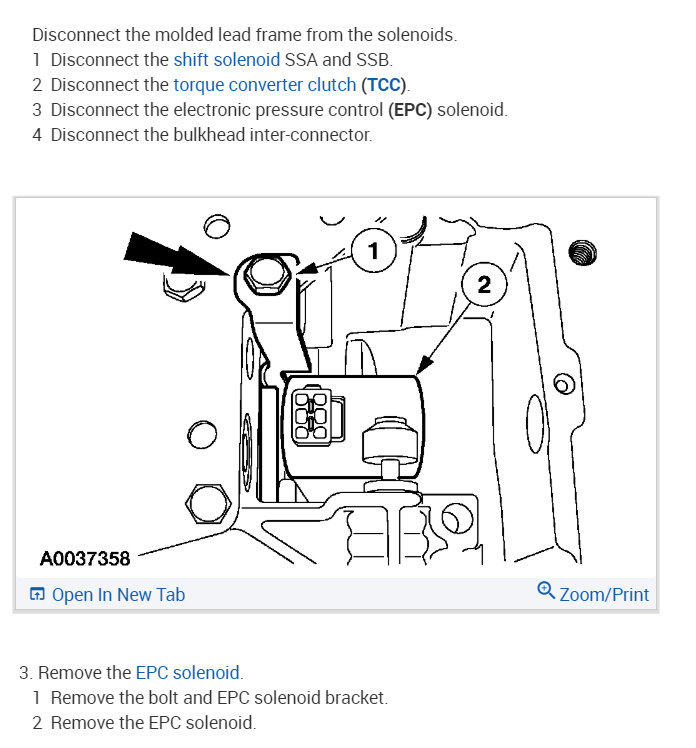

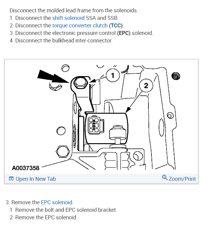

SAVANNAHSULWER
  • 5 POSTS
  • 2005 FORD CROWN VICTORIA
  • 4.6L
  • V8
  • 2WD
  • 140,000 MILES
It started with loosing 4th and feeling as though in neutral so I turned off overdrive and was able to catch the lower gears and limp home going 40-50 without it reving to much. But whenever overdrive is on it goes into neutral over 25 mph unless O/D is off I can go faster but I know it can't be good. Just bought this car. 2 for 2 with both vehicles we bought hoping for a vehicle with a little bigger engine that could make it up the mountains with ease. Fluid smells spent. I want to change it but don't know if its pointless and I'll need to change the transmission. 14 qts is a lot of wasted mercon transfluid plus filter, but if it could fix it that would be great because I know transmissions shift with pressure changes or something and with spent fluid that may be it. I'm thinking the upper solenoids could be bad or gummed up but I don't know anything about transmissions (yet) thanks
We're stuck at my moms until we can get one of these fixed and can't afford a shop but have enough tools to drop and take the transmission apart or swap, but figure it could be something simpler. Thanks thanks thanks
Saturday, August 8th, 2020 AT 12:38 PM (Merged)

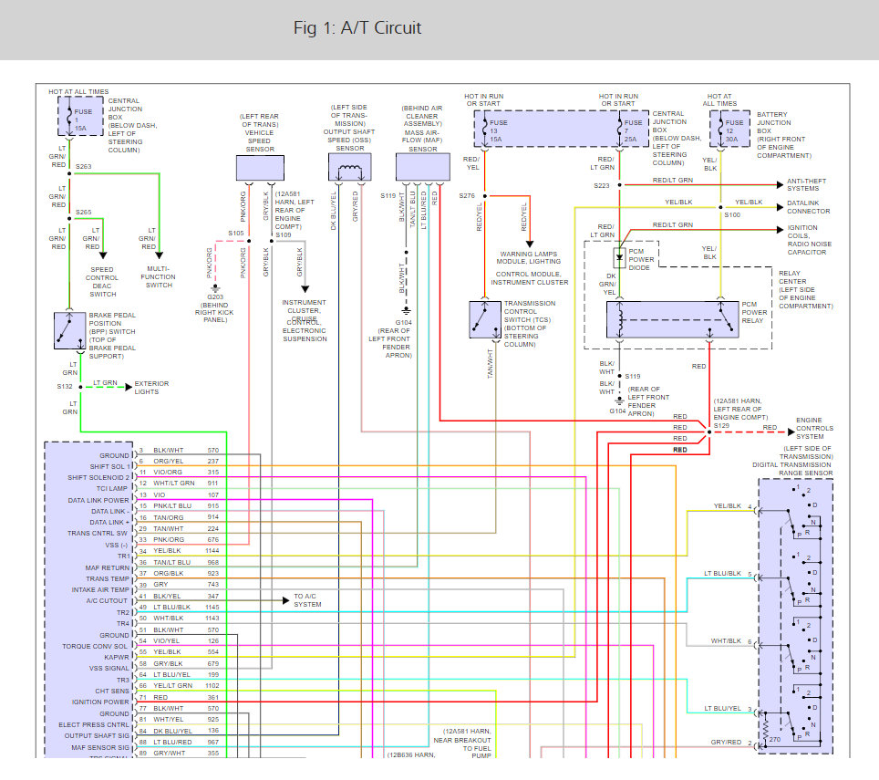

HMAC300
  • 48,601 POSTS

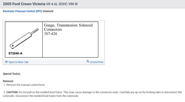

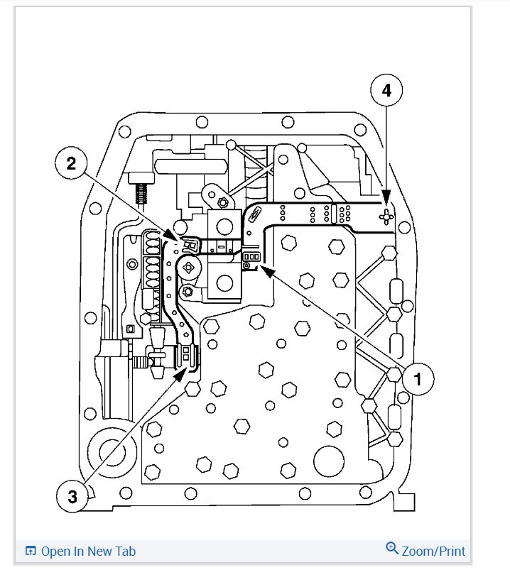

It's probably the pressure regulator solenoid here is the instructions on how to change it ti the diagrams below. Check out the diagrams (Below). Please let us know what happens.

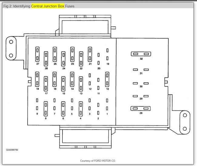

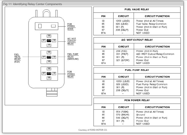

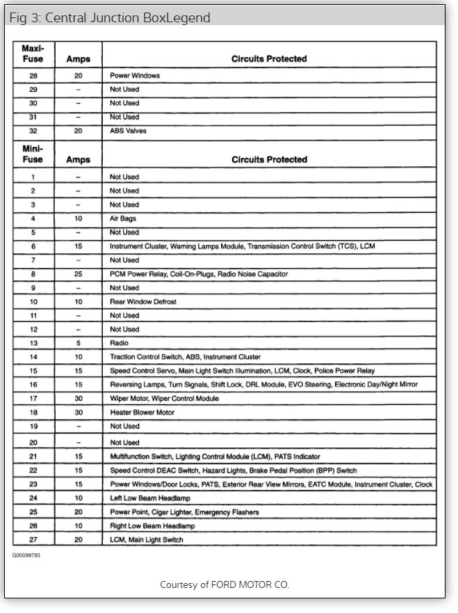

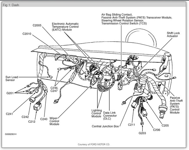

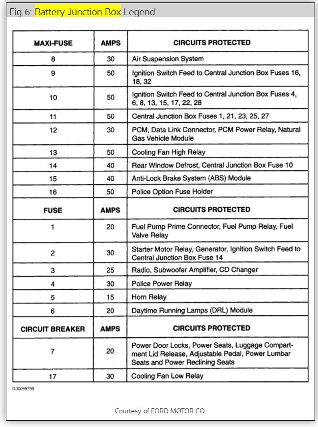

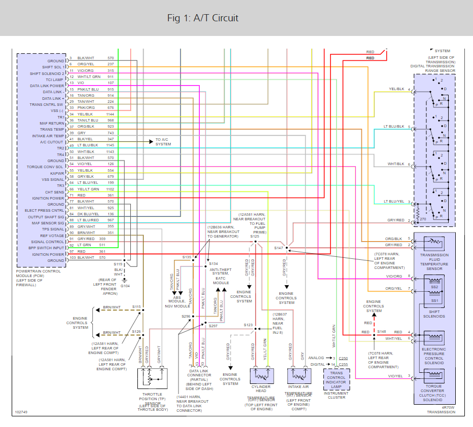

LILCEL2007
  • FORD CROWN VICTORIA
Ok I have a 1999 ford crown victoria police interceptor V8 with 115562 miles on it and when I drive it it shifts into 1st and 2nd gear with ez but it just wont shift into 3rd gear im trying to find out whats wrong because the shop wants 2 take the cars transmission apart 2 look for the problem and they also said it could need a trans cable adjustment or it could be a sensor can u guys help me out please because im just about to sell this car thank you
KEN L
  • MASTER CERTIFIED MECHANIC
  • 55,499 POSTS

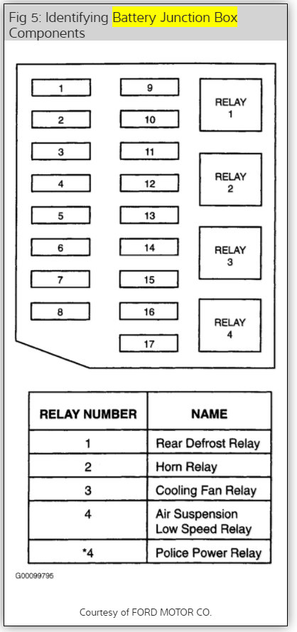

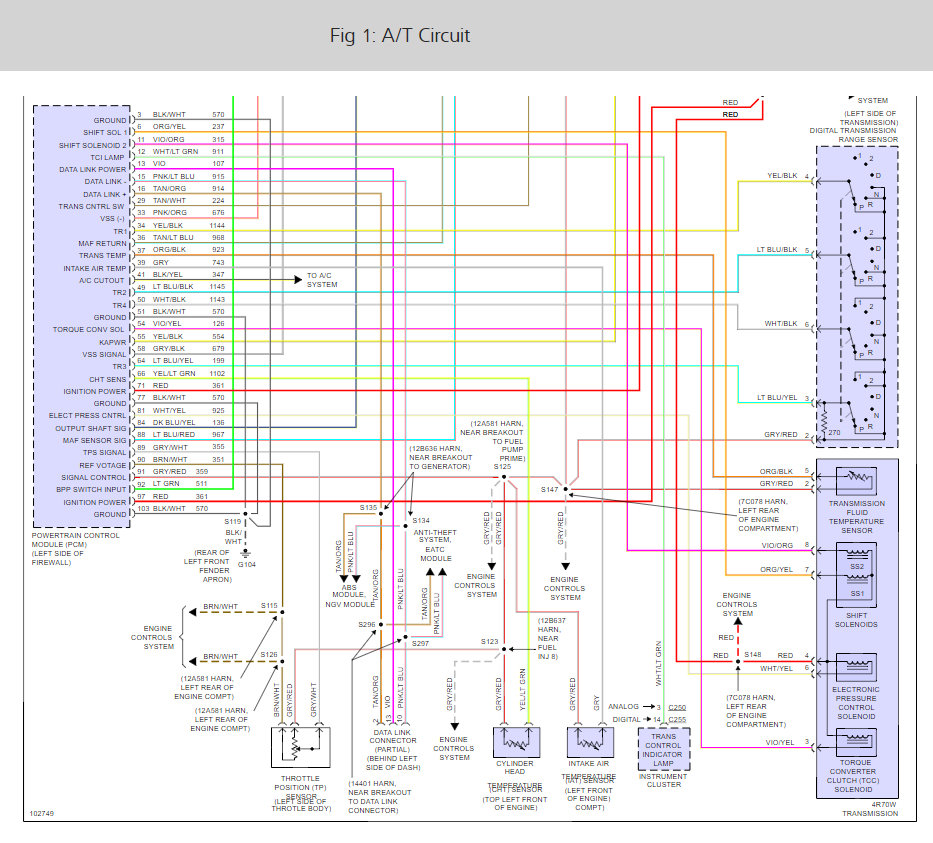

There are three fuses that run the system I would check those first. Here is a guide and the transmission wiring diagrams so you can see which ones to check.
If they are okay the problem should be a shift solenoid or the pressure control solenoid.
You will need to drop the pan to change them out here is a guide that will show you what you are in for when doing the job.
+1
