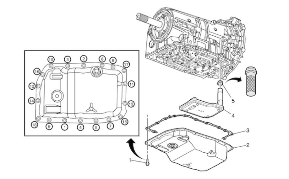

Well, when I put it in reverse it's like I have to give it a little more gas than usual to get it to start backing up. Like I can feel it catch then it's fine and sometimes it does the same in drive as well.

I would change the fluid and filter. You may have a partially clogged screen in the pan.
Scan for codes as well

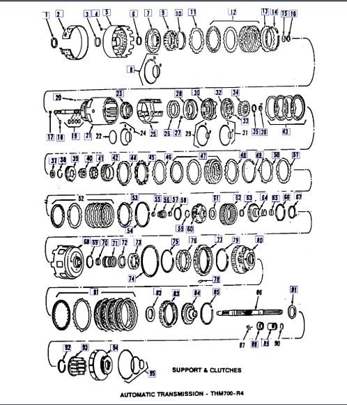

Check out the diagrams (Below). Let us know what happens and please upload pictures or videos of the problem.

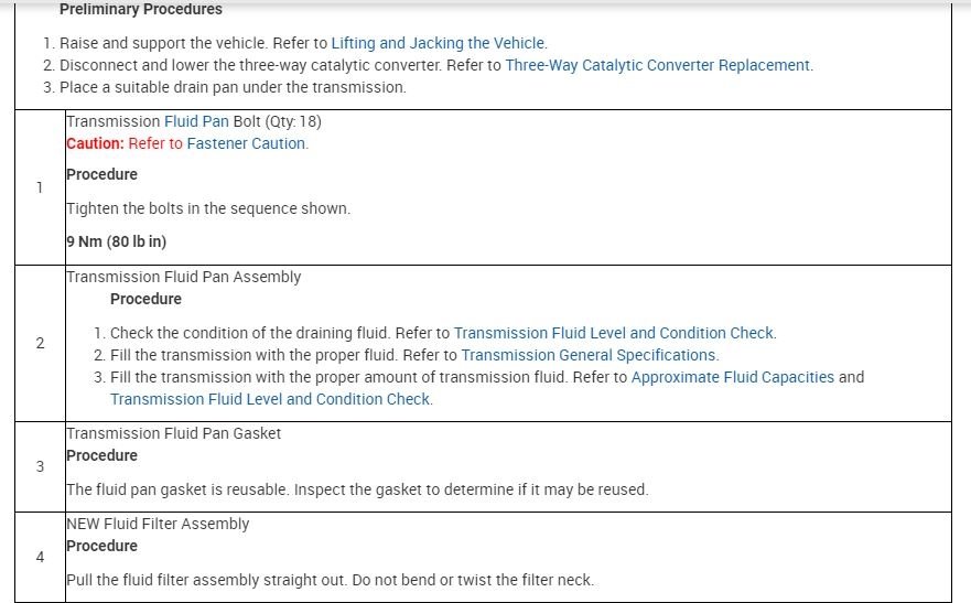

You can do this yourself. You will need to put it up on jack stands and get a large drain pan to drain the fluid.
Then release the pan and the filter will be inside. It just pulls down. The seal in the valve body will have to be changed as well.

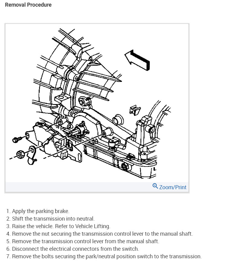

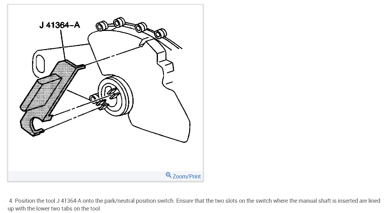

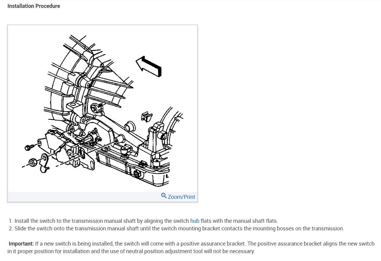

So the gear selector light are not lighting up? This is telling me the gear range sensor is out and needs to be replaced. here is a guide to help. This guide can help us fix it

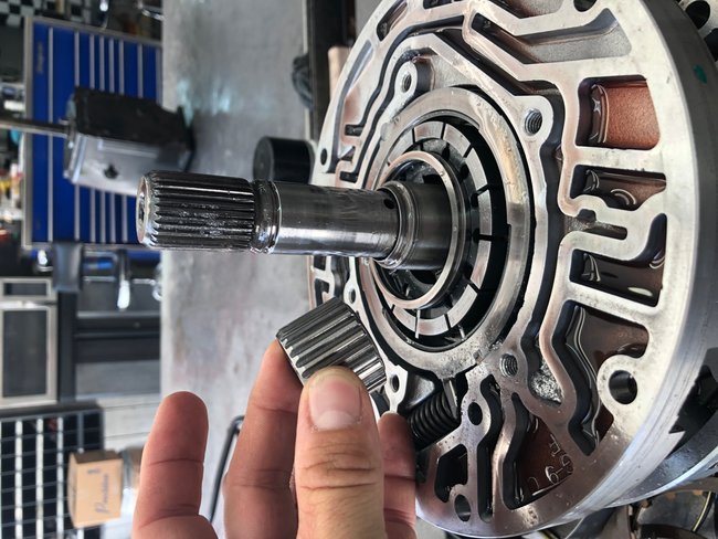

CHIP ATCHLEY
Well, I got under the truck and removed the trans pan. Thinking I would replace fluid/filter and see if there were any shavings in the pan.I checked the trany dip stick previously as did the tranny shop. Mentioned wift of a burnt smell but nothing they thought was too too bad. Anyway so I pulled the pan and it was full of silver stuff and the fluid was black and smelled worse than from dip stick. Evidently the car lot I bought it from had been dumping the stuff in there to keep it running. I had the truck 2 weeks before all this started. No warranty, "as is" and I regret it now. I took a chance and it did not pay off. Now my son is looking for a 1500 and we will approach it much differently. I drove my truck to tranny shop (in one gear) and dropped it off. I grew up with this guy, same guy who put computer on it and saw it was commanding to shift. So, 1850 plus tax and a new hayden 1679 cooler, truck is running great. He told me the pump stater was broken and killed the input drum. Not sure if stater is right because it was a text and he actually said "stated" so im assuming stater but looked like a gear. See Pic. Think the gunk the guy put in it caused the no code. And I think the pump gear/stator broke on way to his shop. Just under $2,200 in all. He put the corvette servo in it and upgraded sun gear. Basically whole new planitary, which is in the kit i guess. Im not a transmission guy so dont hold me to it. :)
May 6, 2021 at 10:13 AM (Merged)
  • 54,520 POSTS
Yep that will do it, broken stater good find on that. Glad you could get it fixed, that kind of problem can be tough. Please use 2CarPros anytime we are here to help.

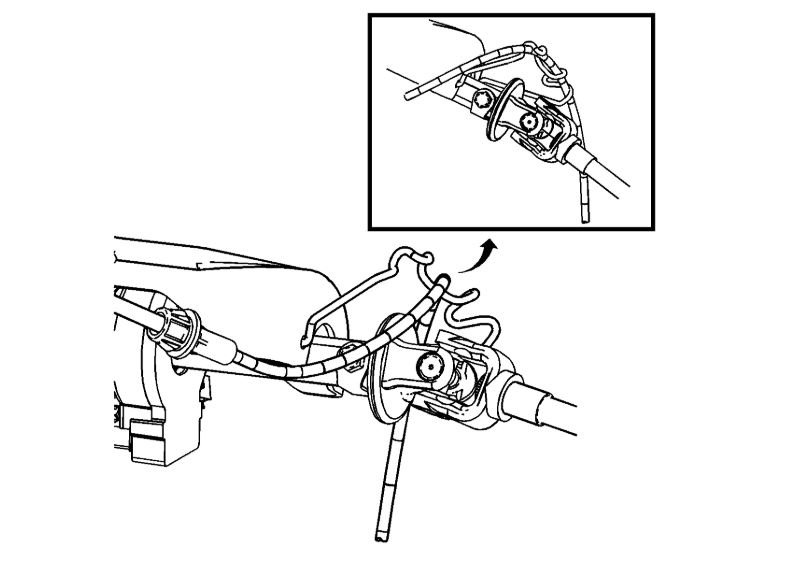

JLMEEK
My truck listed above will not go into gear. When I shift to reverse or drive it does not go into gear.

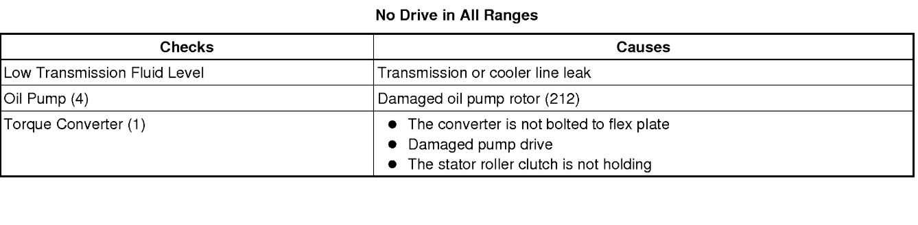

Good evening,
Did you verify the transmission level?
When was the last time you changed the fluid and filter? A clogged filter will do this.
Are there any codes set?
Since it is 4 wheel, does it go into any gear in any selection on the transfer case?

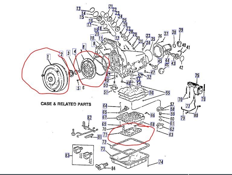

If all else is good, either the front pump or the torque converter has failed.

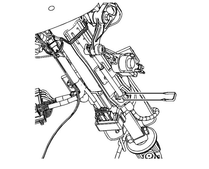

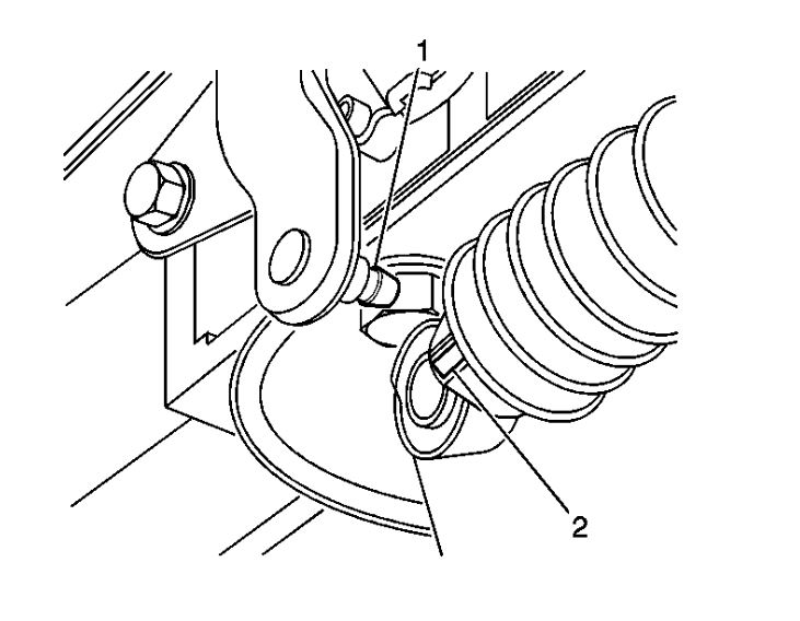

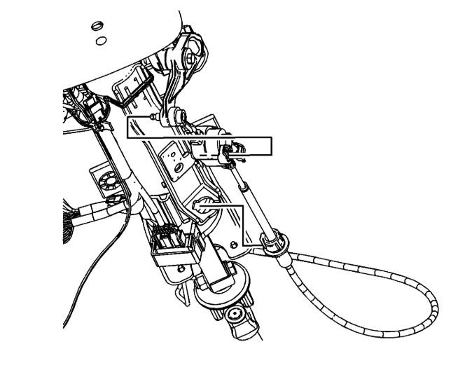

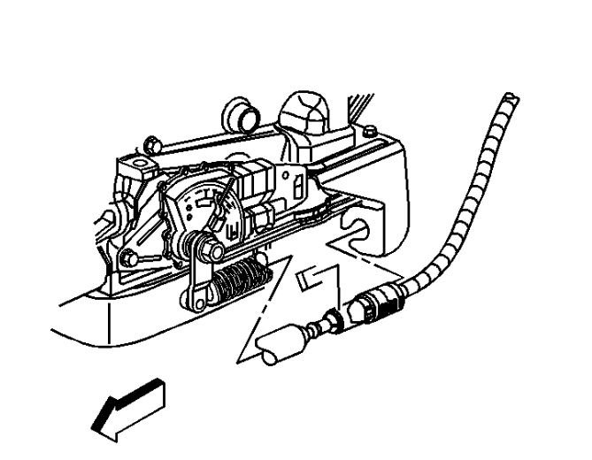

Do you mean the linkage is not moving at the transmission? That would indicate the cable has failed.
I attached the procedure for you and some pictures below for you.
3. Remove the clips on the cable from the floor panel reinforcement.
4. Ensure the transmission manual shaft is positioned in mechanical park.
5. Remove the retainer that secures the cable to the bracket.
6. Remove the cable clip on the transfer case, if equipped.
7. Remove the range selector cable end (2) from the transmission range selector lever ball stud (1).
8. Depress the tangs and remove the cable from the bracket.
9. Lower the vehicle.
10. Ensure that the steering column shift lever is still in the park position.
11. Remove the drivers seat. Refer to Front Seat Replacement - Bucket .
12. Pull back the carpet and insulation around the driver's area.
13. Remove the instrument panel knee bolster. Refer to Knee Bolster Replacement (with RPO SLT) Knee Bolster Replacement (without RPO SLT) .
14. Remove the retainer securing the cable to the steering column.
15. Remove the cable end from the steering column ball stud.
16. Depress the tangs and remove the cable from the steering column bracket.
Important: Avoid unnecessary twisting/bending of the range selector cable when removing the cable from the support.
17. Remove the range selector cable from the support.
18. Remove the cable grommet from the floor panel.
19. Remove the cable from the vehicle.

Okay, it should be a nice red color. I would start there and change it a couple of times. When you change it you just drain the pan. you still have seven or eight quarts in the converter that does not come out.
That is why I would do it again after about 1,000 miles.

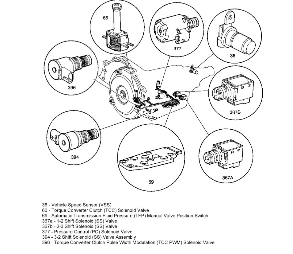

It sounds like the pressure control solenoid has gone out here is a diagrams showing the location and the removal. You we need to remove the transmission pan this guide can help.

With no gears, it could be either the filter is clogged, a torque converter failure or the front pump.

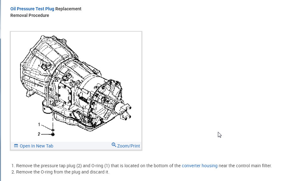

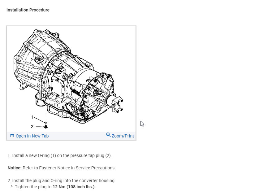

You are welcome. However, I just want to clarify that the pressure tap plug is for you to put a pressure gauge in it and test the pressure in the transmission. I highly suspect you have low or no pressure which is why your vehicle is not moving. Let me know if you have questions. Thanks
