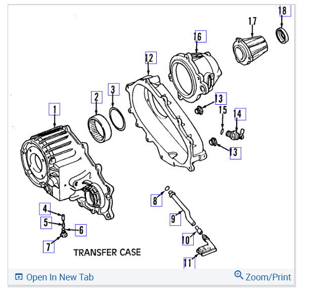

Any kind of grinding noise is not good and will not go away with time or a "break in" period. This tells me the transferase was maladjusted or not rebuilt correctly. The fact it was down on fluid is not good as well. I would take a sample of the fluid to see if there is metal in it, (small glitter like flakes) This will confirm the transmission case is having an issue. If you could upload a short video of the noise, I can tell for sure what's going on. You can upload it here with your response. Here is how to check the fluid condition by removing the fill plug, #13 on the diagram. Please upload an image of the fluid as well.

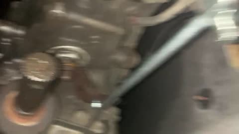

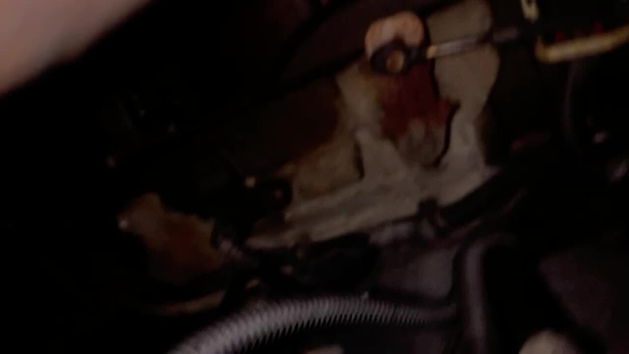

So, I dropped the front drive shaft which I thought was in a bind causing it to not engage into 4WD but apparently it is my T-Case not moving as it should. The shift lever is only going two positions even when the manual 4wd shifter in cab appears to be hitting them all. The attached video was taken while I had someone in the truck shifting through all 4 positions (mine is back to front 4H, 2H, N, 4L). That definitely does not look good.
Sunday, January 1st, 2023 AT 6:52 PM
JENNIFER GRAY
  • 8 POSTS
In the video my truck is running, transmission in N and brake pressed.

Thanks for the videos. I don't think the vacuum line will cause an issue, you are correct the transfer case does not seem like it is shifting, did you get a chance to spin the rear differential to rule that out? I am sorry this problem is keeping you up at night, please get some rest.

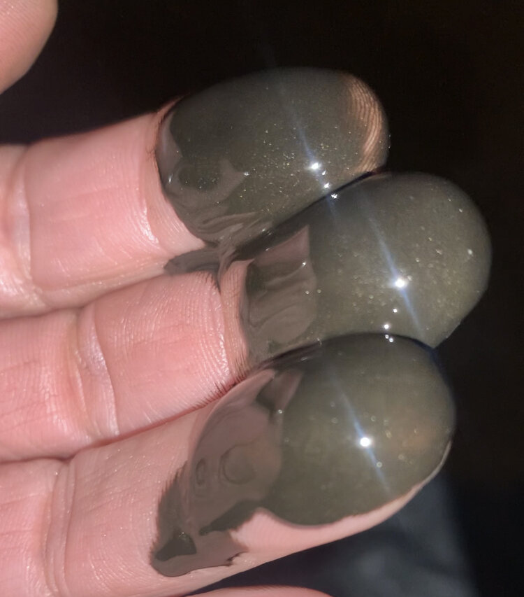

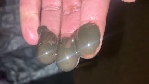

Well, I shouldn’t have spoken so soon, I’m now leaning towards the rear differential as well. After correctly checking the Transmission fluid no bubbles and levels looked perfect, so I decided to take a look at the rear drive shaft universal even though I just had it replaced. Universal is good so I figured while I was under, I’d check the gear oil level again and it is black as coal and sparkling which it definitely shouldn’t be a month after basically having it rebuilt. That was my first thought when I heard the howling starting up a couple weeks ago but the mechanic who rebuilt it keeps telling me it’s the T-Case or trans. To be fair I am still 350 miles from home so he hasn’t looked at it but he doesn’t even want to entertain the fact that it could be something wrong with the rear end that he just built. I’m no mechanic but even I know the gear oil in this pic that is barely a month old shouldn’t look like this. I’m assuming they didn’t balance the rear drive shaft maybe which is probably making the clunking I hear/feel when I let off the gas pedal quickly.
Tuesday, January 3rd, 2023 AT 3:27 PM
KEN L
  • MASTER CERTIFIED MECHANIC
  • 55,538 POSTS
Yep, that is bad, something went wrong inside the differential. I would forward the image to your mechanic to let him know.
