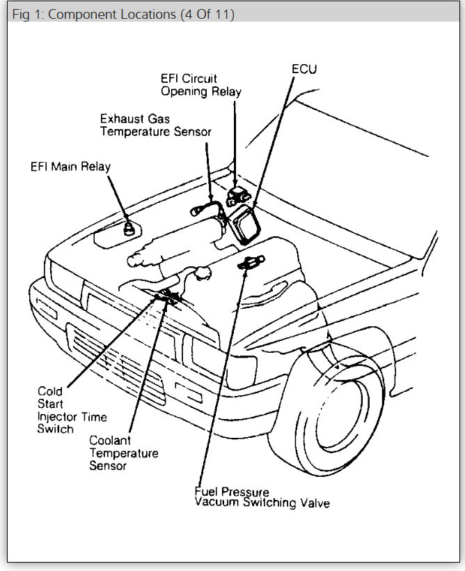

I turned off my truck went out thirty minutes later to leave. The truck would not start. My friend said it does not sound like the fuel pump is kicking on. I changed the fuel pump, filter. I am getting fuel to the fuel rail. Another friend told me it could be no spark. I changed the plugs, rotor button, cap, wires, coil. Still will not start. It will turn over but will not start. What else can I try?

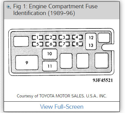

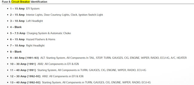

Hey Poppyjack,
It sounds like it is the EFI relay has let go which is common on these trucks. Here is a guide to help confirm the issue and the location of the relay in the diagrams below:
Check out the diagrams (below). Please run some tests and get back to us.
