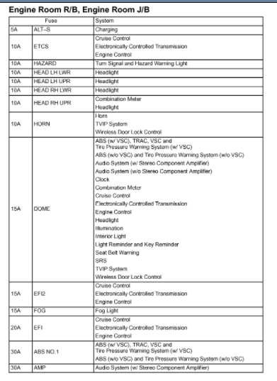

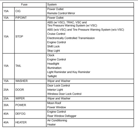

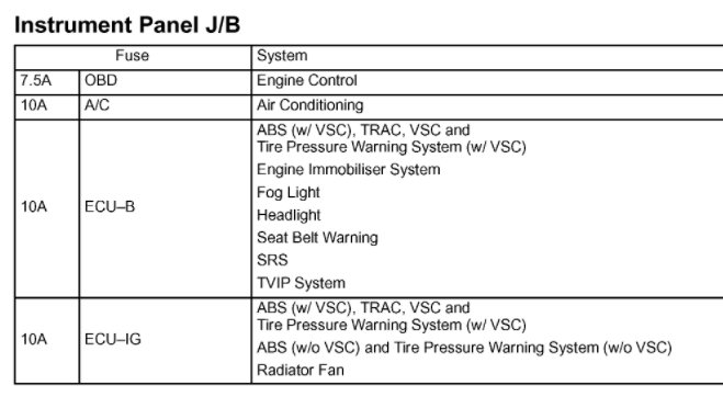

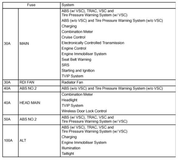

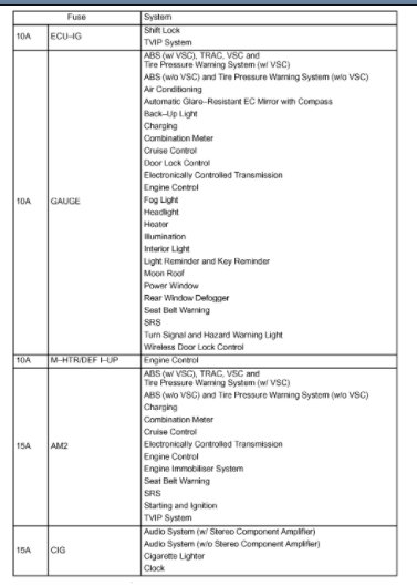

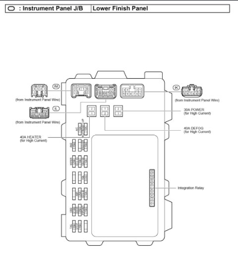

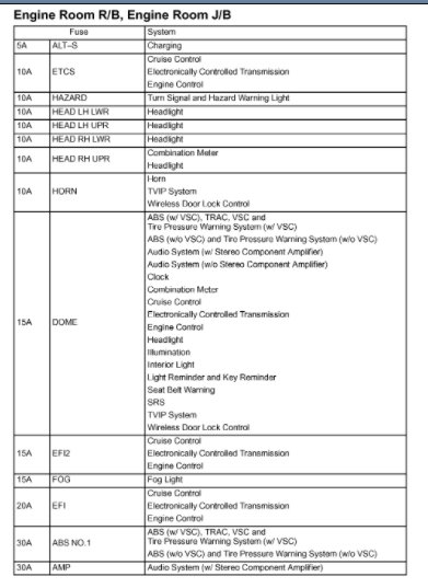

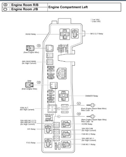

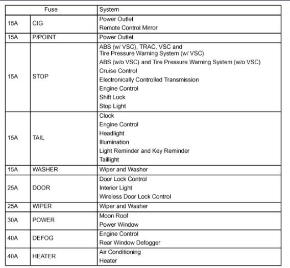

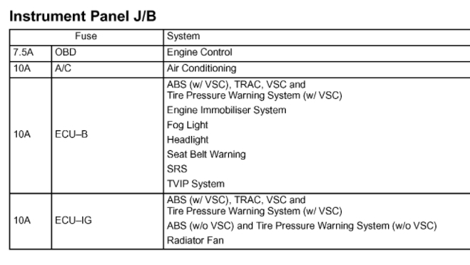

The cruise control is not working where are the fuses and how do you check them?
Wednesday, June 9th, 2010 AT 1:34 AM
DANNY L
MECHANIC
5,648 POSTS
Hello, I'm Danny.
Here is the information you requested. Here are a few tutorials for you to view on how to check and replace fuses:
I've attached pictures below showing the fuse and relay locations on your vehicle. Hope this helps and thanks for using 2CarPros.
