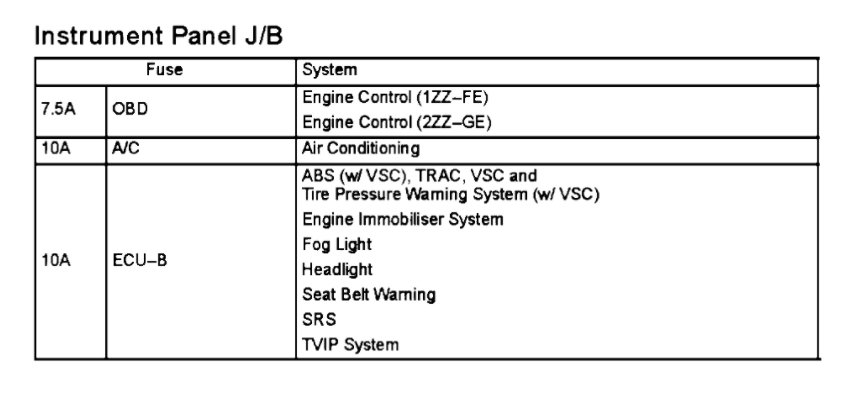

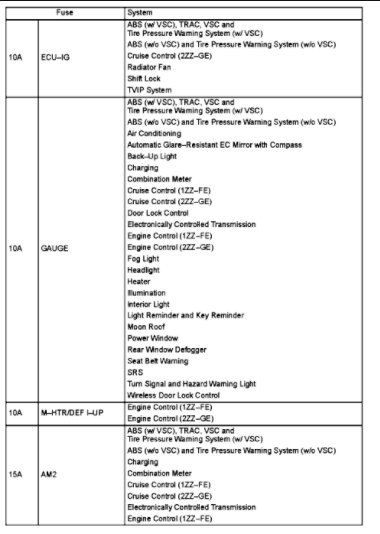

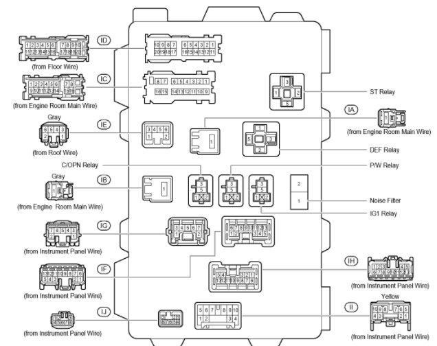

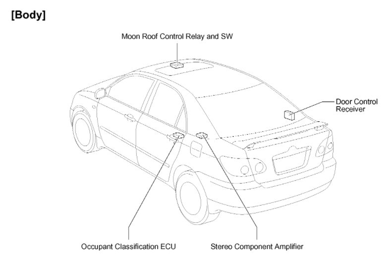

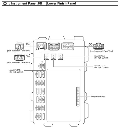

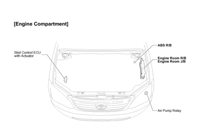

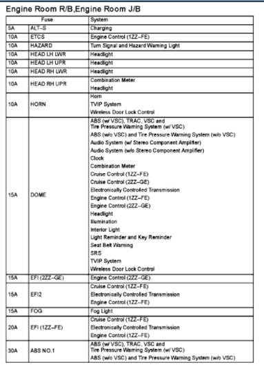

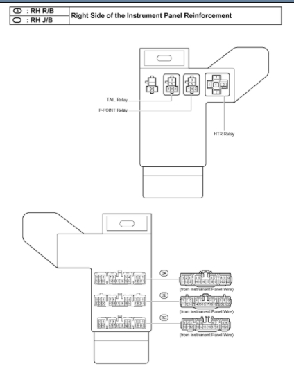

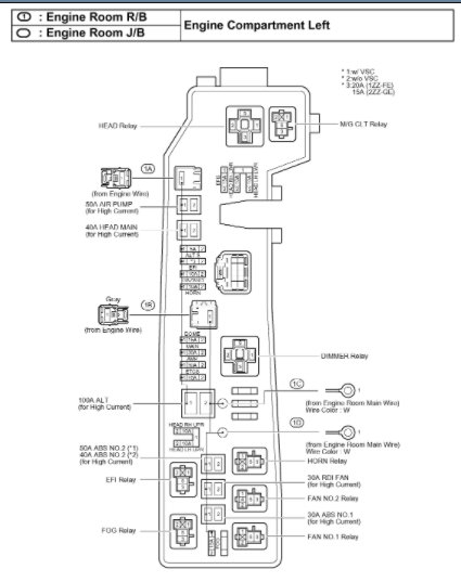

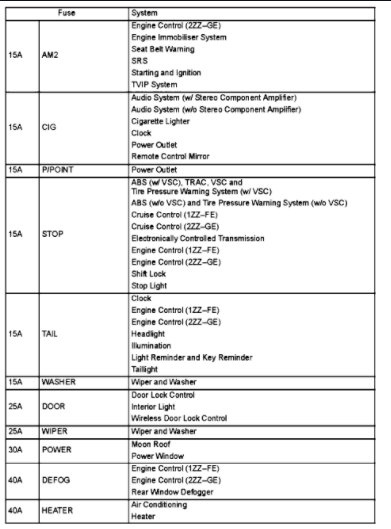

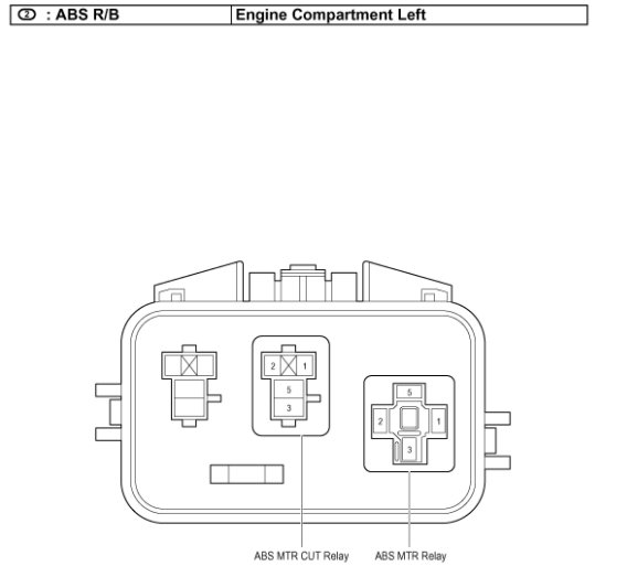

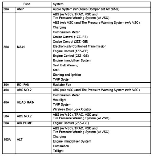

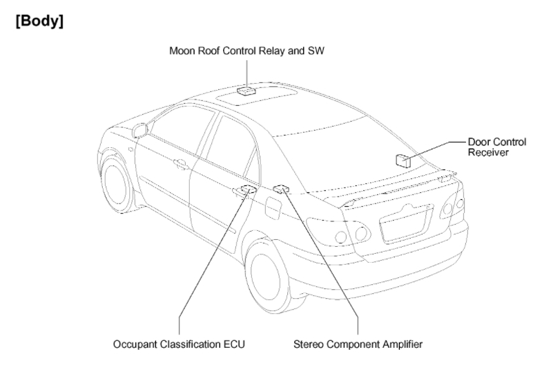

When I went to check the fuses I could not find them do you know where they are and how to check them? Please advise. Thanks
Tuesday, July 27th, 2010 AT 8:49 PM
DANNY L
MECHANIC
5,648 POSTS
Hello, I'm Danny.
Here is the information you requested. Here are a few tutorials for you to view on how to check and replace fuses:
I've attached pictures below showing the fuse and relay locations on your Toyota Corolla. Hope this helps and thanks for using 2CarPros.
