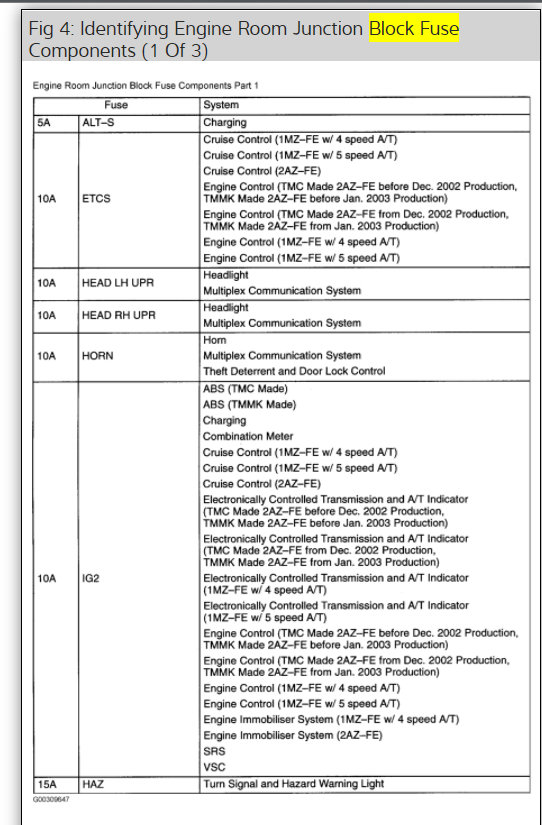

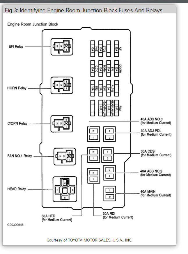

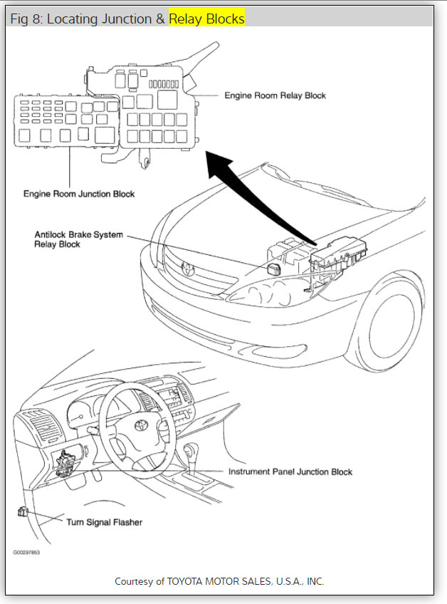

This sounds like the EFI relay is not working but to be sure here is a guide to help test it and the relay location as well in the diagrams below.

Yep the relay was bad, got a new one at the parts store $32.00 for a new unit and she runs again!
