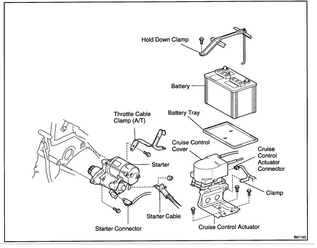

Sometimes when attempting to start, the starter will click as if the solenoid is energizing. The starter does not engage. Then I can put it in neutral and it will start. That stopped working. I can pull on the steering wheel and it will start. Just the other day I turned down the radio and it started. Different things seems to allow starting. Is it just coinsidence and I need a starter or do I have an electrical problem. Currently, nothing I do will allow starting.

Hi there,
I would be checking the starter first, have it removed and bench tested, and if OK start back tracking down the starting circuit to do your fault finding, start there.
Here are some guides that can help
and this will give you an idea of what you are in for when replacing the starter.
Diagram (BELOW)
Mark
