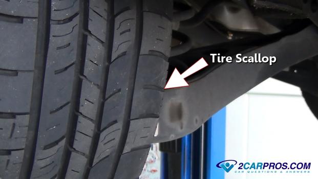

Step 1 - As the tires of the vehicle contact the ground the tire surface must be smooth for a quite ride. If the tires become cupped or scalloped due to improper balance or alignment they can produce a howling sound at various speeds.
tire scallop

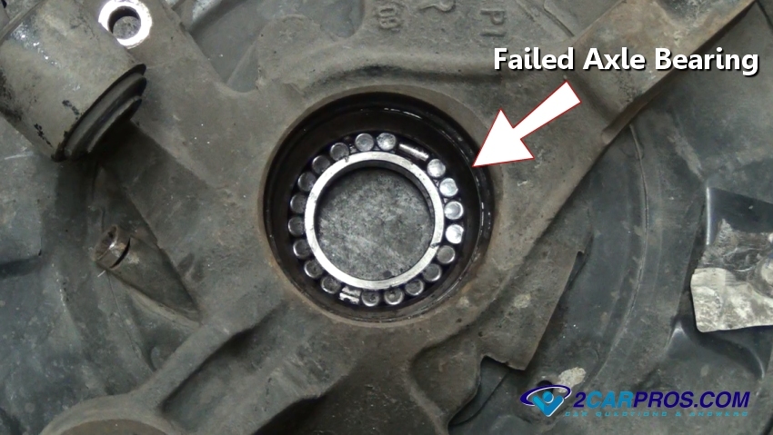

Step 2 - An axle bearing is designed to support the vehicle while in motion, when these bearings fail they can cause a howling sound which is sometimes more noticeable when the car is turning.
failed axle bearing

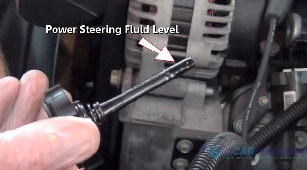

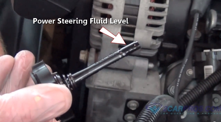

Step 3 - The power steering system will produce a howling noise when the fluid level has dropped and the pump is scavenging for fluid, remove the cap and check the fluid level.
power steering fluid level

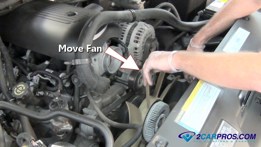

Step 5 - Automobiles equipped with a fan clutch (rear wheel drive) can experience a howling noise when the fan clutch has locked, to check for this problem start with the engine off, gently check the fan by pushing it in rotation, the fan should move freely, if not replacement is required.
move fan clutch

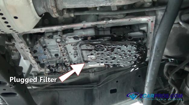

Step 6 - An automatic transmission can produce a howling noise when the filter has plugged or the fluid level is low.
plugged transmission fliter

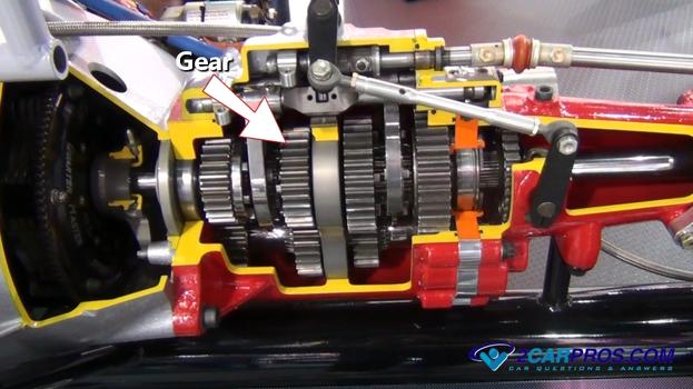

Step 7 - A standard transmission can make howling noises when a bearing or gear has worn and is failing.
transmission gear
