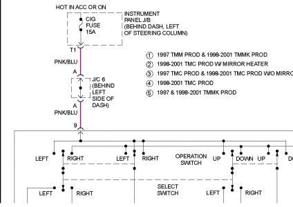

The other problem with this car is that the power control for adjusting the side mirrors does not work. Is there a fuse somewhere that needs to be replaced? In addition, the clock doesn’t work either. Maybe the same fuse? Baffled with these things. The manual doesn’t go into any detail regarding either if they are not working.

Check the cigarete lighter fuse in the driver's fuse block regarding the power mirrors.
https://www.2carpros.com/forum/automotive_pictures/30961_97toycam_1.jpg
