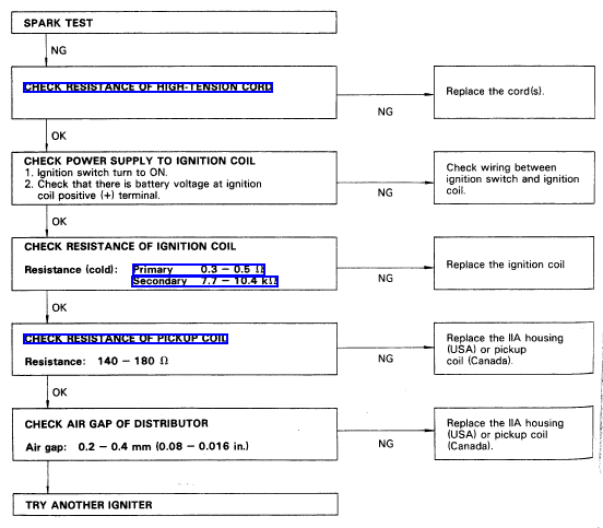

Check and test the coil, distributor pick-up coil and ignitor.

Check and test the Ne, G, Igt, Igf wiring back to the computer for short and open-if ok, replace the computer.

Disconnect a sparkplug wire or 2 and ground it to the engine -have helper crank engine over-do you have a snapping blue spark? If so-you have a fuel problem, check the fuel pressure to rule out the fuel filter/fuel pump/pressure regulator and listen to the injector/s are they pulsing or hook up a noid light. No snapping blue spark continue to troubleshoot the ignition system-power input to the coil/coil packs, distributor pick-up coil, ignition control module, cam and crank sensors- Note: If it doesn't apply disregard it

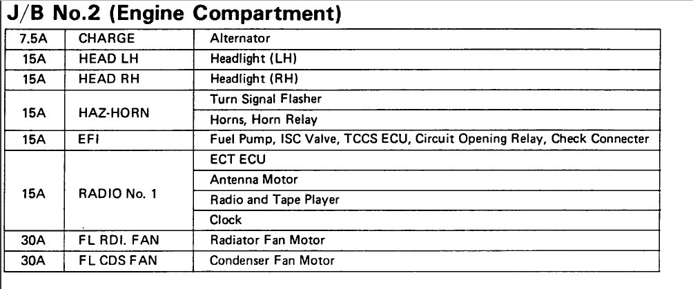

We have replaced the distributor and igniter switch. Also replaced battery. Car will crank but will not start. What else should we check?
Sunday, August 2nd, 2020 AT 11:24 AM (Merged)

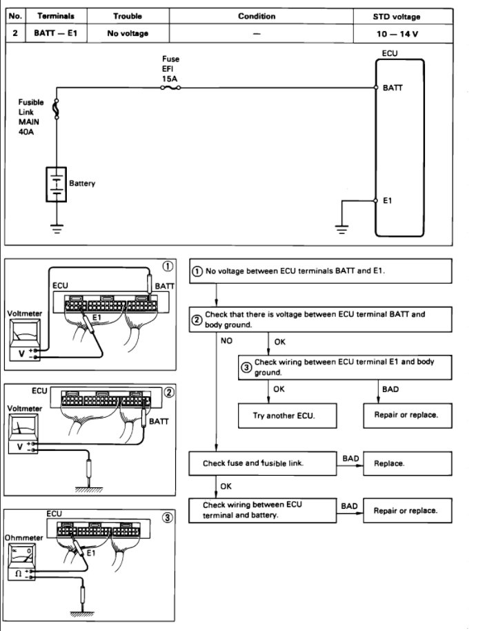

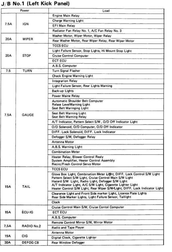

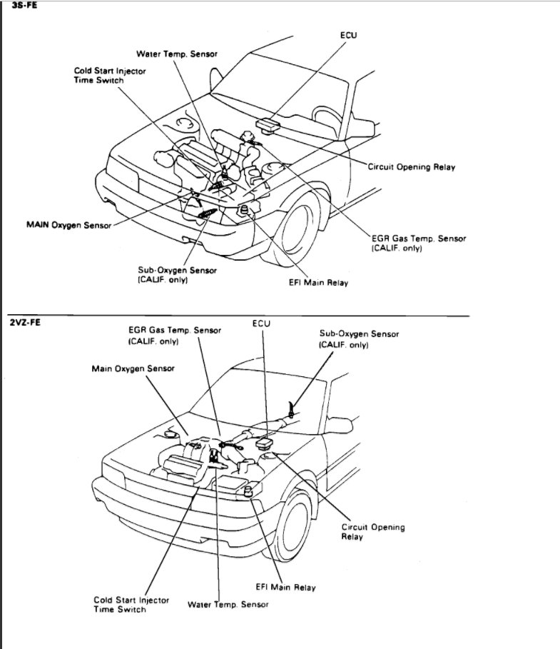

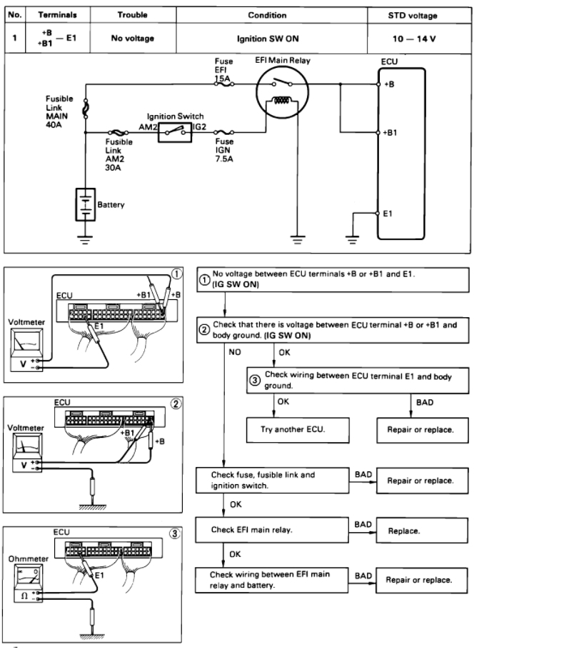

KEN L
  • MASTER CERTIFIED MECHANIC
  • 55,499 POSTS
It sounds like the system is not getting power which is supplied by the EFI relay.
Here is its location along with a couple guides on how to check it:
Also check the fuses.
+1

No snapping blue spark continue to troubleshoot the ignition system-power input to the coil/coil packs, coil's resistances, distributor pick-up coil, ignition control module, cam and crank sensors and computer Note: If it doesn't apply disregard it.
