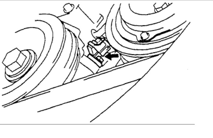

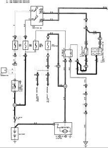

A few days ago I took a corner from my house and the car just died. I got the car back to the house and the first thing I did was spray starting fluid down the TBI (Throttle Body Unit) to see if the car would start. The car did not start. That led me to suspecting something on the ignition side was wrong. I then removed the secondary coil wire going to the distributor cap and held it close to the strut tower to try and "see" a blue spark, as my dad was "cranking" the car. No luck. I then proceeded to check the resistance readings on the ignition coil and got 0.8 ohms on the primary side and 13.68k ohm on the secondary side. While there I check voltage from the end of the coil wire to ground, and also check the primary voltage to ground. Both read 12.41 volts. I then got my OBD-II tool and pulled codes P0401 and P0110. One code was the EGR valve and the other was the IAC (Intake Ambient Sensor). No other codes. I went on the safe side and removed the igniter and took it to AutoZone where it was tested several times using their Wells tester. All tests came back "PASSED". Thinking that something was not allowing the "coil" to collapse to induce a spark I check the CSS (Crankshaft Sensor). With the car cold it read 1348 ohms. I went to AutoZone and checked three of their CSS's and all read between 1340-1368 ohms. So, looking at a diagram from the Haynes manual I noticed that the Pick-up coil could possible cause this problem. So, I check the ohms on this and got 168 ohms. Doing some additional research some individuals have mentioned the IGf and IGt from the ECM. I do not know what else to check. I put new plugs, wires, distributor cap and rotor on a month ago. Is the coil bad? Why is there no spark with everything reading correct? Suggestions are welcomed.
Aug 25, 2015 at 5:05 PM
SATURNTECH9
  • 30,869 POSTS

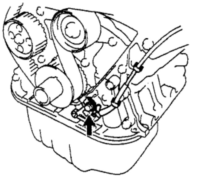

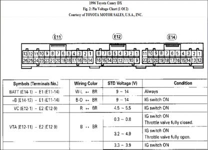

Testing a crankshaft sensor that way wont always work because everything changes when the sensor is in operation. It does sound like it is out though. Here is a guide that will show you what you are in for when changing it out with some diagrams (below) on how it will be like on your car.
Next, with the key in the run position you should have battery power to the white wire with a red stripe at your coil.Also black wire with a red stripe should have a pulsing ground while cranking the engine?Check for the pulsing ground with a test light that will check your coil inputs to see if the coil is getting what it needs.
Here is a generic guide as well
Please let us know what happens so it will help others.
Cheers
Aug 25, 2015 at 7:23 PM
LEINADLTD
  • 15 POSTS
Sorry it took so long to get back to you. I used a 12 volt test light and found that the light remain solid on both the white / red wire with the key "on", and while cranking the black with red stripe wire also remained solid. There was no Flicker or pulsating on the black / red wire. This might have been due to my LED test light. What does this mean? I only have two wires coming out of my distributor for my pickup coil. What is the next step? Ok just tested the same black / red wire using a 12 volt light bulb. The bulb did not pulsate, however it did dim when the car was cranking.
Aug 27, 2015 at 9:59 AM
SATURNTECH9
  • 30,869 POSTS

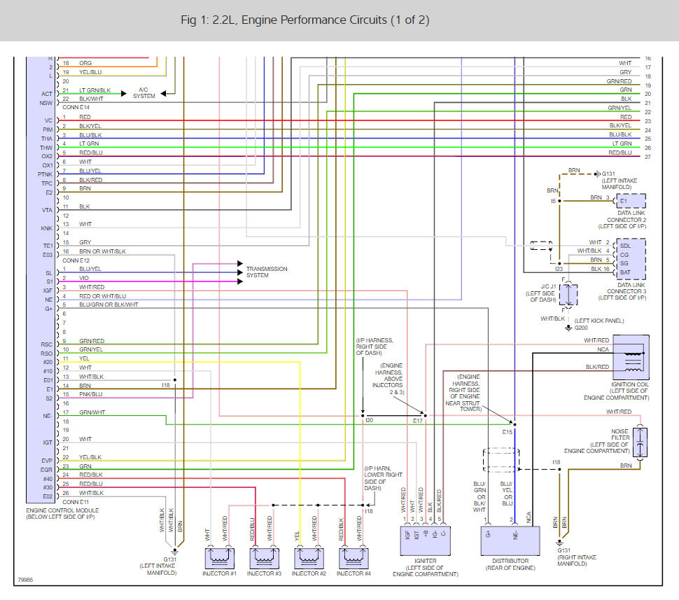

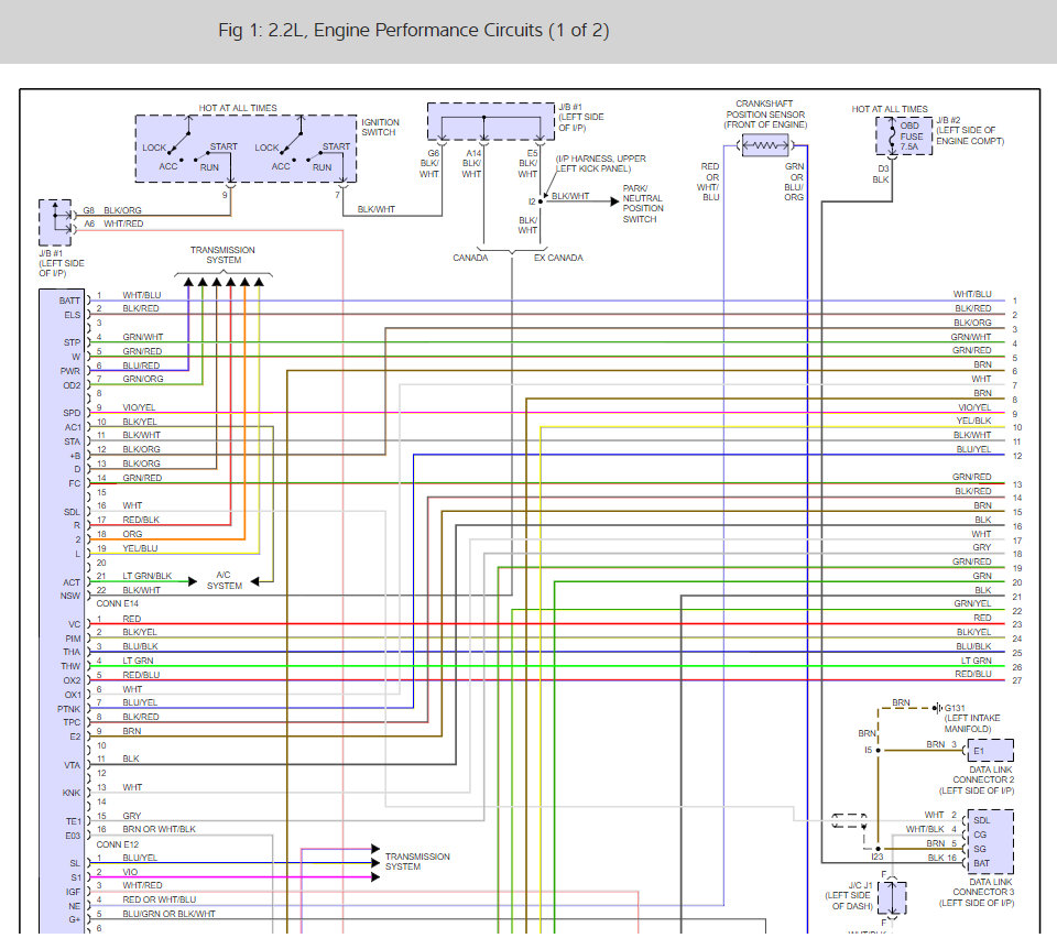

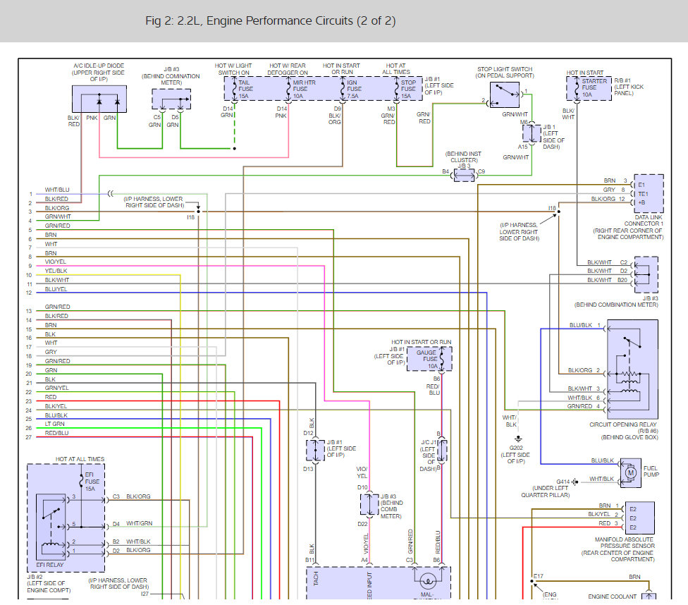

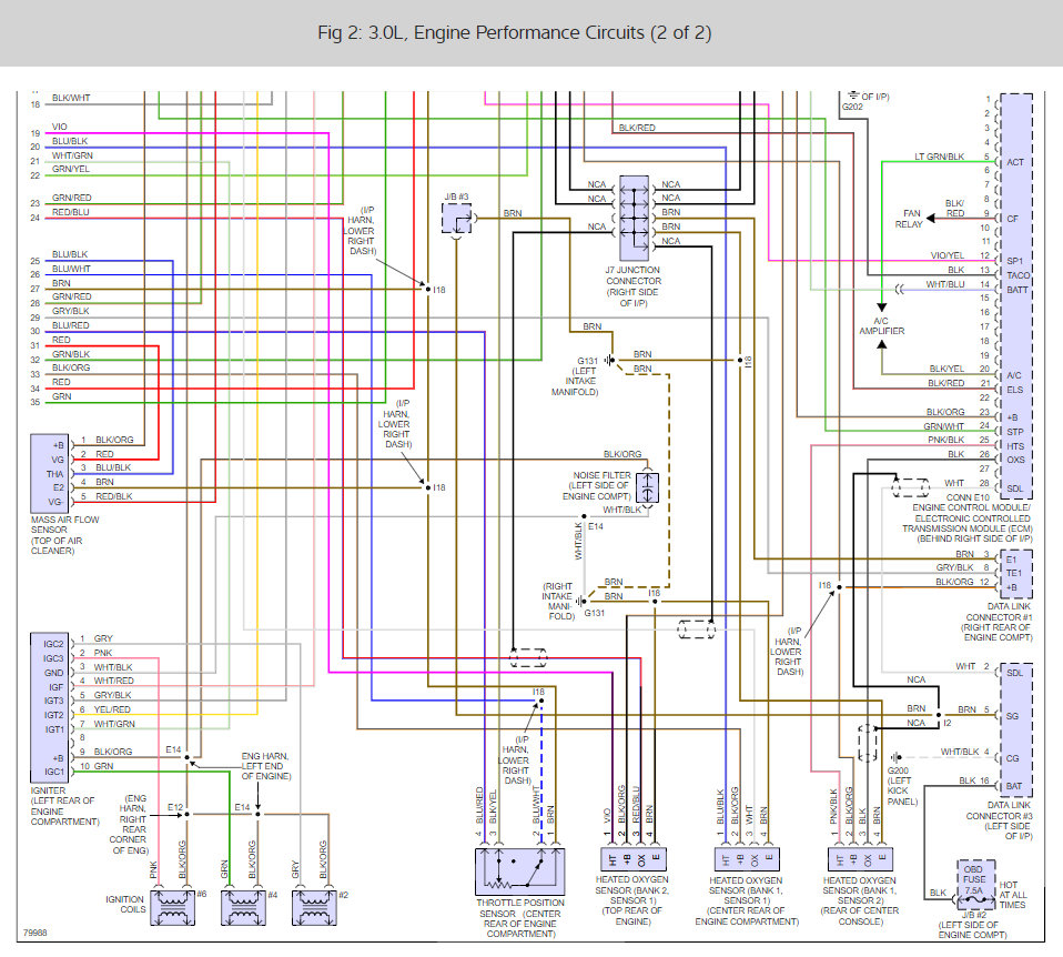

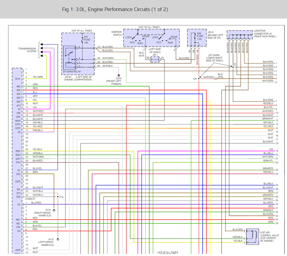

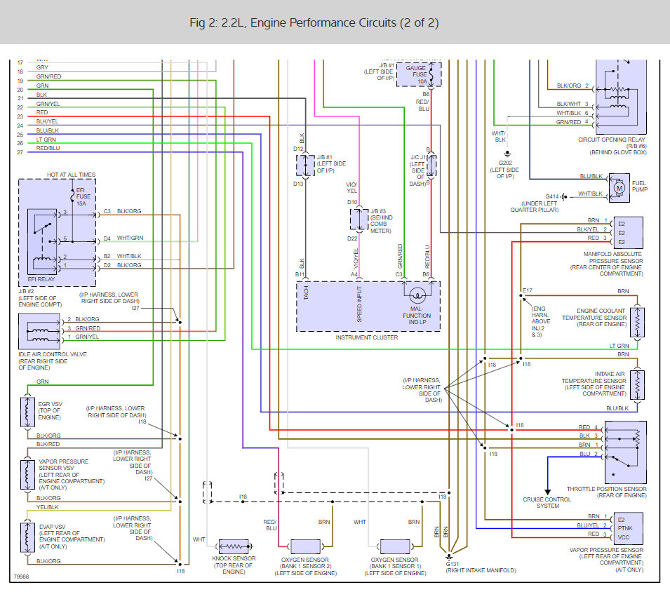

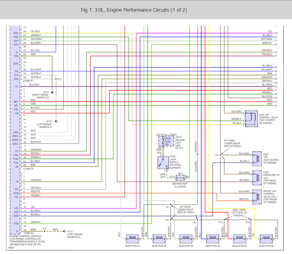

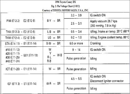

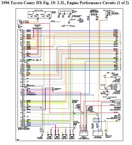

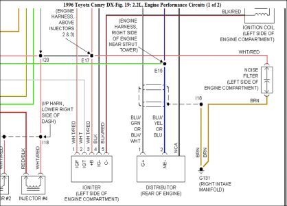

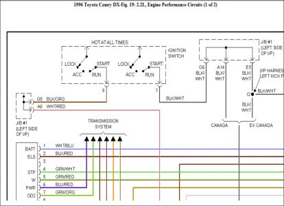

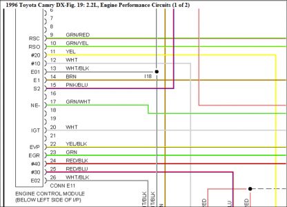

So there are two wire inputs into the coil?If so one is a constant power and the other is a pulsing ground while cranking that is what causes the coil to spark . also with the distributor cap off and cranking the engine the rotor on the distributor spins while the engine is cranking?
Here is a guide and some ignition system wiring diagrams to help with the testing.
I gave both 4 and 6 cylinders just in case.
Cheers,
Aug 27, 2015 at 12:20 PM
LEINADLTD
  • 15 POSTS
Yes, the white / red wire has 12 volts on it. The black / red wire also has 12 volts and when you crank the car the test light does not pulse. We did this to make sure the timing belt was not broke. Its like the ignition coil is not collapsing to send the spark energy to the spark plugs. How can you check the pickup coil to see if the timing events are happening in order to make and break the ground on the ignition coil in order to induce a spark on the secondary side, so that spark energy is sent to the spark plugs? Remember, the igniter was tested at autozone on their wells tester and show to be good several times. What would you like me to check next?
Aug 27, 2015 at 3:02 PM
SATURNTECH9
  • 30,869 POSTS

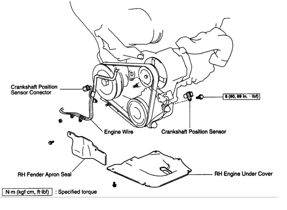

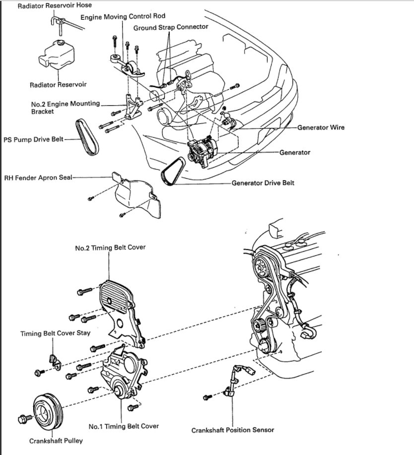

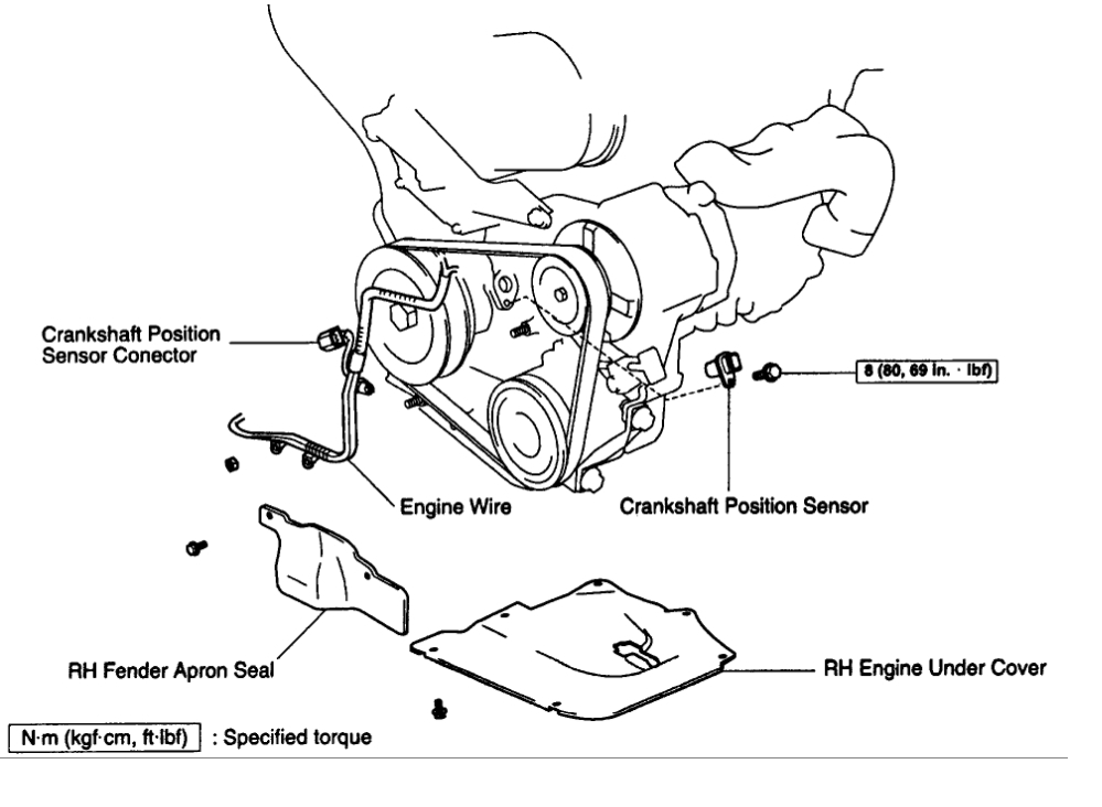

It sure sounds like the crankshaft angle sensor is bad. I would try replacing it they go bad all of the time.
Here is a the Denso sensor on Amazon for $53.00

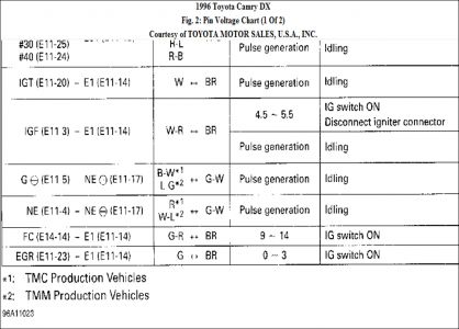

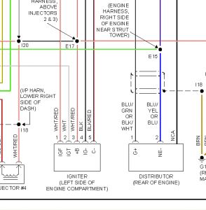

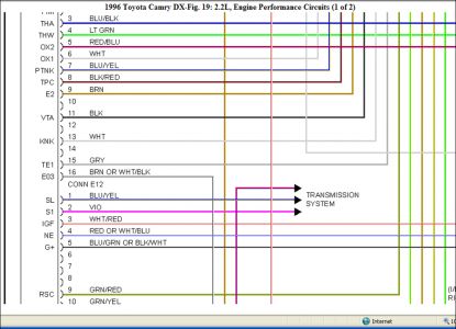

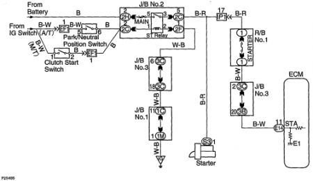

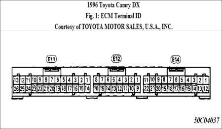

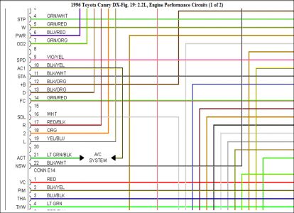

OK, what you have proven is that you are lacking pulse for both ignition and injector. That is determined by the reference signal supplied by the Crank sensor. That is where I would concentrate. It can be the sensor or any related wiring or even the ECM. Here is a quick test for the sensor. CRANKSHAFT POSITION SENSOR INSPECTION NOTICE: "Cold" and "Hot" in the following sentences express the temperature of the sensor itself. "Cold" is from -10°C (14°F) to 50 °C (122°F). "Hot" is from 50°C (122°F) to 100°C (212 °F). DISCONNECT CRANKSHAFT POSITION SENSOR CONNECTOR FROM GENERATOR DRIVE BELT ADJUSTING BAR INSPECT CRANKSHAFT POSITION SENSOR RESISTANCE https://www.2carpros.com/images/external/79036105.jpg.gif Using an ohmmeter, measure the resistance between terminals. Resistance: Cold: 985 - 1,600 Ohms Hot: 1,265 - 1,890 Ohms If the resistance is not as specified, replace the crankshaft position sensor. RECONNECT CRANKSHAFT POSITION SENSOR CONNECTOR
Sep 6, 2015 at 12:00 PM
WRENCHTECH
  • 20,761 POSTS
Check out the wiring diagrams in this post a few answers up
Sep 6, 2015 at 12:37 PM
LEINADLTD
  • 15 POSTS
Thank you for the information. We checked the resistance on the crankshaft position sensor and got a value of 1450 ohms. The outside temperature was less than 100 degrees. I went one step further and check the continuity between the orange / blue wire on the crankshaft position sensor and the blue / yellow wire on the distributor. The wire ohmmed. I then proceeded to set my digital voltmeter on the 4 volt scale and as the car was cranking I observed a fluctuating voltage reading from 0.254 - 0.289 on the blue / yellow wire going into the distributor. I still have no Smart coming out of the secondary side on my mission coil. What should suggestion can I try or do you have?

Electrical problem
1996 Toyota Camry 4 cyl Front Wheel Drive Automatic 233619 miles
I have lost my IGT sinal in my Camry and have just about lost my mind trying to find it. The mechanic I took it to has replaced the igniter, coil, distributor, ECM, open circuit rela, main relay, EFI relay, and crankshaft sensor and still no spark. While trying to start the car for self diagnosis ( I used to be a technician about 5 years ago until I decide to change jobs) the battery got weak and the starter was chattering (clicking real fast) and under this condition the coil was firing. I jumped the battery with my truck and no spark until the chattering started upon being dead again. This car stalled for a couple days at low idle and then became very hard to start (5 to 15 ignition cycles) but ran great after starting and the stopped starting at all. I have no idea. Where does the IGT signal originate from?
Sep 20, 2017 at 3:09 PM (Merged)

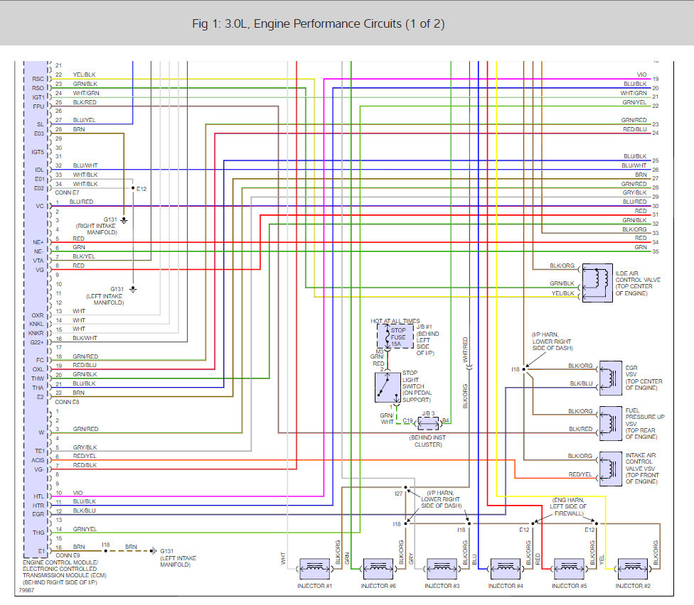

IMPALASS
  • 3,112 POSTS
Hello Is this what you are looking for? Forgive me I may be calling it something different than you.....when you say IGT signal, that stands for. Is this the IGN - Ignition you are talking about?
https://images.2carpros.com/forum/automotive_pictures/248015_1_60.jpg
JDML98
NO, it cranks fine just no start. The IGT singnal should be 0.5v to 1.0 volts generated by the ECM to tell the igniter to ground the coil. This is the control circuit that acts much like a old set of points used to except for the fact that a set of points do not cost $503.00.

IMPALASS
  • 3,112 POSTS

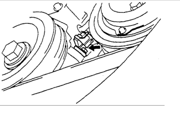

Hello Even though each has the same 4 cylinder, 2.2L DOHC is this a 2D coupe, 4D sedan or wagon? Next - I wanted to shoot these two diagrams off to you so you can start looking them over as I will too.
https://images.2carpros.com/forum/automotive_pictures/248015_2_42.jpg
https://images.2carpros.com/forum/automotive_pictures/248015_3_31.jpg
JDML98
this is a 4 door with I'm guessing California specs since my distributor in this car has only two wires instead of 4 and the external coil/igniter was only used for this year camry and the 1997 rav4.

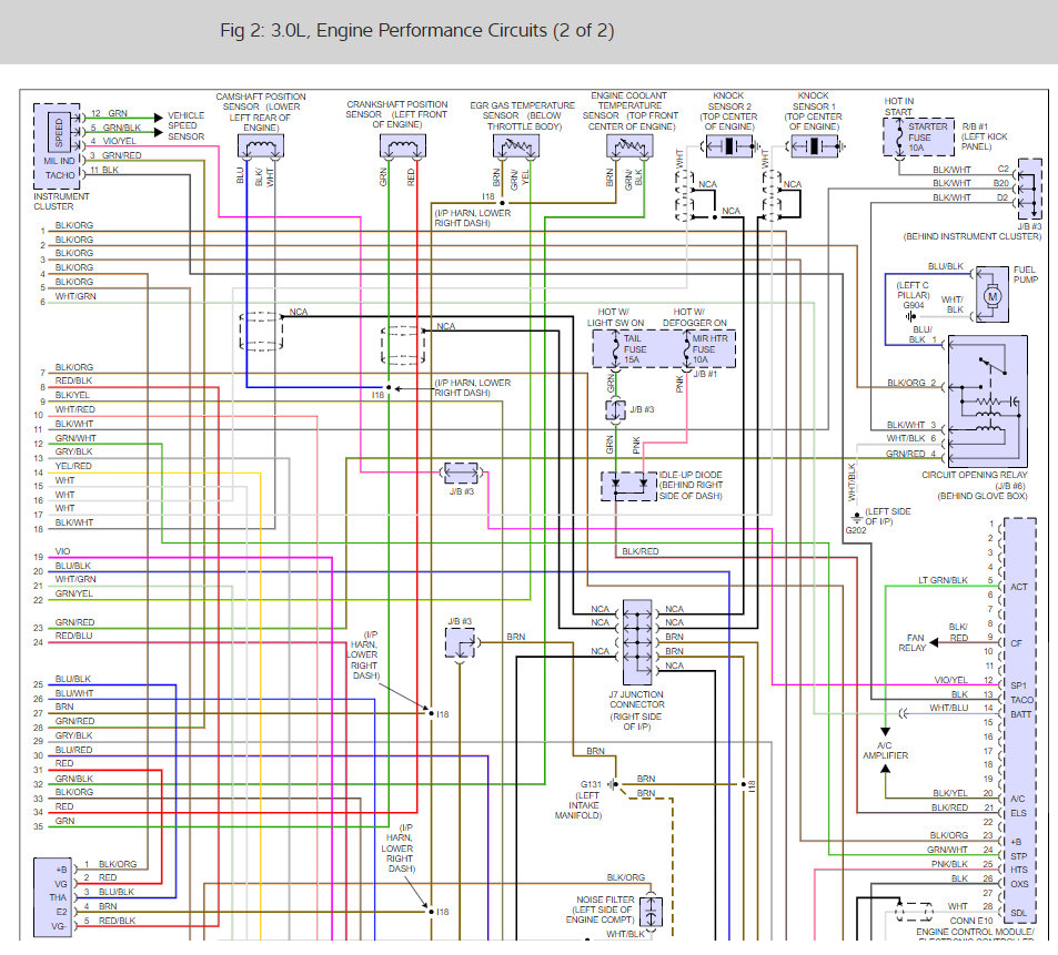

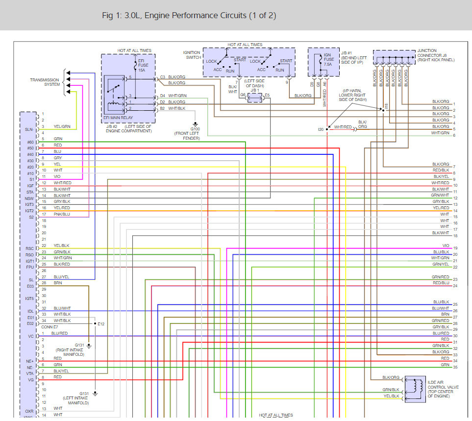

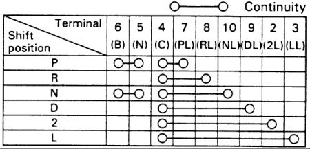

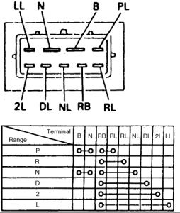

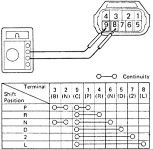

IMPALASS
  • 3,112 POSTS
Hello jdml98 Well, to me, tell me what you think, per the drawings the only things you haven't' changed is the starter, neutral position switch, I show starter relay, but is that what you called the open circuit relay or the main relay? So my first thought is what if the starter is bad and drawing the high power. You might remove starter and have it checked for FREE at Auto Zone or O'Reilly's. Next, the wires: I would check each inch of the wires for any hardness, chaffing, hot spots, loose connectors etc. Next I attached info on this neutral switch for your to check out. Tell me what you think......
https://images.2carpros.com/forum/automotive_pictures/248015_4_17.jpg
https://images.2carpros.com/forum/automotive_pictures/248015_5_13.jpg
https://images.2carpros.com/forum/automotive_pictures/248015_6_14.gif
https://images.2carpros.com/forum/automotive_pictures/248015_7_9.jpg
Using an ohmmeter, check continuity across terminals specified for each switch position shown in Figs. 11 through 14. If continuity is not present, replace switch.

Okay - I understand. Since I don't totally understand some of your terms etc, you may have to do a little more explaining so that I can better assist you. I think, based off of the last post, this is closer to what you are looking for but, some of the info when I copy to send to you doesn't' come out readable which is no good for you so we may have to try me sending it to you different. Maybe if you can not make out what you need, provide an email address and I will try sending it that way instead of attaching it to the post. Next, what do you mean when you say, CSS. I see the IGF, IGT on the wiring diagram but do not see the CSS. So it will help me if I know what it is. Also, I am sending you the entire wiring diagram which is unreadable even when I print it. But I have blown up the igniter and distributor part for you to better see. The last 4 pics are the ECM blown up but it took 4 to do it. I would cut it off at one point, then that same wire will be the bottom one on the next so you can see the order. So from here, if you can guide me where you need, I will blow up certain areas and attach that way, then with the pin information I sent, maybe you can zero in on what you need. Let me know how this does........and we will take it from here
https://images.2carpros.com/forum/automotive_pictures/248015_a_2.jpg
https://images.2carpros.com/forum/automotive_pictures/248015_b_2.jpg
https://images.2carpros.com/forum/automotive_pictures/248015_g_1.jpg
https://images.2carpros.com/forum/automotive_pictures/248015_c_2.jpg
https://images.2carpros.com/forum/automotive_pictures/248015_d_2.jpg
https://images.2carpros.com/forum/automotive_pictures/248015_e_1.jpg
https://images.2carpros.com/forum/automotive_pictures/248015_f_1.jpg
https://images.2carpros.com/forum/automotive_pictures/248015_Picture1_2.jpg
https://images.2carpros.com/forum/automotive_pictures/248015_Picture2_1.jpg
https://images.2carpros.com/forum/automotive_pictures/248015_Picture3_1.jpg
https://images.2carpros.com/forum/automotive_pictures/248015_Picture4_1.jpg
