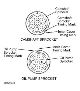

I was trying to locate A 2.3L head, but could not so I bought a running engine from the wrecking yard with 123,000 miles. I am getting ready to install it and I have a new timing belt to install. I am checking the timing, (as they told me they ran the engine before I purchased it). But after turning it manually the marks are off. When I put the crank key way at 12:00 the auxiliary mark is four teeth before the diamond and the cam mark is four teeth from the arrow. Is this the correct way to time a 1996 2.3L Ford Ranger? Any advice would be much appreciated. Thanks.

https://www.2carpros.com/images/external/62574994.gif

where are the timing marks for cam oil pump and crank?

https://www.2carpros.com/forum/automotive_pictures/261618_Graphic_185.jpg
