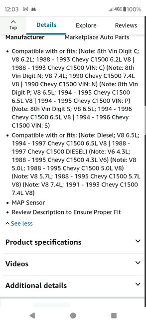

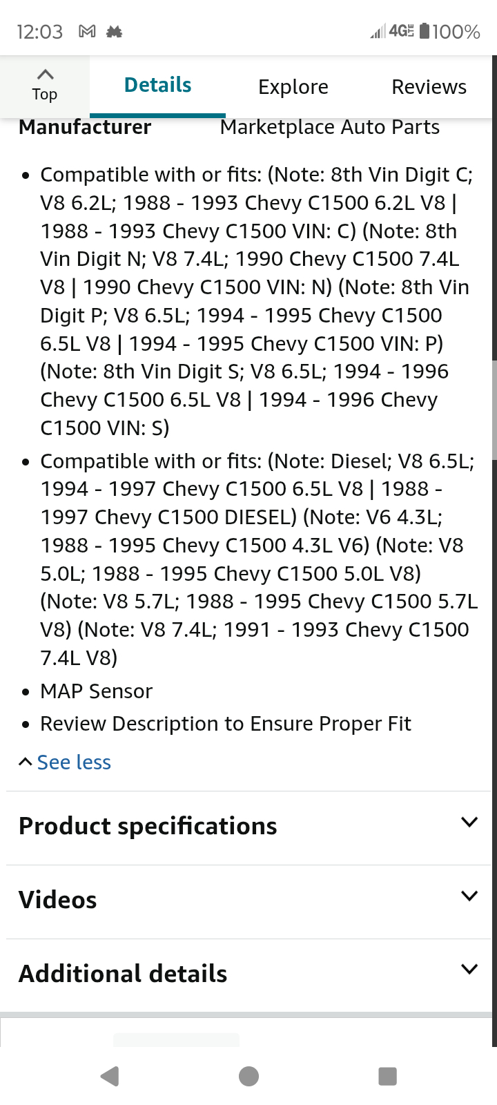

Sorry but I NEED HELP, I'M TRYING TO SEE IF the map sensor in the photo I sent will work on my truck, I understand it's simple but I somehow get confused.1991 Chevrolet C1500 w/Silverado package and 6 cylinder 4.3 motor. I sent the video to see if my uploading was working now or not.I know your thinking I'm an idiot but at least I'm honest.

Yep and I got to order some when I order the sensor. Is that the right one?
