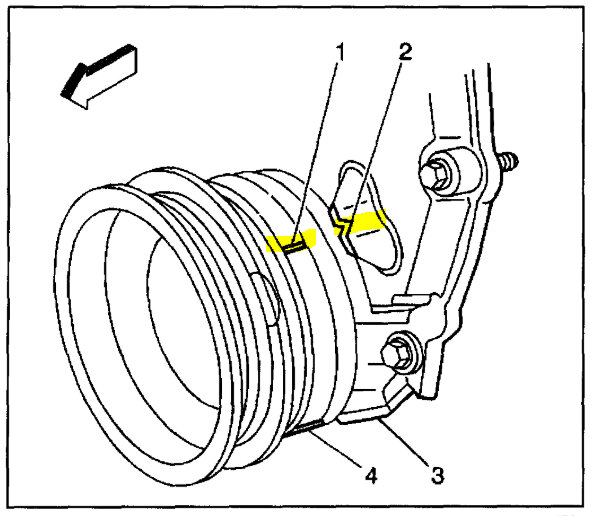

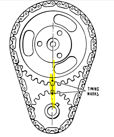

To set the timing manually, the engine should be running. Does anything happen now? Is it possible for you to record it cranking and upload it for me to hear? I should be able to tell if the timing is off by hearing it.
Since it isn't running, you could check to see if the distributor is installed correctly. On the crankshaft pulley, you will see timing marks. There should be a pointer or indicator on the timing chain cover as well. You need to align the marks to 0° see pic below. At that point, you can remove the distributor cap and confirm the rotor is pointing toward the number 1 spark plug wire. If it isn't, the distributor will need to be removed and reinstalled so that happens.
At that point, the engine should start. As far as using a timing light, I believe ignition adjustments are done by the PCM.
See pic below.

Got the timing chain on and manually set the timing or so I think, this is how I did it I took the distributor out pull the number one spark plug and then I turn the crankshaft to 0° on the mark on the compression turn I then put the distributor back in make sure that it was pointing and number one for a plug put the spark plug back in , went to crank it nothing. When I put the distributor back in, I had to take a long screwdriver and turn it a little bit so it would fit on top of that center. Like I said before, I replaced the battery. It's good the fuel pump is coming on; spark plugs are good the wires are good this is the brand-new distributor out of the box. I read somewhere about resetting the oil pump but I don't know how to do that unless when I start the screwdriver were distributor goes that's somehow reset the oil pump but I don't know and oh yeah I unhooked The wire on firewall and I hooked it back up after I tried to crank it. Any thoughts because I'm out of ideas.

If you had it at 0° TDC and the rotor pointed at the number 1 cylinder spark plug on the distributor cap, the only thing that could be wrong is if it is 180° off. If you turn the crankshaft, you'll see that the distributor turns at a different rate than the crankshaft. Turn the crankshaft until the rotor reaches its original setting, and the crank is at 0° TDC. Remove the distributor and turn the rotor 180° and reinstall it. You will find that by turning the crankshaft, it will eventually return to TDC, pointing at the number 1 cylinder.
As for the oil pump, there is no reset for it. The purpose of turning it with a long screwdriver is to align it with where the distributor will sit. The distributor is notched at the bottom where it attaches to the pump.

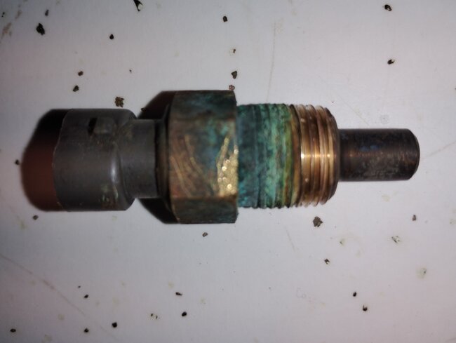

I also have ordered this engine coolant sensor because and I put the multimeter interested it it was getting 5.1 bolts, but I was getting a zero on the ohms. From what I read this could keep the motor from cranking, correct?

If it is shooting flames from the throttle body, we still have a timing issue. When the timing chain was installed, were you certain the timing was correct? See pic below.
Additionally, the coolant temperature sensor can cause a no-start if it is significantly off. In other words, if the sensor indicates it's -40°F, it will dump fuel to make it start in the cold. The opposite can happen as well.

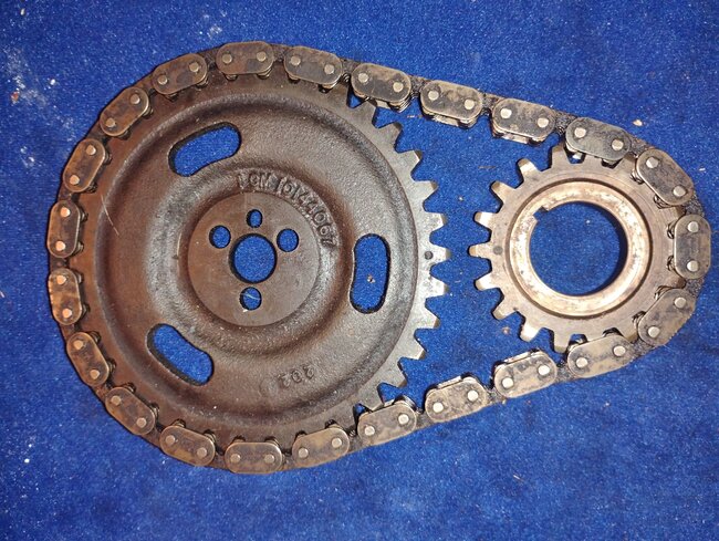

Question: Did the timing chain break or jump off time, causing the engine to stall on you? If I recall, it is considered an interference engine. We may need to do a compression test if that has happened.
See pic below.

It's not shooting flames but that one time. Video is of trying today and the timing chain photo shows it was not broken, just a lot of slack and it was replaced just as it came off . The "dots" were definitely lined up. It driving fine the motor shut off I coasted off the road 30 seconds later I had recranked it and threw another hundred yards and it did it again and it hasn't cranked since. I don't know if I had a necessary tools for any kind of compression test or how to do it but I'll do my best just tell me what to do.

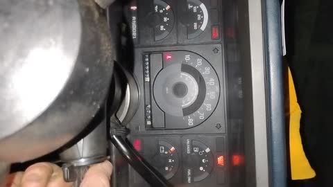

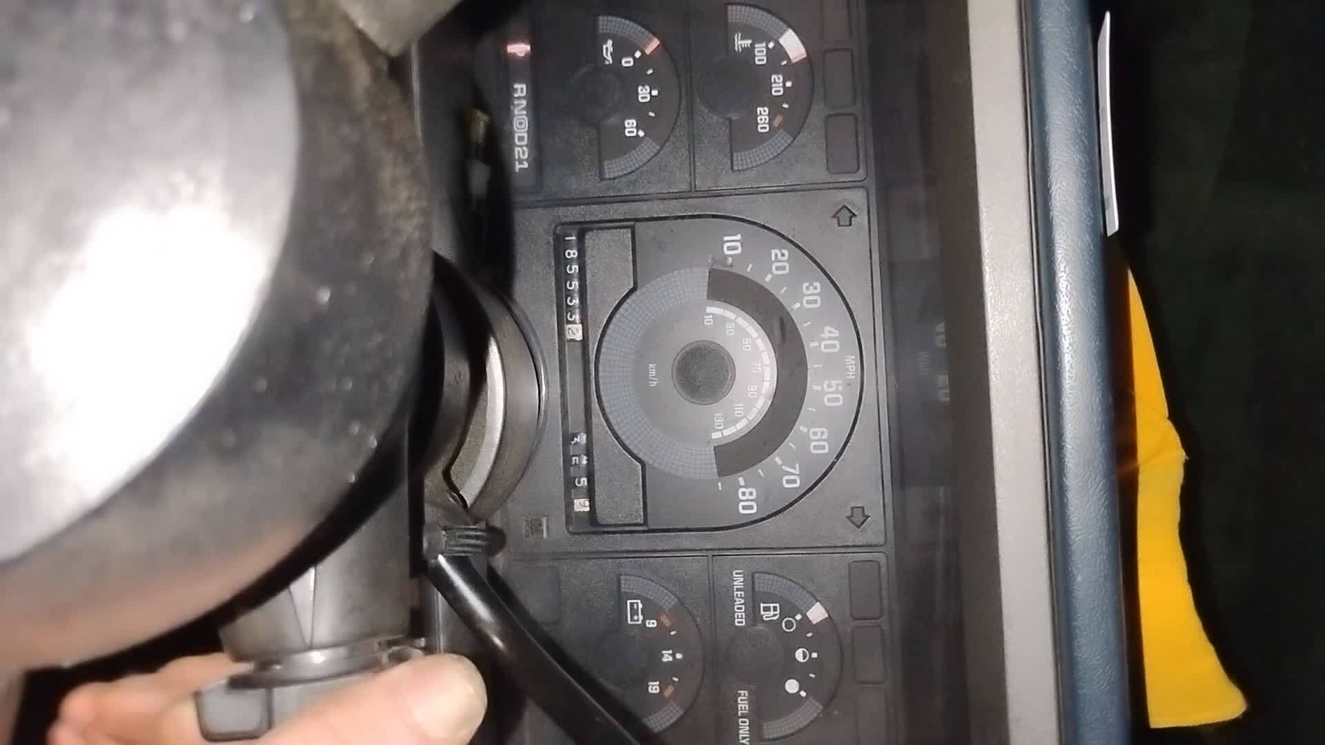

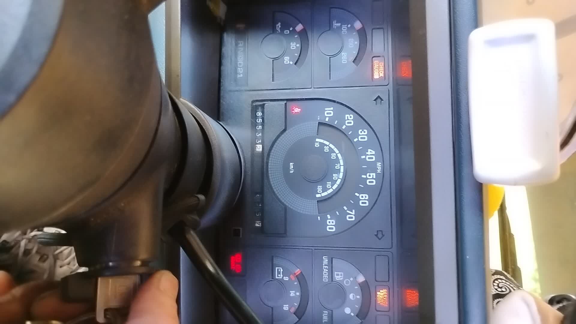

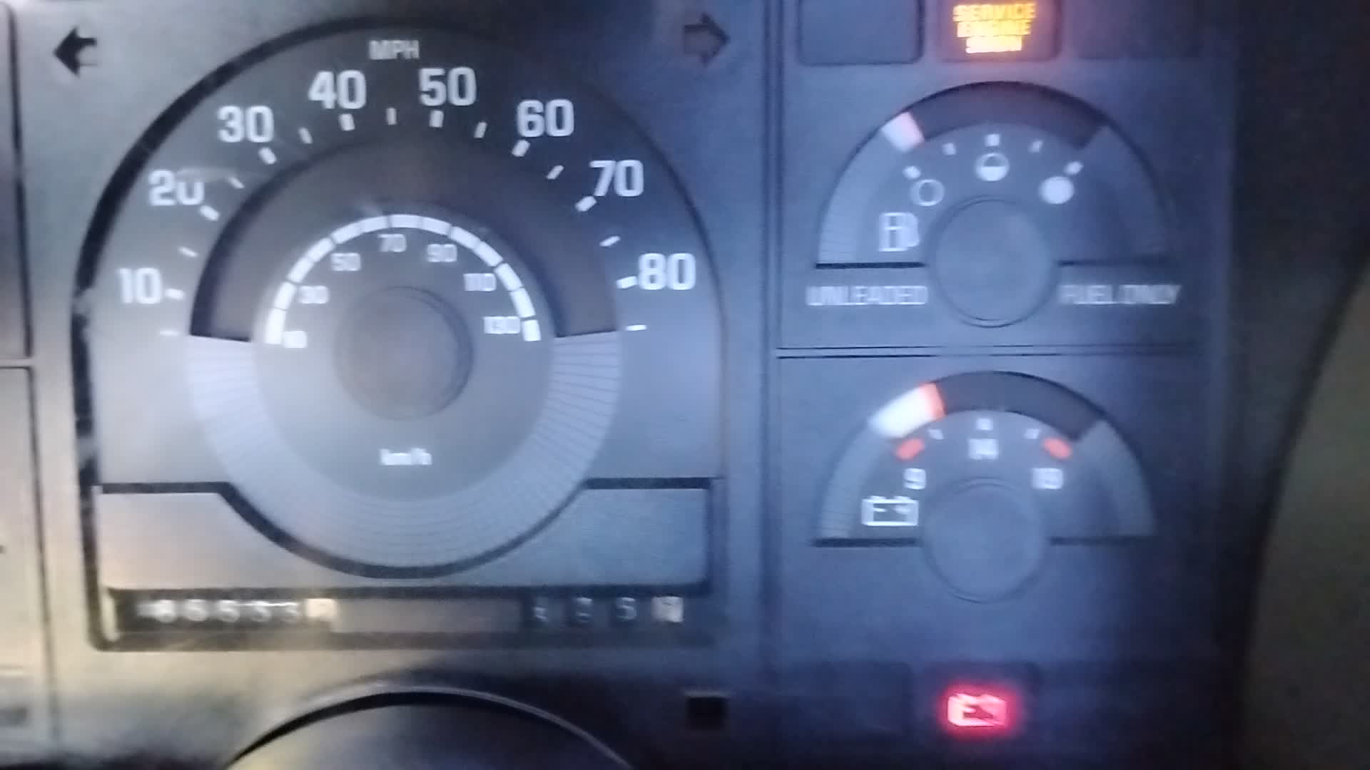

Still working on d/l the video but I wanted to let you know I have a code now. First time since April but I got it off using the d and it blink 12 3 times and then blink 3 times then 4 and done that sequence 3 times. So what am I supposed to replace now and does that code 34 make sense to you? Could it be I have finally got the information I need ? I'm not going to touch nothing until I hear from you.
Jul 15, 2025 at 10:51 AM
  • 54,503 POSTS
Yes! this code is
34 - Map sensor signal out of range, low
So I would try a new MAP sensor, or make sure the sensor is hooked up with the vacuum line, also, this can carbon foul the spark plugs which will not allow the engine to run as well. Lets remove them to see what they look like, if they are carbon fouled replaced them.

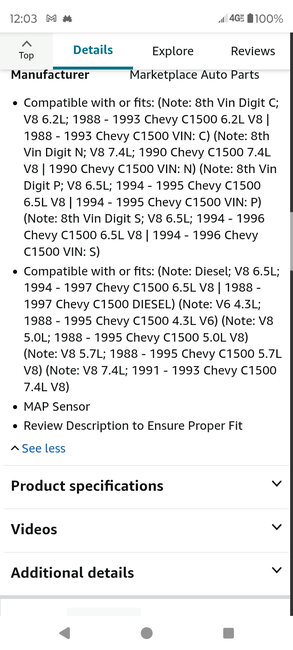

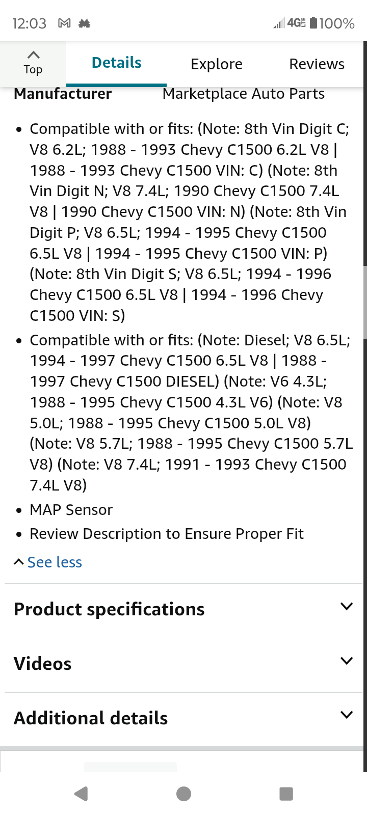

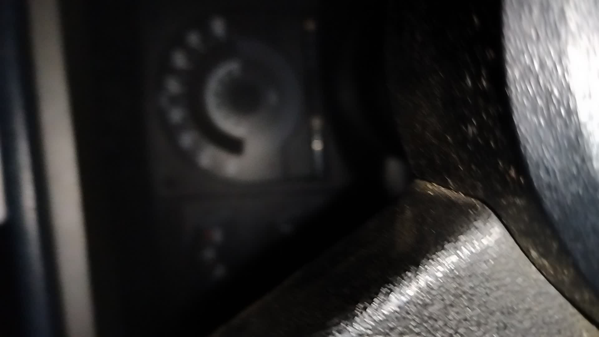

Sorry but I NEED HELP, I'M TRYING TO SEE IF the map sensor in the photo I sent will work on my truck, I understand it's simple but I somehow get confused.1991 Chevrolet C1500 w/Silverado package and 6 cylinder 4.3 motor. I sent the video to see if my uploading was working now or not.I know your thinking I'm an idiot but at least I'm honest.

Did you check the spark plugs?
Jul 17, 2025 at 10:11 AM
READYFORATRADE
  • 32 POSTS
Yep and I got to order some when I order the sensor.Is that the right one ?
