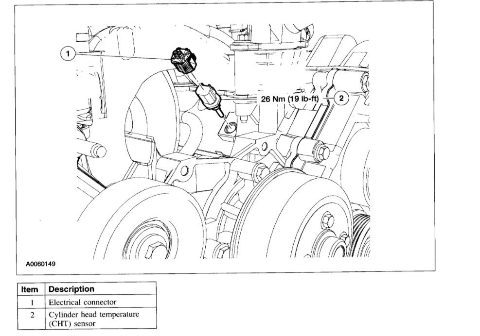

After changing the alternator, my daughter mentioned she wasn't getting any heat. So I drove it and I did get heat. I think she had A/C on by mistake. But I noticed that the temperature gauge was not working. No check engine light at all. I'm having troubles finding the location of the sensor that sends reading yo the gauge. From what I read there are 2 sensors for the 4.6 Ford. Can someone please offer some knowledge of which one controls the gauge and its location. A mechanic mentioned there was one next to alternator but didn't know if that's the one in question.

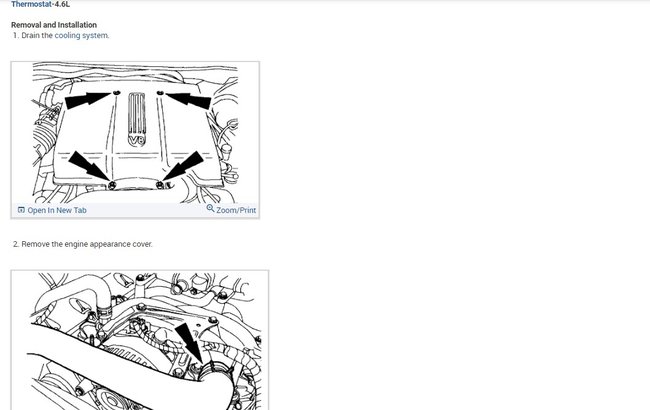

For this issue you need to focus on the symptom and find out what system is at fault, for example the cooling system, electrical, or heating and A/C. I would verify the temperatures of the heater hoses as they enter the heater core at the bulkhead under the hood. The most common issue is a stuck open thermostat. Here is a guide that can you: https://www.2carpros.com/articles/how-a-car-heater-works

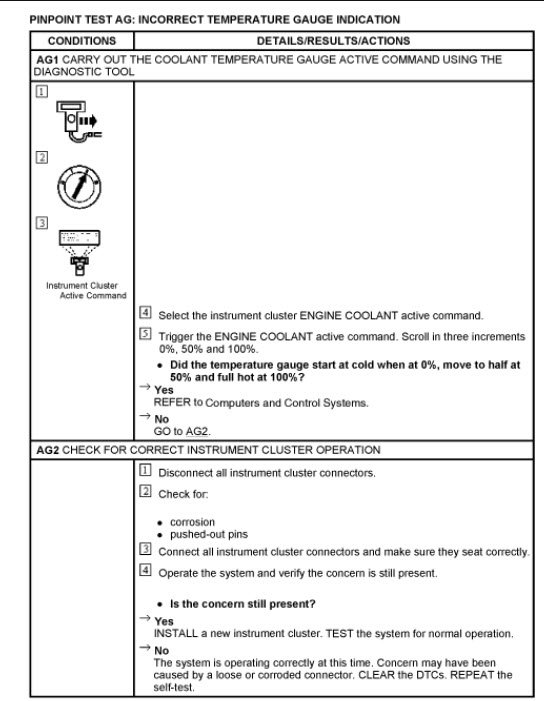

Before replacing any parts we should have the powertrain control module (PCM) and the instrument cluster module scanned for codes. A scan tool will need to have bi-directional control also, meaning that there is a test (see attachment) for the gauge itself that will verify gauge operation as you control it from 0-100%. Other than that, the only sensor for temperature is the cylinder head temperature sensor. This sensor sends a signal to the PCM, then the PCM networks a signal to the instrument cluster module. I have also seen bad alternators, new and old, cause crazy electrical system issues. You can try to disconnect the alternator then start the vehicle and see if anything has changed.
