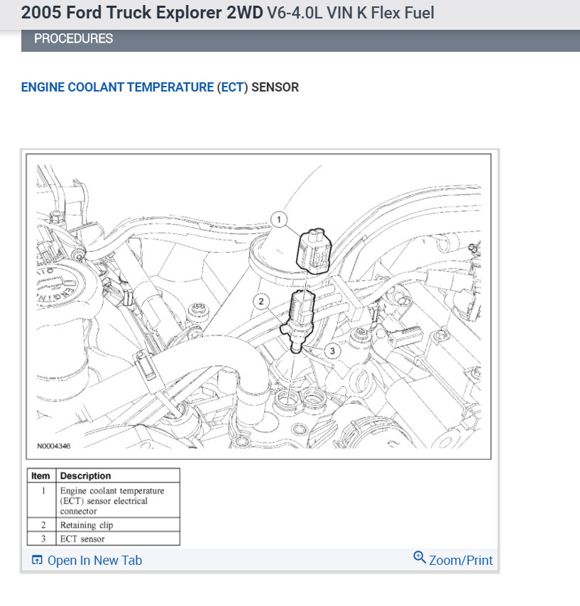

How to locate the Engine Coolant Temperature Sensor?

Its located at top right of engine near injector harness. Check out the diagrams (Below). Please let us know if you need anything else to get the problem fixed.
