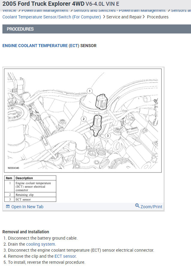

I need to find and replace coolant temparture sensor, how do I find and what type of tools do I need to replace

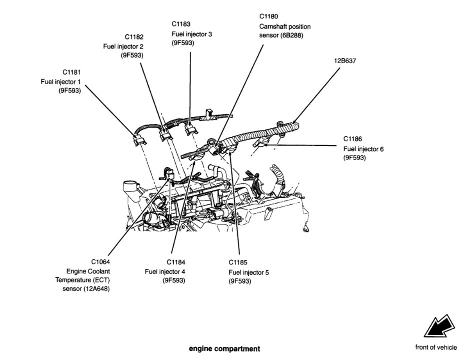

The coolant temperature sensor is located on top of the engine, just behind the thermostat housing.
It can be using basic hand tools.
Remember to only work on the cooling system when the engine is cool.

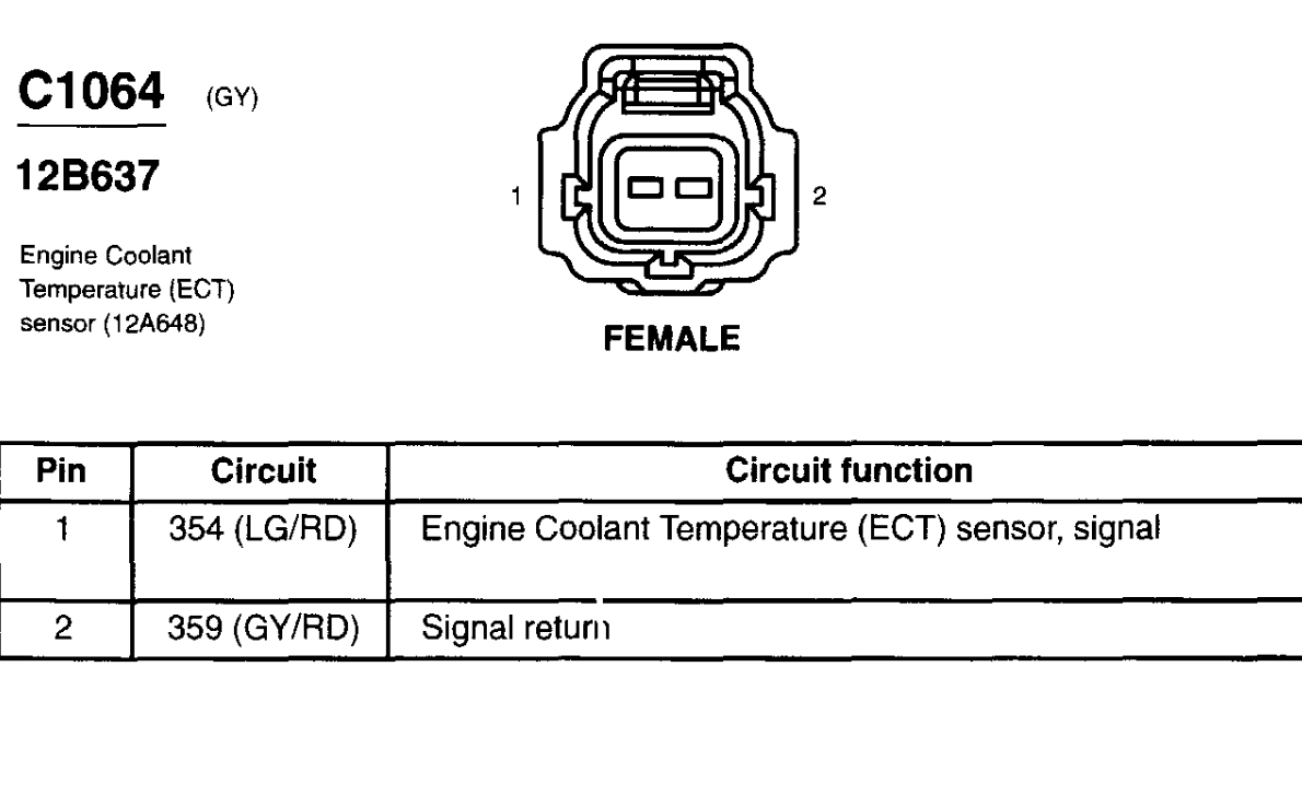

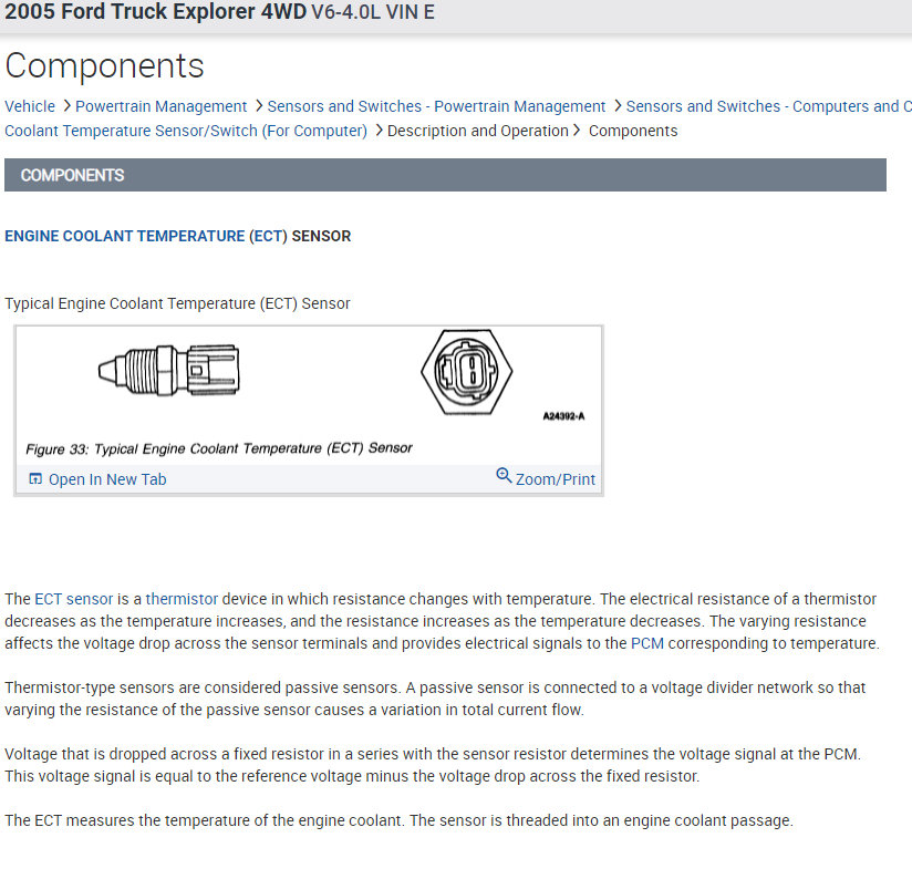

I have attached the replacement procedure for your reference.
