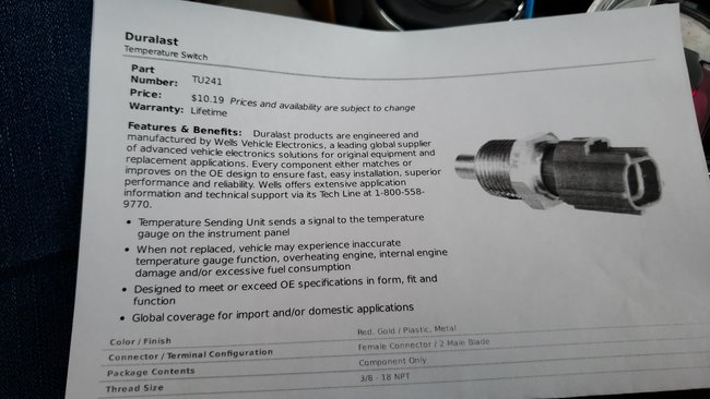

It is my understanding there are two engine temperature sensors on my motor: One for the temperature gauge and one for the computer. My gauge is not working. One sensor has two wires and the other has only one. Which is for the temperature gauge?
Thanks very much,
Richard Reed
Nov 23, 2016 at 4:32 PM
CARADIODOC
  • CAR REPAIR CONTRIBUTOR
  • 34,308 POSTS
You have that exactly right. All sensors for the engine computer have a ground wire, and current flow through them is monitored, so it goes back to the computer, then to ground on a different wire. For that reason its sensor has two wires, the ground and the signal wire. The dash gauge is a simpler circuit. Its sensor has just one wire. If you ground it at the engine, the gauge should jump to full "hot". If you just unplug it, the gauge should read "cold"
Be aware that for quite some time on Ford products, the instrument cluster is the most intelligent, (complicated / unreliable), computer on the vehicle. As such, there is a whole lot more involved than the simple, reliable gauge and sending unit we had in the past. As a result, you might find the gauge reading does not change simply from grounding or opening the sensor wire. You might need to start the engine, you might have to drive the vehicle, or you might have to do nothing. This can turn a really simple diagnostic procedure into a complicated or misleading one.

The Engine Temperature Sender, which controls the temperature gauge only has one wire connected to it. The Engine Temperature Sensor has two. If you ground the single wire, your gauge should go to high otherwise you likely have a wiring issue and not a Engine Temperature Sender issue.

Thank you very much for the quick replies. Much appreciated. I am going to wait until daylight tomorrow to replace the sender. Thanks again!

Cardiodoc, Freemba, You were both correct when stating it could be more of a problem then just the sending unit. I replaced it and the temperature gauge still does not work. Looks like it might be a wiring issue and I have had no luck yet finding the fault. Any suggestions would be most welcome. Thanks!

Coolant temperature sensors are notoriously reliable because they have just one part inside. That's a "thermistor", meaning temperature-dependent resistor. The one glaring exception was Ford had a huge failure rate in the early to mid 1990's, but that was with their two-wire sensors for the engine computers, not for the dash gauges. Failures of all temperature sensors is much more likely to be caused by mechanical damage and / or rough handling. Failures of the circuit are more likely to be caused by wiring problems, until we get to where the instrument cluster is a computer module, then all bets are off.
In your original post you said the gauge is not working. Does that mean it stays on "cold"? If so, unplug the wire from the sending unit, then use a jumper wire to ground that terminal. (Ground the wire, not the terminal on the sensor). That should make the gauge read full "hot". If it does, did you use Teflon tape to seal the sensor's threads against leaking. That is an insulator and will prevent the sensor from being grounded. It won't work that way.
If the gauge stays on "cold" when you ground the wire at the sensor, there is a break in that wire between the sensor and the gauge cluster, or there is a problem in the cluster. At that point you might want to visit a mechanic to have him use his scanner to run a gauge test. That will run all the gauges to 1/4, 1/2, 3/4, full, and back to 0". If only the temperature gauge does not work, the problem is on the cluster. If it does work properly, we need to look at the wire going to the sensor.
Aug 11, 2020 at 4:48 PM
CDPSRAR
  • 16 POSTS
Yes, when I make a connection between the single wire for the sender and the engine block the gauge pegs all the way to the right. I did not use Teflon tape or any sealer. But the gauge still won't register when the motor is warmed up. I'm wondering if the parts guy gave me the sensor instead of the sender and, if so, would it cause the current symptoms? I am looking at images of each part and it seems I may have the wrong one. Thank you again for your time.
CDPSRAR
  • 16 POSTS
Please disregard. I went back to the parts store and got the correct part. The gauge works!! Thanks again for your time and knowledge.

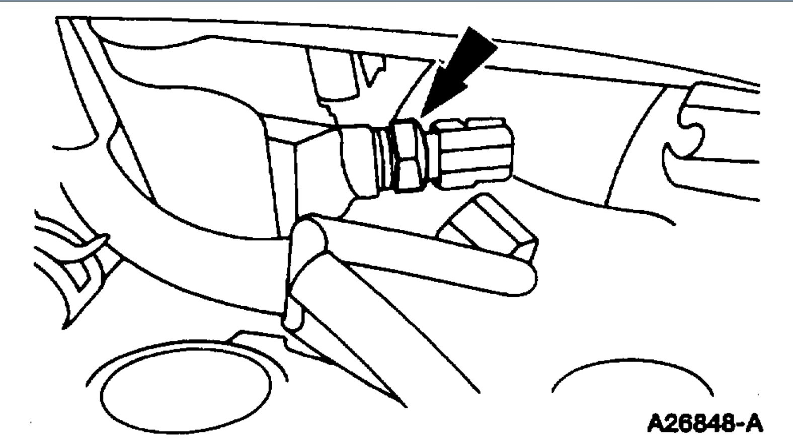

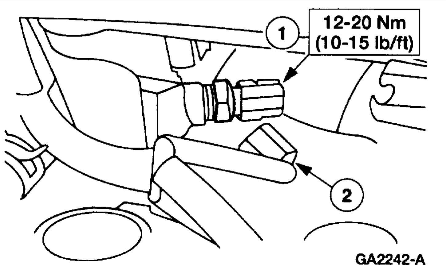

BOBD79
need to know where this sensor is and how to replace it
Aug 11, 2020 at 4:50 PM (Merged)
  • 75,992 POSTS
All you need is an open end wrench
Heres a guide to look at, not vehicle specific but pretty much the same thing
https://www.2carpros.com/articles/coolant-temperature-sensor-cts-replacement
See attachments below for your vehicle

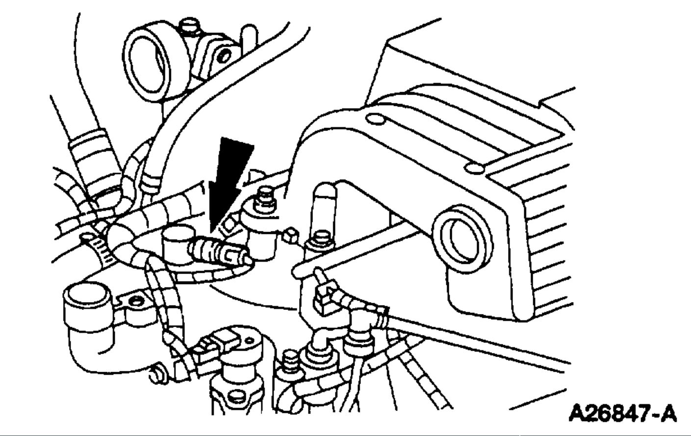

CARLA REED
  • 27 POSTS
Need to know where to locate this on my truck. See image below.
Thanks,
Carla Reed
