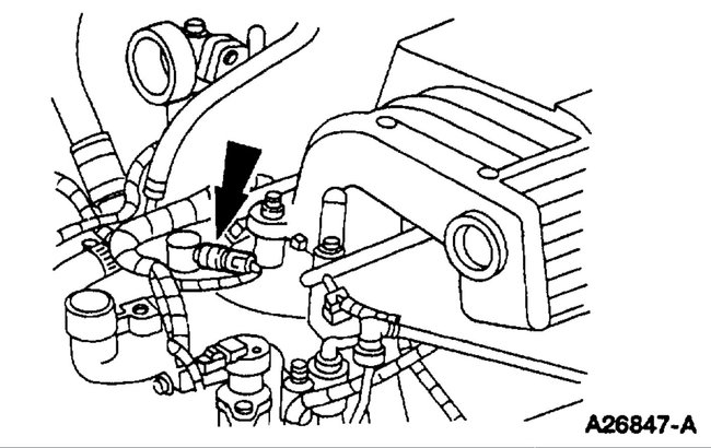

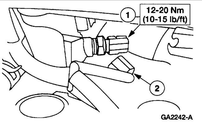

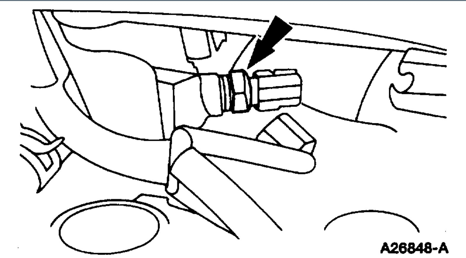

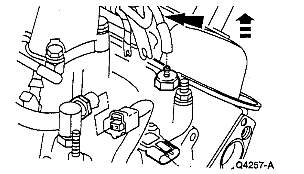

Need to know where this sensor is and how to replace it
Tuesday, August 11th, 2020 AT 4:50 PM (Merged)
  • 75,992 POSTS
All you need is an open end wrench
Heres a guide to look at, not vehicle specific but pretty much the same thing
https://www.2carpros.com/articles/coolant-temperature-sensor-cts-replacement
See attachments below for your vehicle

Need to know where to locate this on my truck. See image below.
Thanks,
Carla Reed
