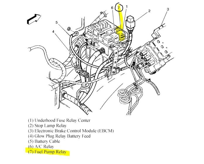

Have you checked the fuel pump relay? It is located in the under hood power distribution box. I attached a pic to help you locate it. Check this first. You can try switch a different relay with it that has the same part number, or here is a link that shows how to check a relay.
Here are a few links you may find helpful:
This could also be a weak ground for the fuel pump. Let me know what you find with the relay and we'll go from there.

Yeah, I swapped the AC relay and the fuel relay and it didn't help so I swapped them back. I also thought it was the ground so I took the bolt off and cleaned it up. Still no change.

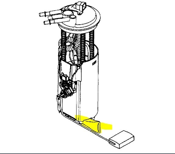

Do me a favor. Check voltage to the pump when there is only 10psi. We need to determine if it is a power related issue or something is clogging.
When you replaced the pump, was the strainer at the bottom of the pump also replaced? Is there any chance you reversed the supply and return hoses?

Alright. I will check tomorrow I just have to grab my meter from work today. Yeah, the strainer was replaced as well. And the supply and return are two different sizes, so I don't think I could've reversed them, but I will definitely check.
