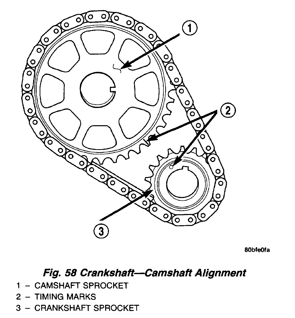

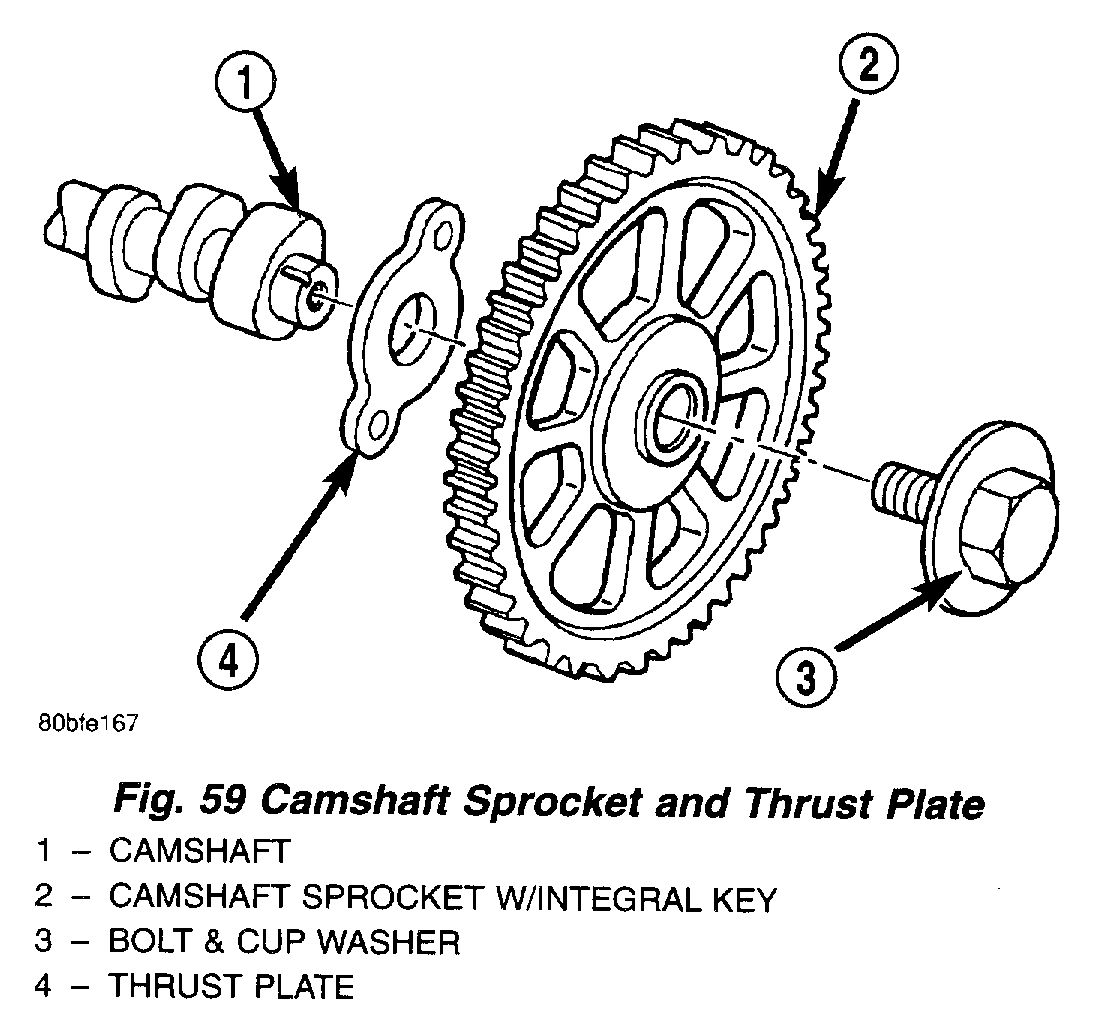

It sounds like the timing chain needs replaced. I would remove the timing chain cover and inspect.

Pic 1
Fig. 58
6. Rotate crankshaft until the "0" timing mark is closest to and on the center line with camshaft sprocket timing mark (Fig. 58).

Pic 2
Fig. 59
8. Remove the camshaft sprocket bolt and washer (Fig. 59).
9. Remove the crankshaft sprocket, camshaft sprocket and timing chain as an assembly.
10. Installation of the timing chain with the timing marks on the crankshaft and camshaft sprockets properly aligned ensures correct valve timing. A worn or stretched timing chain will adversely affect valve timing. If the timing chain deflects more than 12.7 mm (1/2 inch) replace it.
INSTALLATION
Assemble the timing chain, crankshaft sprocket and camshaft sprocket with the timing marks aligned (Fig. 58).

2. Install the camshaft sprocket bolt and washer (Fig. 59). Tighten the bolt to 68 Nm (50 ft. Lbs.) Torque.
3. To verify correct installation of the timing chain, rotate the crankshaft 2 revolutions. The camshaft and crankshaft sprocket timing mark should align (Fig. 58).

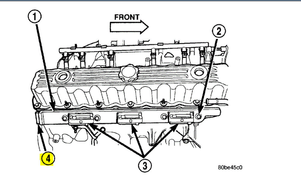

If you are worried about ignition spark from the plugs, simply disconnect the ignition coil rail and isolate the connector. (See pic 1)
Not being there, I'm not sure how much fuel you are referring to. But if it is spark from the plugs that is the concern, disconnecting the coils will stop that from happening.
