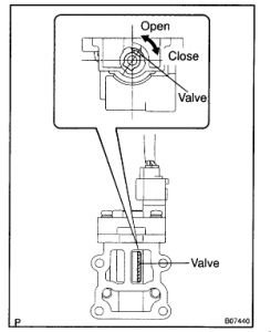

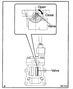

Idle air control inspection:
Remove IAC valve. (Clamp water lines before removal).
Clean deposits and dirt using throttle body cleaner.
Check that the IAC valve is half open.
Connect the IAC valve wiring connector to the valve.
Turn the ignition switch ON.
Verify that the IAC valve moves within.5 seconds, stepping in order of fully closed, fully open and returning to half open.
If operation is not as specified, replace the IAC valve.

Ok I removed iacv and tried the manual test. It didnt move. Before I go spend 200 plus is there any other test? Like I said I did shampoo the floors is there something I may have got wet? Or should I put it all back together and tow to a shop?

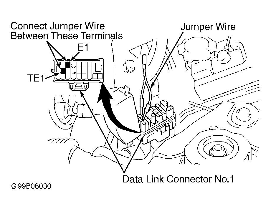

Start engine and warm engine to normal operating temperature. Ensure idle speed is within specification.
Turn ignition off. Apply parking brake and place transaxle in Neutral.
Install Jumper Wire (SST 09843-18020) between terminals TE1 and E1 on data link connector No. 1. See Fig 1.
Data link connector is located at passenger's side of engine compartment, near strut tower.
Start engine and note engine speed. Engine speed should increase to 900-1300 RPM for 5 seconds and then return to idle speed. If engine speed is as specified, turn ignition off and remove jumper wire. If engine speed is not as specified, turn ignition off and remove jumper wire. Go to next step.
Problem is yours doesn't Idle so it would be hard to do that test.
If you have a scan tool that can control the idle speed you could connect it and see if you can control the IACV. A cheaper way might be a salvage yard they used that same valve on multiple vehicles and years.

Ok removed iacv from throttle body retried manul test. The valve close and opens like a eye blinking and jusas fast. So I assume iis working properly?
Saturday, May 9th, 2020 AT 1:47 PM
CARPFISHER
  • 7 POSTS
Up and running. Thank you for the help.
STEVE W.
  • 15,688 POSTS
Stuck valve or loose connection? Those valves can be temperamental like that.
