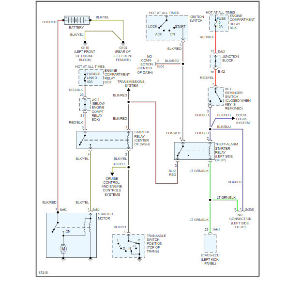

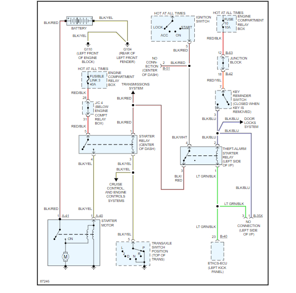

And behind my radio there are two relays which relays are they? I was thinking the power door locks and maybe starter relay?

Okay, do you have a voltmeter to do some testing in the starting circuit?
Check the fuses listed for power on both sides.

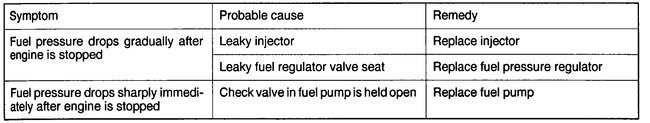

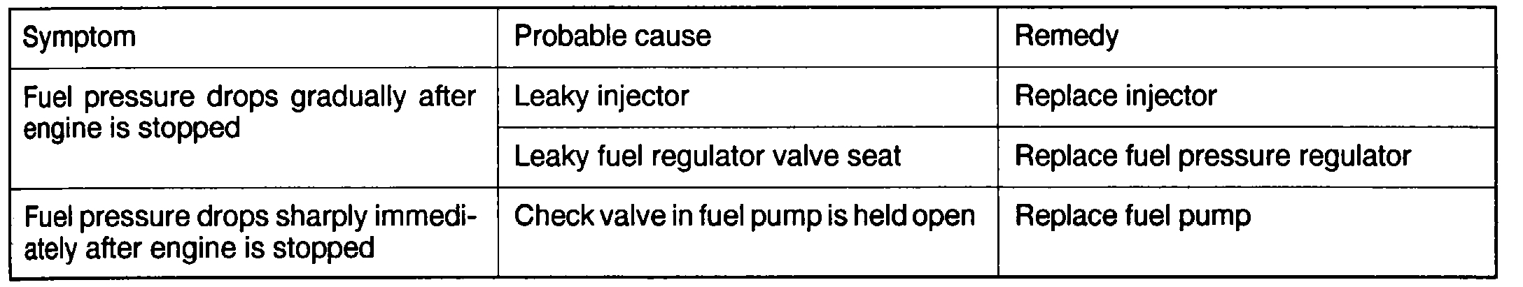

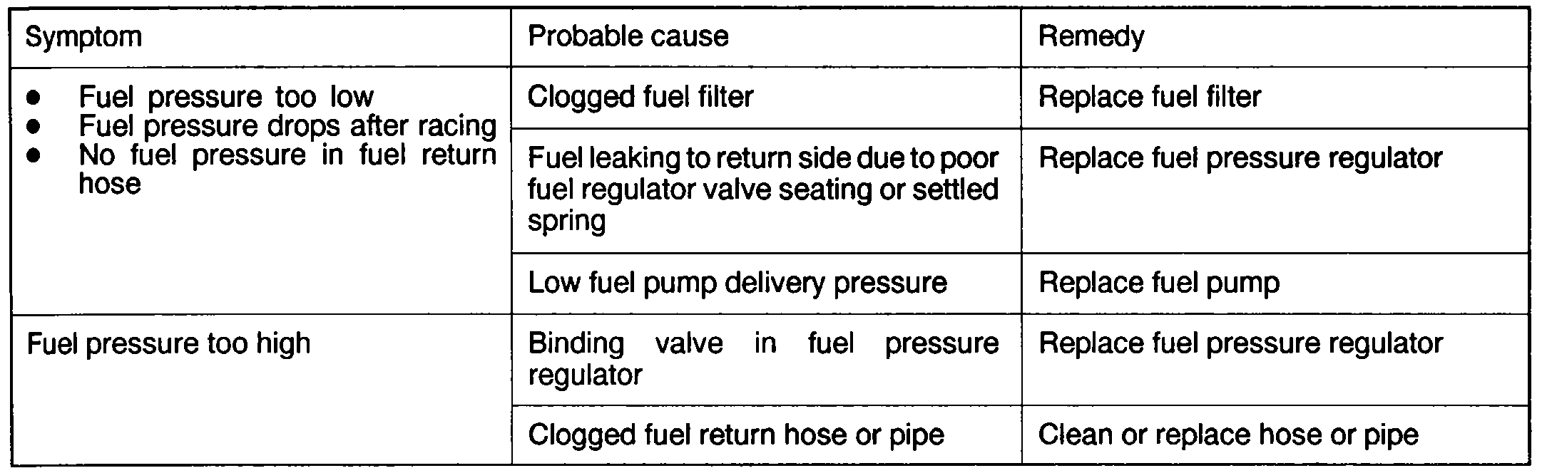

  • 110,194 POSTS
Welcome back:
Most certainly it could be the filter preventing pressure issues. Here is a general description showing how to check fuel pressure:
The pictures below show common causes of low fuel pressure or why pressure can drop. Note that one possibility is a clogged fuel filter.
The fuel pressure your vehicle should have is the following:
Measure fuel pressure while the engine is running at idle.
Standard value: 324 - 343 kPa (47 - 50 psi)
