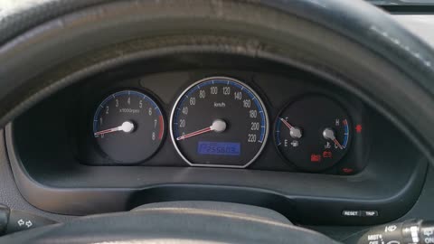

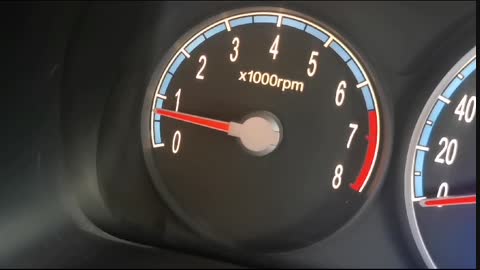

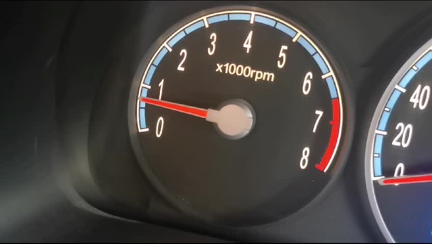

My car has two issues which I believe are related to each other. First one, starting problem (only if hot or parked under the sun for some time), it takes 2 or 3 tries until it starts. If parked under shade or during cold weather, no starting issue at all. Second one, it has something like knocking. Only if the engine is running and not moving (in idle position). Something like misfire. RPMs starts to shake little in sudden move. Once the car starts moving, no issue and running properly. Note: Already I changed the coils, spark plugs, fuel pump, throttle valve, battery and the common rail.

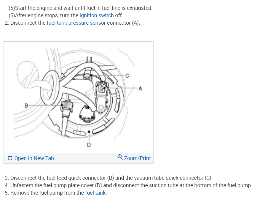

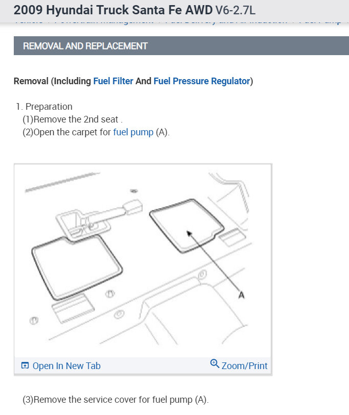

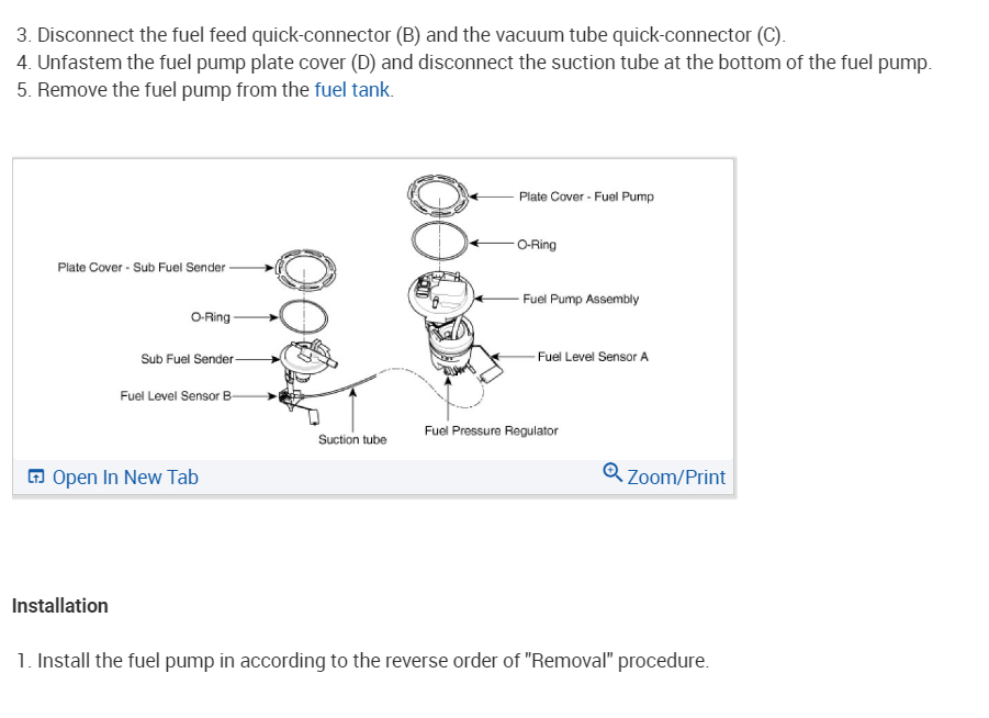

This sounds like a classic fuel pump problem, but to be sure we can do a fuel pump pressure test.
Here is a generic guide to help you step by step with instructions in the diagrams below to show you how on your car:
and
https://www.2carpros.com/articles/engine-cranks-excessively-before-starting
Standard Value: .................... 375 - 385 kpa (3.82 - 3.92 kgf/sq.cm, 54.3 - 55.8 psi)

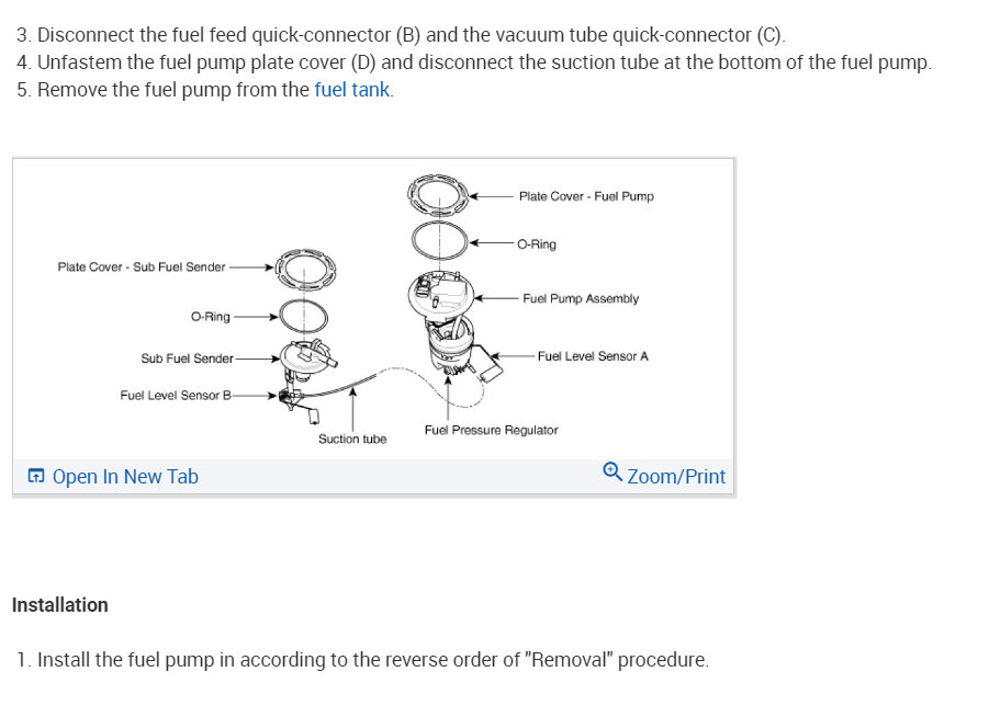

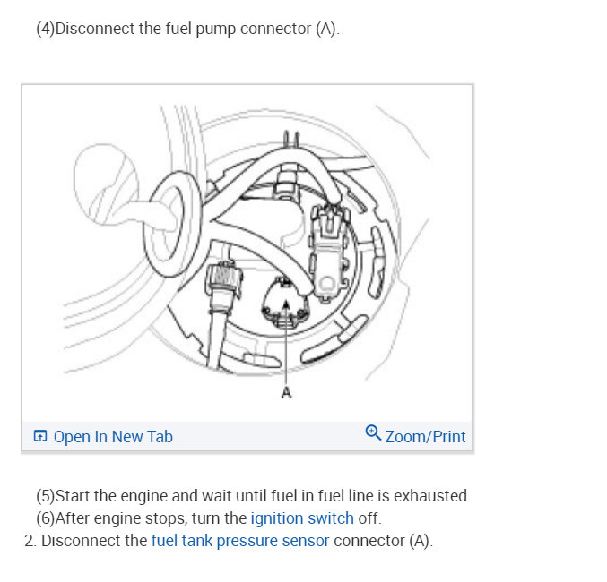

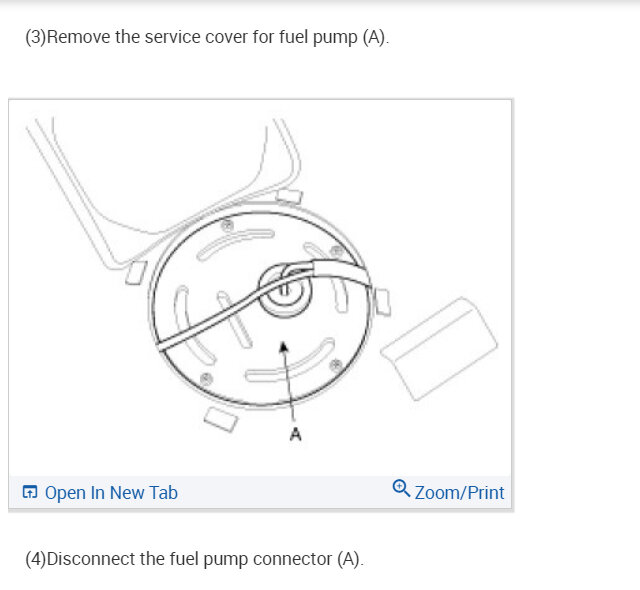

You can rent a fuel pressure gauge set from the auto parts store. Here is how to change the pump out in case you need it. Check out the images (below). Let us know what happens and please upload pictures or videos of the problem so we can see what's going on.

Already I changed the fuel pump 3 days ago. But still the same problem.
I believe you are talking about the fuel pump only. Not the sub fuel. Yes?
I uploaded 2 videos with my question. I will upload it again now for you.

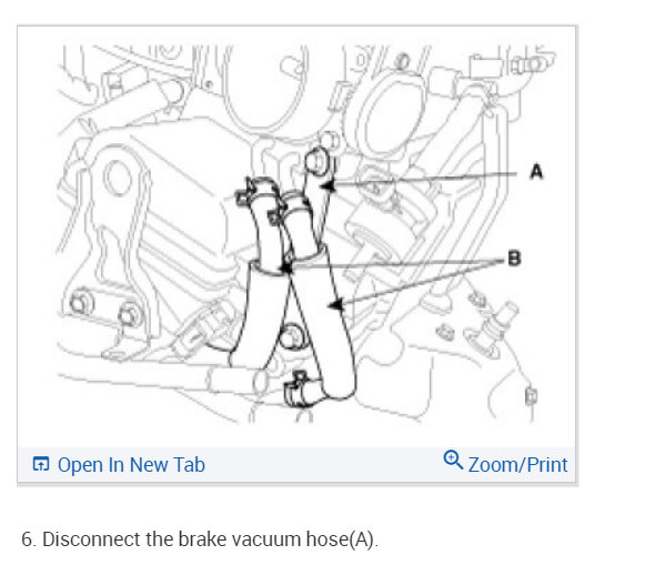

Thanks for the videos. This can be a dirty throttle body or a vacuum leak.
here are two guides you can go over to help us fix it:
And use this guide when the engine is cold only:
+1
Friday, August 4th, 2023 AT 12:04 PM
HOSSAMENG84
  • 10 POSTS
Yes, this is it. Thank you so much. It is a vacuum problem. I closed the valve on the vacuum line and both issues been solved.

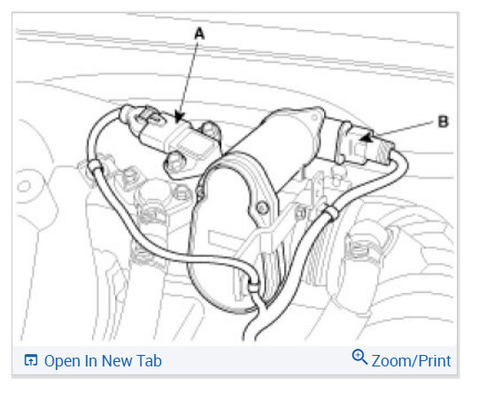

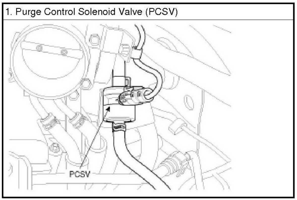

I didn't find the vacuum leak. I just closed the vacuum line and the starting issue been solved. But the RPM instability still exists. I believe it may be the purge control solenoid. What do you think?
Monday, August 7th, 2023 AT 11:33 AM
KEN L
  • MASTER CERTIFIED MECHANIC
  • 55,499 POSTS
"Yes, this is it. Thank you so much. It is a vacuum problem. I closed the valve on the vacuum line and both issues been solved." Sorry I was confused. Yes, it could be the EVAP purge valve causing the issue. I would remove it to see if you can blow through it, if so, the valve is bad here is the location of the valve near the throttle body. Check out the images (below). Please let us know what happens.
+1
Tuesday, August 8th, 2023 AT 10:07 AM
HOSSAMENG84
  • 10 POSTS
Yes. The old purge valve was defective and I could blow through it. I changed it already and so far, so good. Hope this will solve that issue for good. If any other issue comes to the surface I will update you. Thank you so much for your help.
