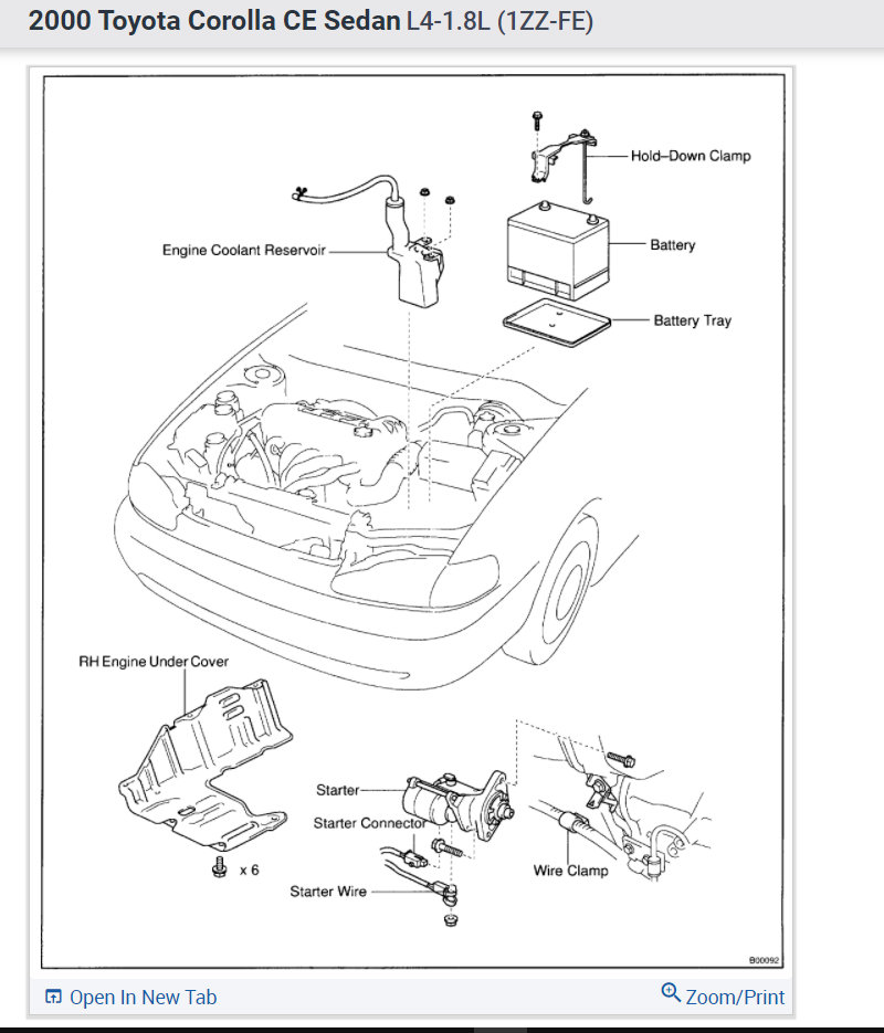

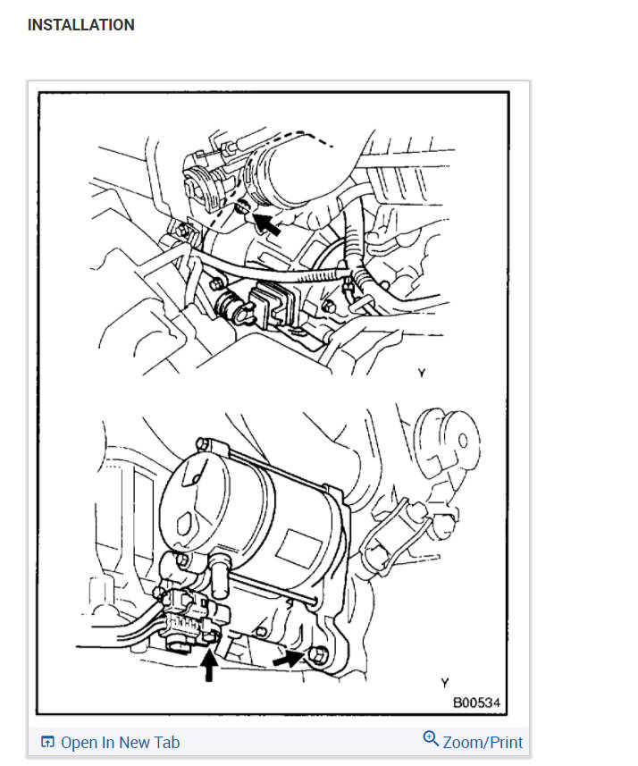

I have an old car and wondering if this problem is worth fixing or getting a new one. My car started just fine last night. As of this morning all I am getting is a single click when turning the ignition. From further looking into the issue I am confused if the problem is even my starter or if it’s the starter solenoid? I’m not sure if they are together or separate. I can locate the starter but not the solenoid to see what exactly I need to replace. My car still is getting juice when turning the ignition(radio, lights, wipers all work) but just a single click once I try to start the vehicle. Any help would be appreciated.

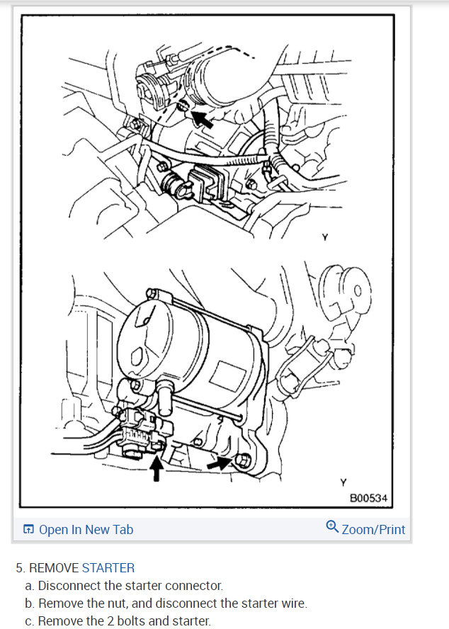

If the connections are good the starter sounds like it is bad. To be sure these guides and diagrams below can help us fix it. This sounds like the starter is having problems or the battery needs to be load tested these guides can help us fix it.
and
and
