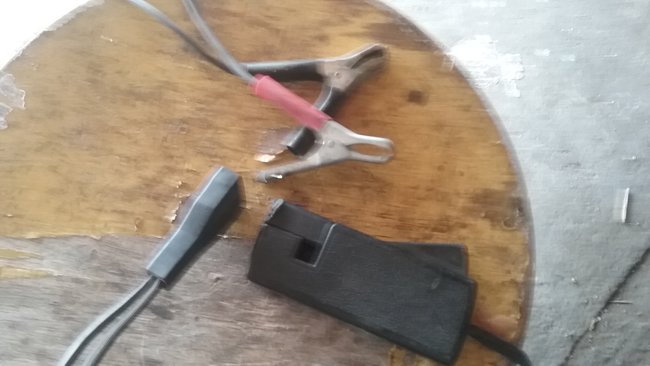

TIMMAHANEY
  • 65 POSTS
Hey, it is me again. I still have not gotten my car started. Can you please tell me what this is?
Wednesday, May 16th, 2018 AT 11:47 AM
