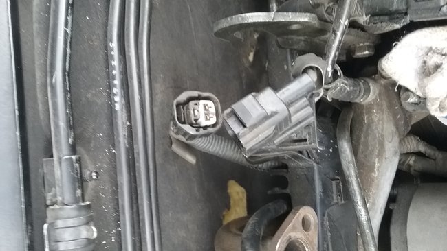

What is this and it it suppose to have power?
Monday, April 30th, 2018 AT 3:34 PM
  • 52,797 POSTS
Looks like it plugs into the connector next to it.
Monday, April 30th, 2018 AT 3:35 PM

Okay, did you receive my picture? It is on the fire.
Monday, April 30th, 2018 AT 3:46 PM
TIMMAHANEY
  • 65 POSTS
Well, what is next boss?
Monday, April 30th, 2018 AT 3:48 PM
  • 52,797 POSTS
Did you plug the connector in?

Did you remove that connector when you removed the upper manifold?

I cannot remember, which connection are you talking about.
Tuesday, May 1st, 2018 AT 2:31 PM
  • 52,797 POSTS
The picture you sent me with the open connector.
Tuesday, May 1st, 2018 AT 2:44 PM
TIMMAHANEY
  • 65 POSTS
No, pretty sure I did not.
Tuesday, May 1st, 2018 AT 3:00 PM
TIMMAHANEY
  • 65 POSTS
But I cannot say anything because I am not one hundred percent. Why is it important?
Tuesday, May 1st, 2018 AT 3:02 PM
  • 52,797 POSTS
Can you recheck that connector? I am very curious about that. It looks like it needs to be connected somewhere.
  • 52,797 POSTS
I got one picture. And it looks like they are both female connectors. That means there are two connectors that go in there from the upper intake you have off.
Tuesday, May 1st, 2018 AT 3:21 PM
TIMMAHANEY
  • 65 POSTS
I pulled them apart.
Tuesday, May 1st, 2018 AT 3:26 PM
  • 52,797 POSTS
What did they hook up to?
Tuesday, May 1st, 2018 AT 3:29 PM
TIMMAHANEY
  • 65 POSTS
I just connected them.
