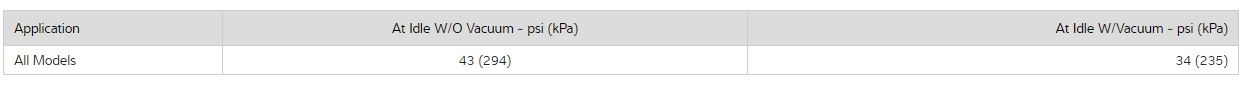

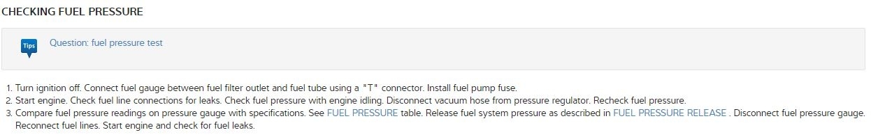

I attached pictures which show fuel pump testing specific to your vehicle.

Thanks for the tips and images Joe. The spark has already been checked and it's fine. The fuel pump is fine.
