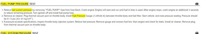

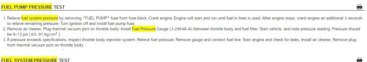

Based on your description, it sounds like the fuel pressure is too high. First, I would recommend checking pressure. I have attached a picture which contains the manufacturer's specifications for pressure.
Here are general directions for checking pump pressure:
The picture I attached has more specific directions. The second picture shows the regulator. To the best of my knowledge, and the research I have just done, there are two different throttle body injection systems for this vehicle. One is a model 200 and the other, 700. The model 200 has two injectors and a built in pressure regulator. The 700 has one injector and a serviceable regulator.
Now, at this point, I have a feeling that you will find the pressure to be higher than it should be. Often times the fuel pressure regulator goes bad. The result can be pressure which is too high or too low. Since you have to unplug the injector and start the engine, it leads me to believe it is too high.

Okay, thank you. It will take me a week to get a gauge. I will let you know when I test that. I have taken the regulator apart and the diaphragm is fine, my truck is the 200 model. This problem has been intermittent like I can drive to the store fine and on the way back it struggles, if I get on the freeway on my way back from my last stop it drives fine. It has been happening since I got the truck in march. Is there any sensors or vacuum lines I might have looked over? It is kind of tough to know which lines goes where because this truck has clearly been worked on before by an amateur.

My truck will not start now. I checked fuel pressure a few days ago and that was at 13-14 psi. I know fuel is getting to the cylinders but it is not sparking. I just replaced the distributor, ignition coil and I know I am getting power through the ignition coil. The truck was running decent just felt like it needed to be timed. Now it is not running at all. I think it is some electrical issue but I do not know how to trace it down.

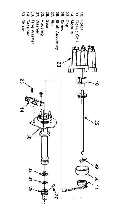

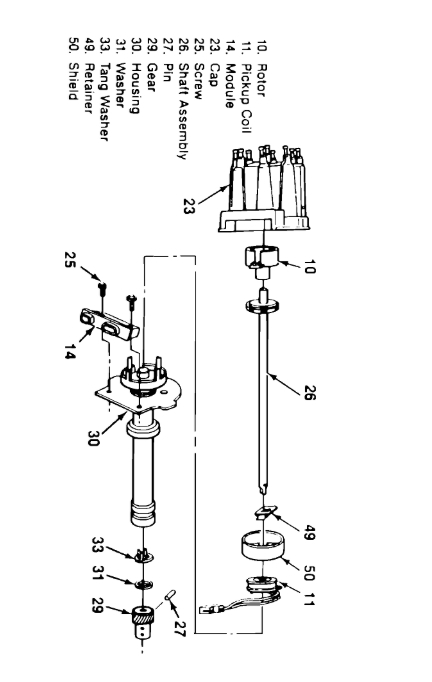

When you replaced the distributor did you do the ignition module? They go out all the time here is diagram to show you how.

Yes, it was the ignition module that messed up the distributor and I also had a buddy come by with a scanner to read what is going on with the truck and everything on the ECM was working properly. So the truck starts now, then I noticed one of the injectors was not spray it was dripping more then anything especially when I stepped on it. I replaced the injector and now it seems like the temperature takes forever to reach "operating temperature" and it runs badly. It idles okay, but when I step on it I get a response and immediately loses power, does not shut off but no acceleration, I have to floor it to get it to move. It does a little better when the temperature gauge is around 200 (operating temperature on my gauge) but still not perfect. Do you think the ECM temperature gauge is bad and it is making my cluster temperature gauge show different readings. I changed the ECM temperature gauge probably four months ago and it has been working fine. Maybe I should just change both? I do not know, what do you guys think?

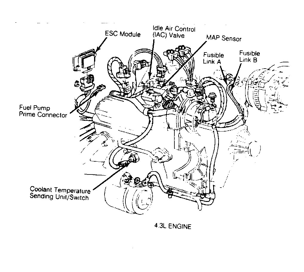

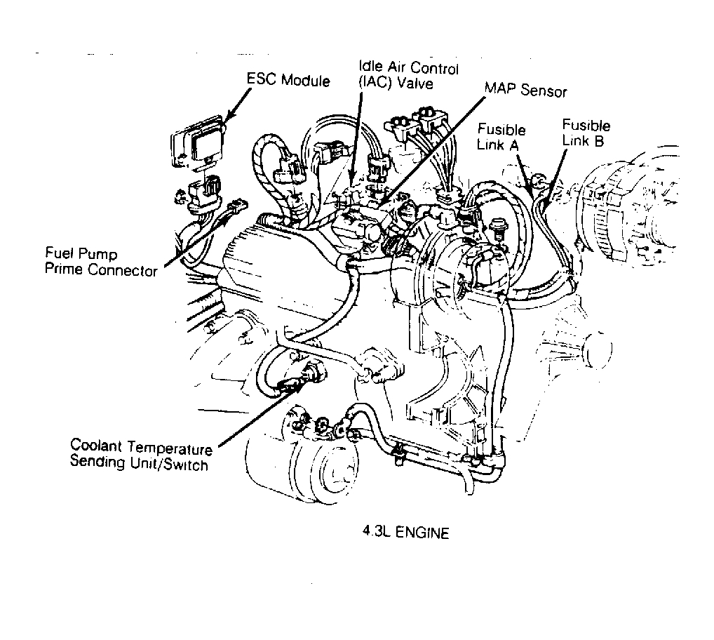

The tough part about obd1 is you cannot read the values so it is a bit of a parts shoot. It sounds like when the PCM gets warm it can control the engine. Let run down this guide next.
Go over this and do some checks and get back to me. Ken
