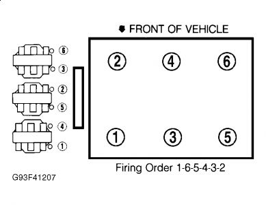

OURWORLDENTER
  • 11 POSTS
I have a grand prix and when i put it in park,
it IDLES up and down until the engine cuts off.
It starts back up but it does that all the time now.
Apr 19, 2019 at 11:05 AM (Merged)
  • CAR REPAIR CONTRIBUTOR
  • 110,190 POSTS
HAs the check engine light come on? Chances are it is the idle air control valve. the throttle position sensor, or a vacuum leak. However, I can't be sure without a code from the computer. Have you checked for vacuum leaks?
SATURNTECH9
  • 30,869 POSTS
Most likely i think its the sensor if you can get a meter we can do some testing instead of expensive guessing.Meters are cheap.
OURWORLDENTER
  • 11 POSTS
code P0135 comes on...
MRGREEN33
  • 5 POSTS
What kind of meter??

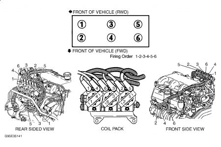

  • 110,190 POSTS
PO135 = Oxygen Sensor Heater Circuit Malfunction (Bank 1 Sensor 1) It sounds like an O2 sensor (heated). Here are some pictures of where bank 1 for the optional engines.
https://images.2carpros.com/forum/automotive_pictures/249084_38_1.jpg
The 3.1L V6 is different:
https://images.2carpros.com/forum/automotive_pictures/249084_31l_1.jpg
https://images.2carpros.com/forum/automotive_pictures/249084_31_1.jpg
Remember, bank 1 is the side of the engine with the number 1 cylender. Also, sensor 1 is before the converter. Let me know if this helps. Joe
