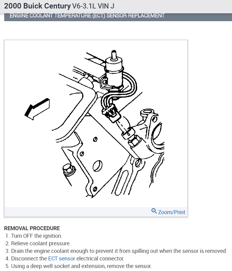

I have seen the engine coolant temperature sensor short out when hot. I would try to change the sensor to see what happens. Here is a guide to give you step by step what to do and the location of the sensor below:
https://www.2carpros.com/articles/coolant-temperature-sensor-cts-replacement

Just to add what Ken said, try disconnecting the fans and see if it still stalls.
Every car is different with there issues and solutions. The most common is the voltage spike from the current draw from the fans creates low voltage to the PCM.
That is why I asked you to do those tests.
