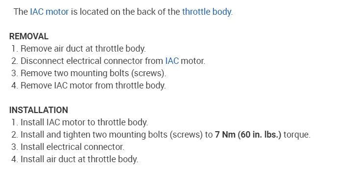

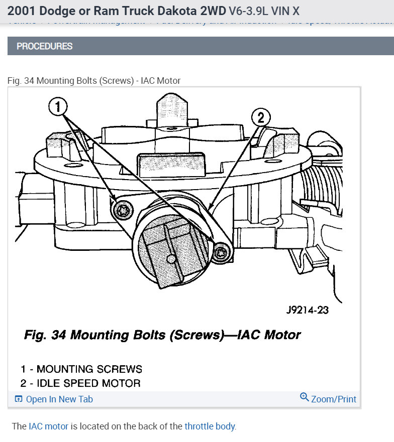

Because the computer system will surge while it is trying to make adjustments. I did notice you said you cleaned up the IAC and did not replace it, I would get a new unit because sometimes they can "glitch" causing the situation you have. Check out the images (below). Please let us know what happens.

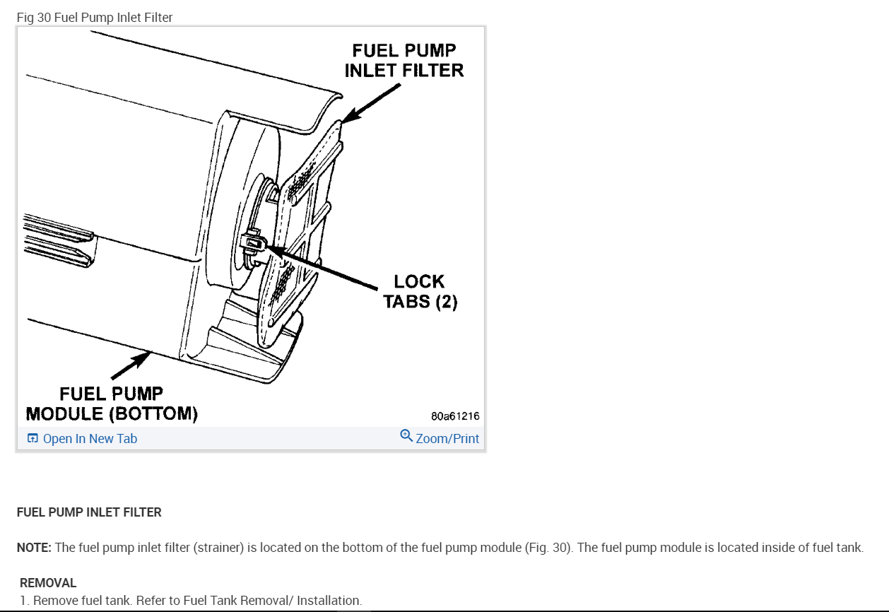

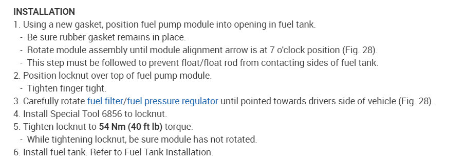

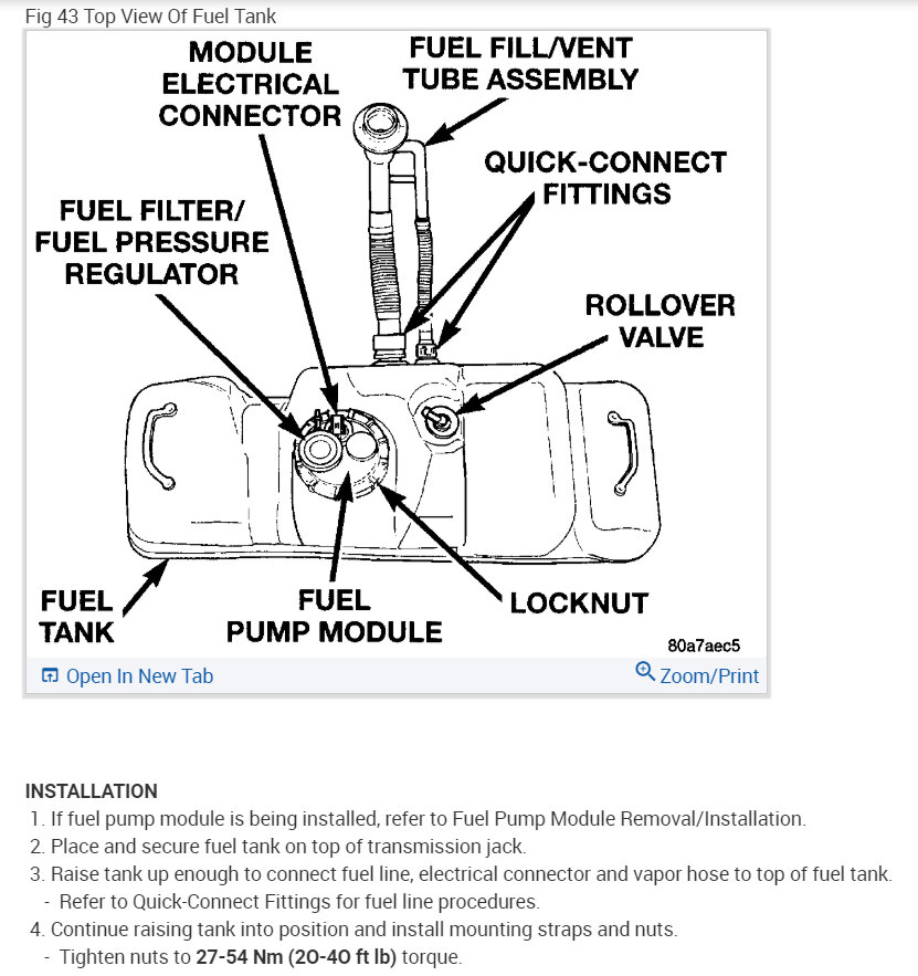

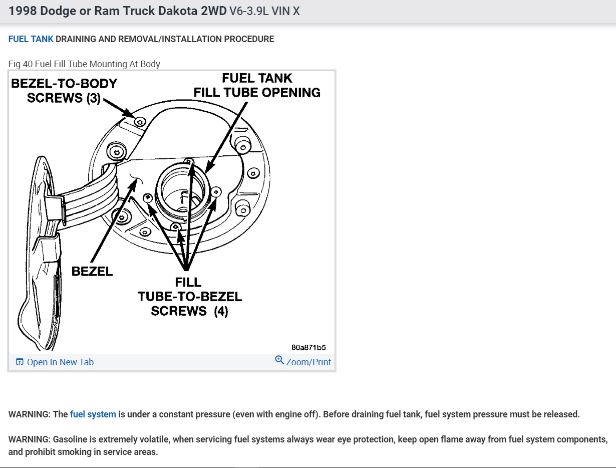

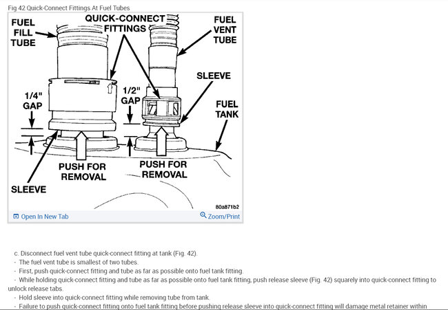

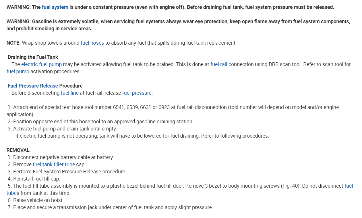

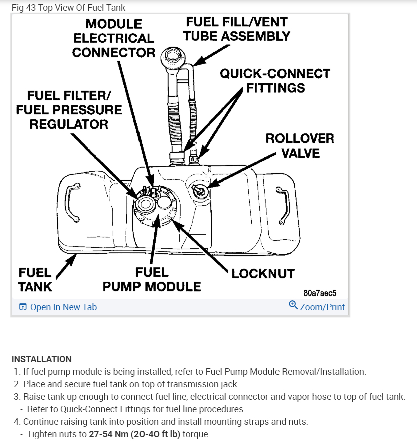

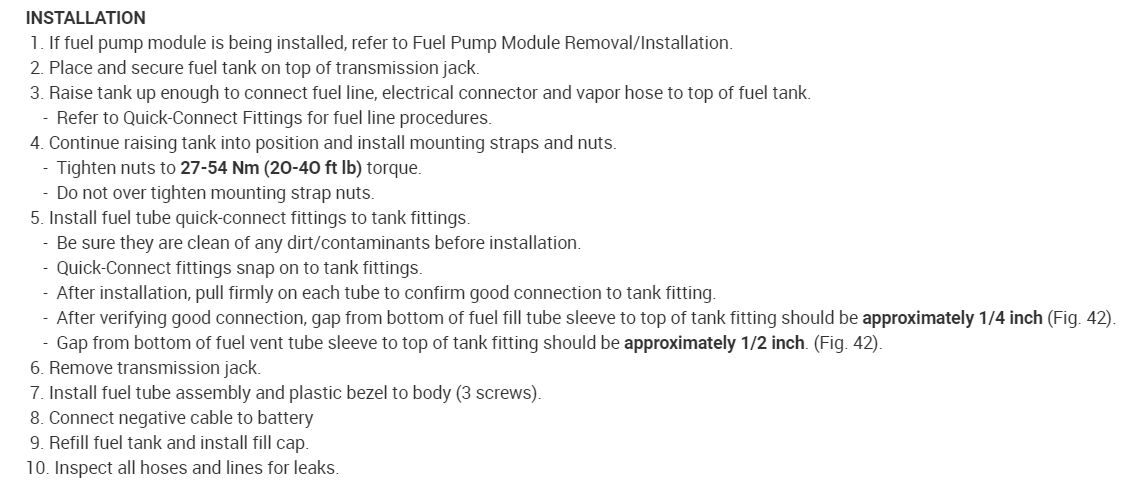

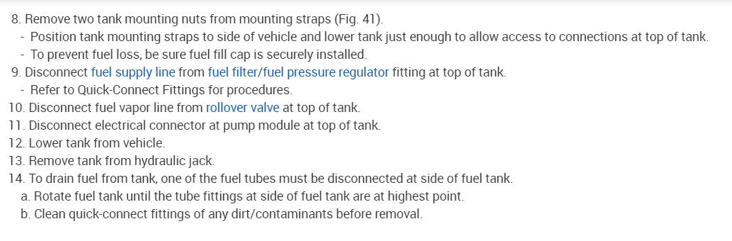

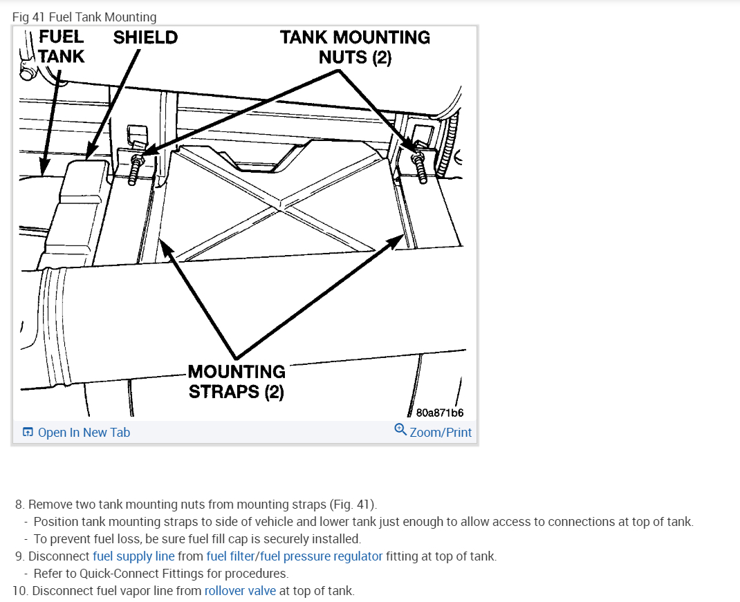

I noticed something and wanted to ask. It seems like the level of fuel in tank factors if. I didn't see it happen all day yesterday in traffic off on all day, then later. As fuel level got to a low level where light comes on it started doing that again. I just put half tank of fuel bk in and will see if it does anything. Can that be the fuel pump? I didn't get to check air leaks, but it would have happened yesterday if it was.
Wednesday, May 3rd, 2023 AT 11:01 AM
KEN L
  • MASTER CERTIFIED MECHANIC
  • 55,516 POSTS

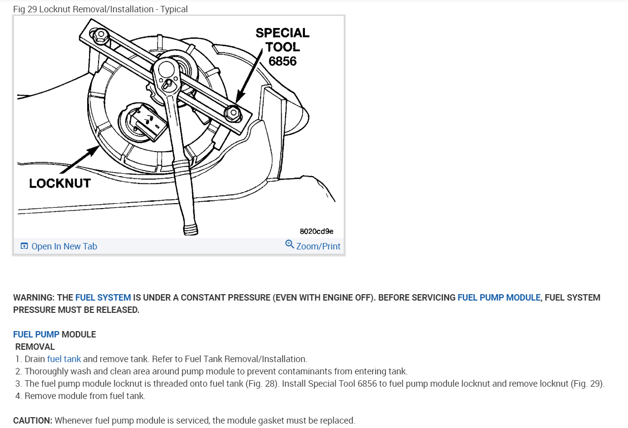

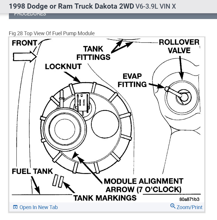

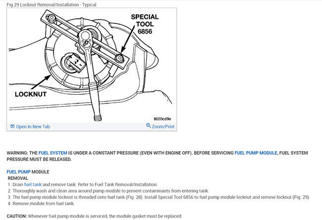

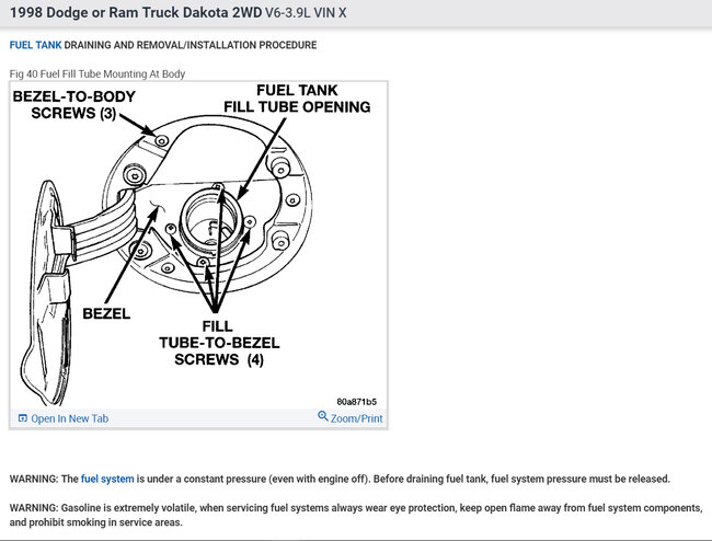

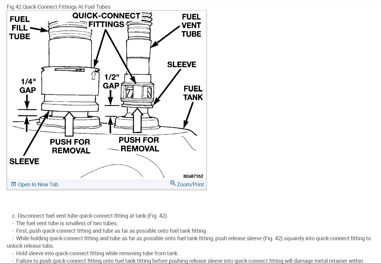

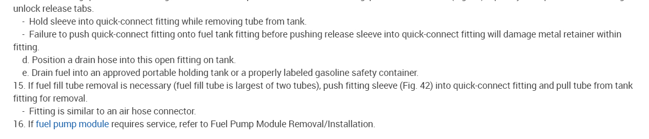

Yes, a weak fuel pump can cause this issue. Here is how to test the pump to confirm this is the issue. You can rent a fuel pressure gauge at the local auto parts store for cheap or free.
This guide can help walk you through the steps:
Regulated Pressure 339 +/- 34 kpa (49.2 +/- 5 psi)
Here is how to change the pump out in case you need it. Check out the images (below). Please let us know what happens.

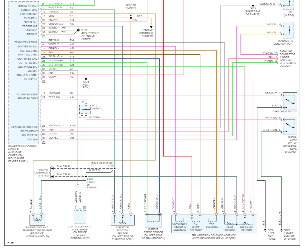

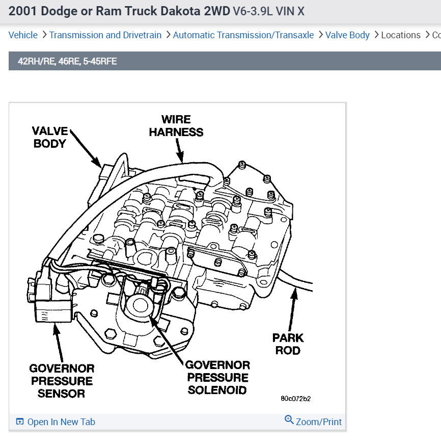

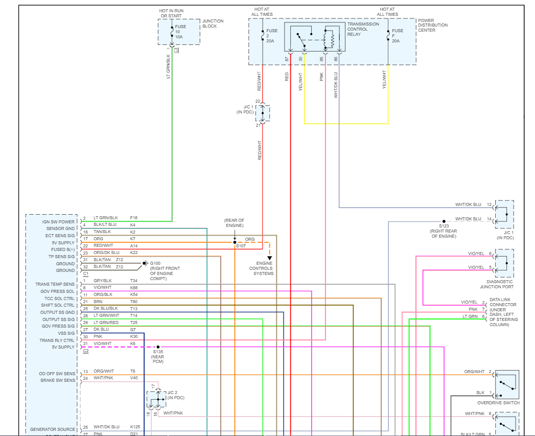

Turned out to be transmission code p1767. What sensor is it and how would I check circuit?
Friday, May 5th, 2023 AT 2:27 PM
KEN L
  • 55,516 POSTS
Here is what is said: The P1767 code in a 2001 Dodge Dakota indicates a problem with the transmission's governor pressure solenoid circuit. This code is set when the Powertrain Control Module (PCM) detects that the governor pressure is not within the expected range.
The governor pressure solenoid is responsible for regulating the pressure in the transmission's hydraulic circuit, which controls the shifting of gears. When the solenoid malfunctions or its circuit has a fault, it can cause issues with the transmission's performance, including harsh shifting, slippage, and poor fuel economy.
I would check out the pressure control solenoid. Here is the location. Check out the images (below). Please let us know what happens.
Saturday, May 6th, 2023 AT 11:21 AM
HIDDEN4321
  • 62 POSTS
Yes, I actually put one on it a few years ago as I put a used overdrive in an changed that broken accumulator Spring.
I just cleaned up the wiring harness to it on the outside. Had transmission like fluid and switched out the relay an checked fuses
if it does it again ill pull that gov solenoid.
Not a very common code.I looked in the service manual for techs and it skipped that code!
How do I check circuit on that harness outside the tranny pan.
If it does it again I will pull the pan an check it all out.
Saturday, May 6th, 2023 AT 12:12 PM
KEN L
  • 55,516 POSTS
You must remove the pan to check the circuit. If the circuit is okay replace the solenoid. Here is a guide and the transmission wiring diagrams so you can test the connections:

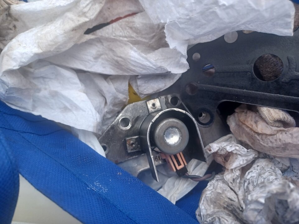

HIDDEN4321
  • 62 POSTS
Better pic. Should I go ahead with replacing both transducer and gov press solenoid and just switch out the body. Which have both intact already?
Any way to test them when off?
Saturday, May 13th, 2023 AT 10:43 AM
KEN L
  • 55,516 POSTS
I would test the continuity through the coil. Please let me know if that fixes it.
