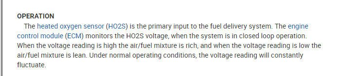

So this is called open and closed loop. Basically the engine starts in open loop and runs off a preprogramed set of parameters based on the temperature sensors.
Then the PCM monitors the engine coolant temp and as soon as it is up to operating temperature, it switching to closed loop and monitors the o2 sensor data as well as the other sensors to fine tune the air fuel mixture.
See below for more detail.
What I would do to confirm this is the issue is unplug the o2 sensors and see if this does not happen at all. This should keep the engine in open loop and that would prevent it from acting up.
Do you have a scan tool that we can monitor o2 sensor data? If the o2 sensors are telling the PCM that it is rich then the PCM should be adjusting but if it is not then the PCM could be the issue. However, the PCM may be trying to adjust this but if the injectors are leaking then that would cause this as well. The only thing that doesn't support this is that you would think a leaking injector would not stop just because an o2 sensor is unplugged.
This is why we need to confirm that when changing the state of open to closed loop and back that the issue starts and stops. If it does then the PCM is the issue since you already replaced the o2 sensor.

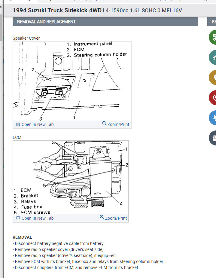

Do we have to take the dash apart to replace the computer? What do you think of the rebuilt computers that are offered online for around $200.00?

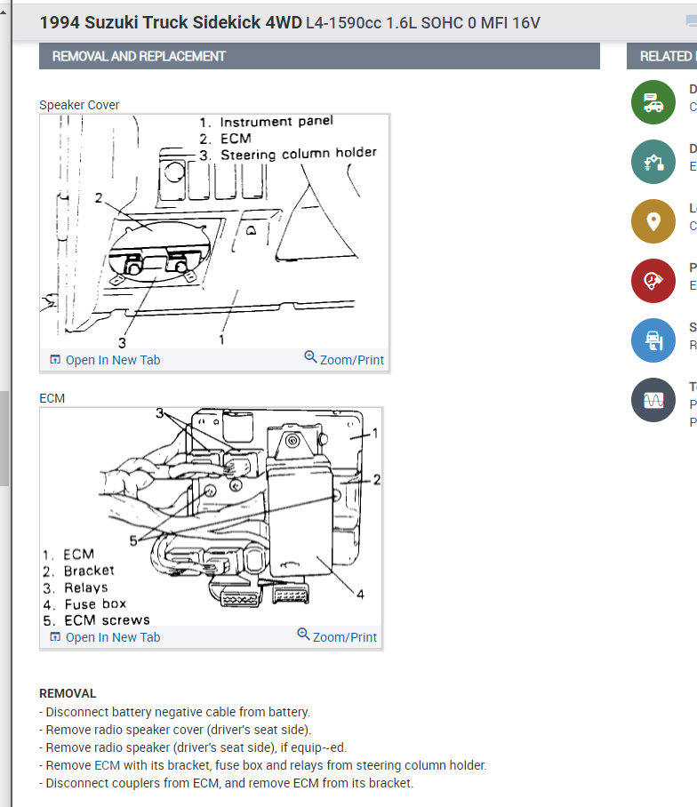

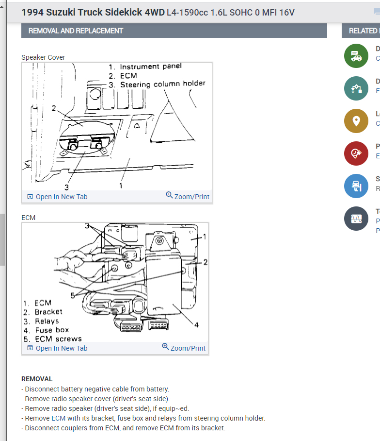

Take a look at the info attached below. I have not replaced this on this vehicle but the manual shows it just on the left side of the steering wheel.
If it were me, I would replace this with a rebuilt unit as they are normally sold with a 30 day warranty. So if they are faulty they will change it out. However if it only last a couple years then that is far cheaper then going with a new unit.
Please see the process below for that info.

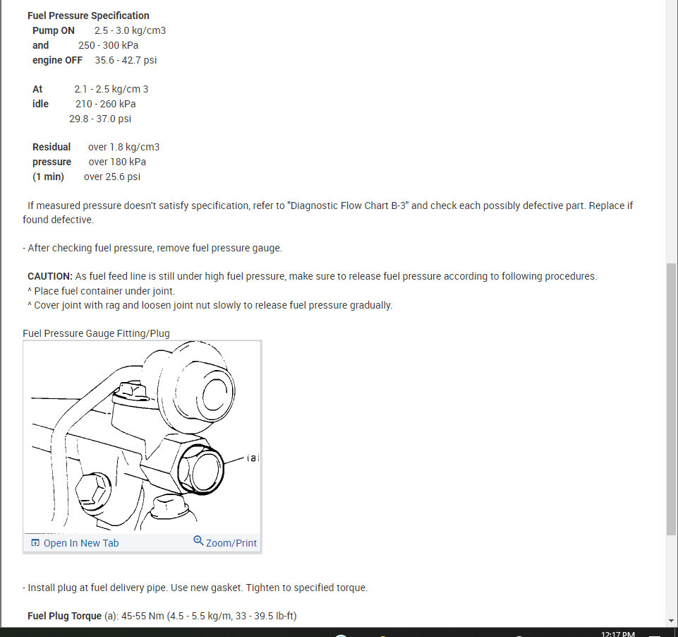

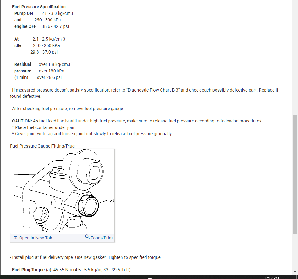

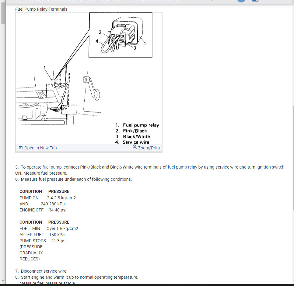

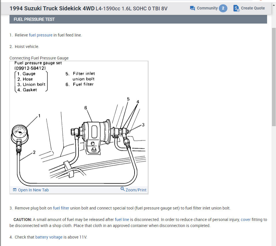

Oh wow. I figured that would have been it. If that is the case then we do need to confirm a fuel pressure issue. That means we need to check what it is at the rail.
I attached the process below for both the 8 and 16 valve engines depending on which you have.
This would most likely be a regulator issue if you are correct and the fuel pressure should reflect that. Basically if it is high and not limiting the pressure then when the injectors are opening they are spraying too much fuel due to the pressure being too high.

Things got worse. Fuel pressure checked okay. Pulled plug wires while running. No.2 cylinder made no change with wire out. Spark was good so must be no fuel. My thought that all 4 plugs sooty black meant too much fuel was a mistake. Decided to replace all injectors while at it. Set of 4 injectors cost from $46.00 to $600.00! Bought "reconditioned OEM Nikki" injectors for $96.00. Motor starts but not enough power to move the car. Wrong injectors? Or did we mess something up during the change? Should we try to clean/repair old injectors? Will spending more money on injectors be the answer? We are lost, need your advice. Thanks much, Rick
