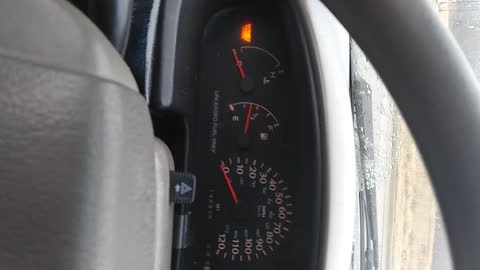

Service engine light on

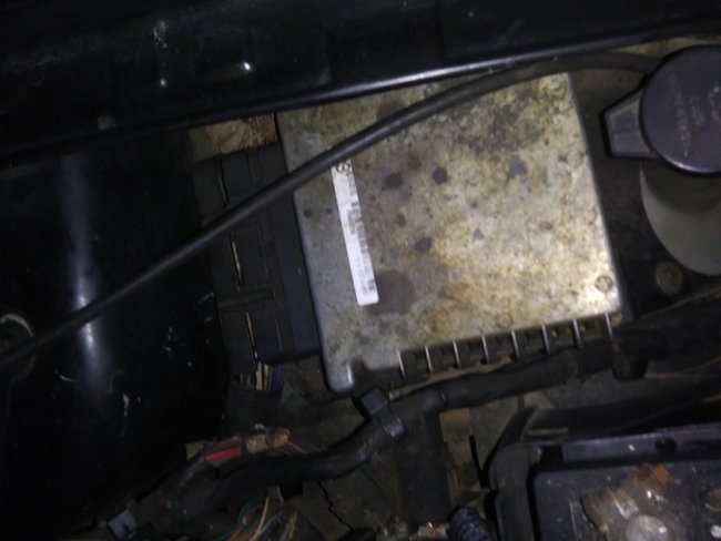

Believe I got that straight. The connectors seemed loose inside connector. I been driving for about 20 minutes and when I shut it off I heard a humming sound that seemed to be coming from that box that is located on top of driver side fender. Does that mean computer trying to go bad?
Wednesday, December 4th, 2019 AT 6:49 PM
Can you post a picture of the box?
Wednesday, December 4th, 2019 AT 6:51 PM
JOHN GLASS
  • 53 POSTS
Did you ever get my picture? I will send again.
Thursday, December 5th, 2019 AT 4:12 AM
Unplug it after turning it off. If the noise stops, then yes, replace it.
Thursday, December 5th, 2019 AT 6:54 AM
