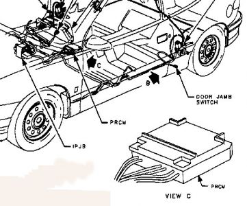

BTW, I jumped the ALDL today, and got 2 instances of a code 26. Could that code be related to the bad coolant temp sensor that I recently replaced?
The quotes below are what I found on the web today when searching code 26. What do you think? I cleared the trouble codes today by jumping a & b 3 times within a few seconds. No new codes have surfaced since then.
Thursday, April 26th, 2007 AT 6:28 PM

Erase the codes and see if they reset. If you get another 26 check out this link. Almost too much info. I would think the code has to do with the cooling fan.

Thanks for the link. Interesting. I found this on the page you linked to.
Check circuit 817 passive restraint module for an open or short to ground.
Interesting because just yesterday, the passenger side passive restraint kept going back and forth about 12 inches while in the forward position (near the front of the travel rail). The next time I started the car a few hours later, it was working fine.
Also, today, the red seatbelt warning bulb was flickering very quickly and there was a clicking sound coming from within the gear shifter assembly. It sounded like a bad speedometer clicking sound, if you know what I mean. The clicking gets faster at speed and slows down at speed. But not exactly linear in relation to the speed of the car.
Don't know if the two are related, but I was thinking it sounded a bit like the clicking of a circuit going on and off.
Thanks again for the link. Very helpful. Now, I just need to find the location of the passive restraint module.

https://www.2carpros.com/forum/automotive_pictures/30961_satmod_1.jpg
Passive
Restraint
Control
Module
https://www.2carpros.com/forum/automotive_pictures/30961_satmod1_1.jpg

Thanks Paul. Well, that explains a lot.
1. I hear that clicking sound in the console
2. The rapidly flashing red seatbelt light in the dash
3. The passive restraint freaks out every few days or so
4. And the code 26.
I'd say all signs point to the PRCM. Will hopefully get to this next week.
The diagram is great. Thanks a ton!
