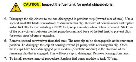

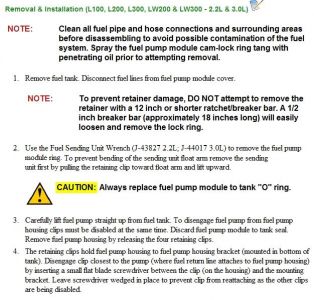

How do I eplace a fuel pump on a 2001 Saturn l300?
Thursday, March 18th, 2010 AT 12:54 PM
BLUELIGHTNIN6
MECHANIC
16,542 POSTS
+2
Thursday, March 18th, 2010 AT 4:50 PM
