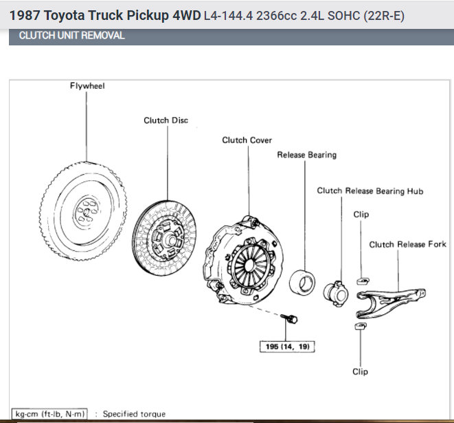

When you replace the old clutch and flywheel, do you have to line the new flywheel with anything on the engine? I know you have to line the clutch up with the flywheel.

The flywheel bolts directly to the crankshaft. On some Toyota engines the flywheel bolts are slightly offset so that the flywheel will only bolt on one way. But short answer is no, you don't have to line up the flywheel to the crank like you do with the clutch and pressure plate. The torque specs for the flywheel bolts is 80 Ft pounds.

Unless it has some odd type of bolt pattern or an alignment dowel as some externally balanced engines have, it should simply bolt on. Be sure to add some loctite to the bolts if they don't have thread locker on them already. I would check the pilot bushing or bearing though while you have it apart, if it's the original I would change it out. Easier to do it now than have it act up after it's all together. Be sure to put the clutch disc in the correct direction, have seen them put in the wrong way a few times, that can cause problems.

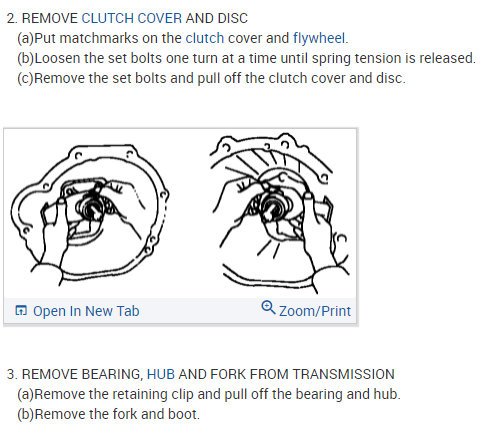

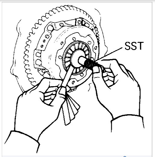

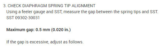

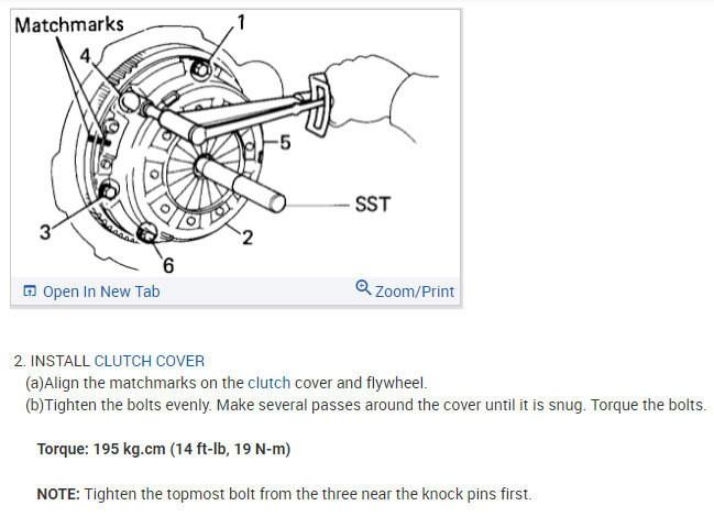

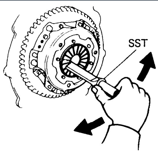

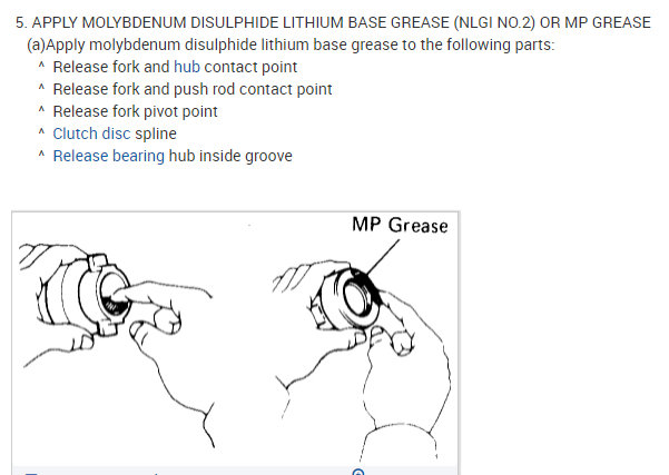

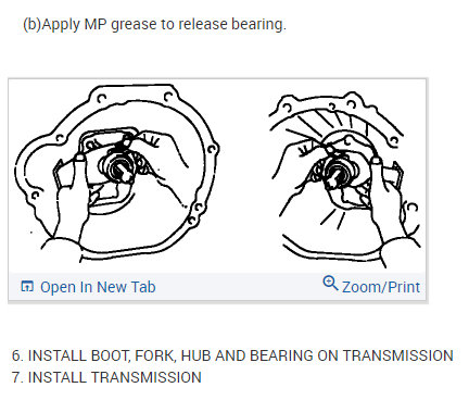

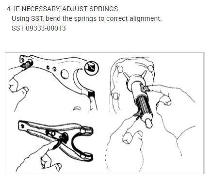

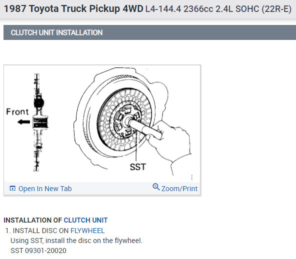

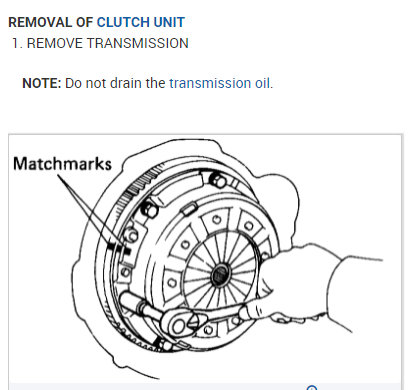

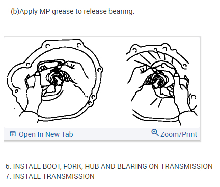

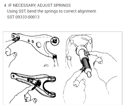

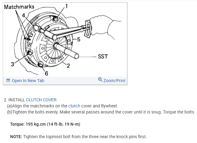

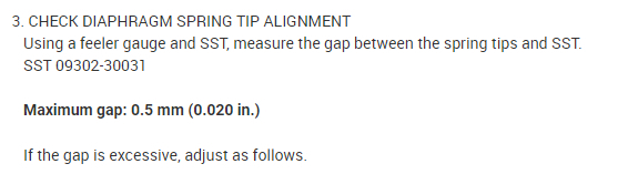

Just to add here this is a tutorial showing how to remove and replace a clutch assembly:
https://www.2carpros.com/articles/how-to-replace-a-clutch
I've attached picture steps below on how to replace the clutch on your Toyota truck. Hope this helps and thanks for using 2CarPros.
