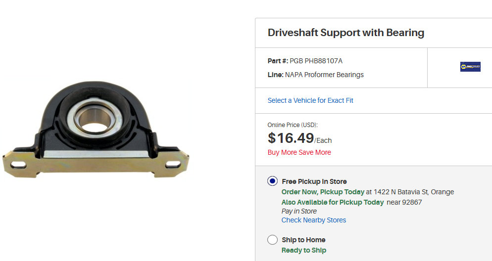

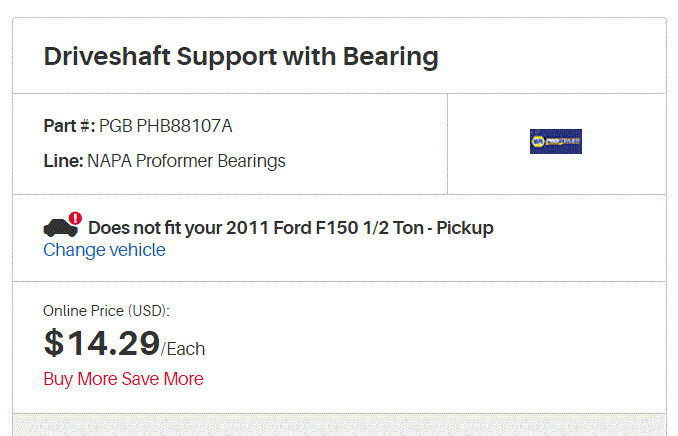

I found the driveshaft bearing and support for you at NAPA. It's only $17.00. Picture is below. Hope this helps and thanks for using 2CarPros.

Thanks for your efforts. But how can you be sure? I thought these shafts were non serviceable? And how would I get it off?
Friday, March 27th, 2020 AT 5:58 PM
CANNON1349
  • 908 POSTS
I looked through Napa's bearings and they all say they don't fit the 2011 Ford pickup. It say it should fit earlier models of Ford pickups

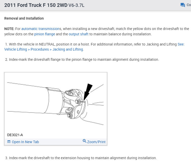

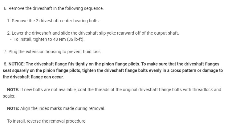

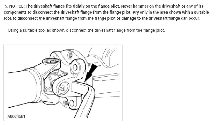

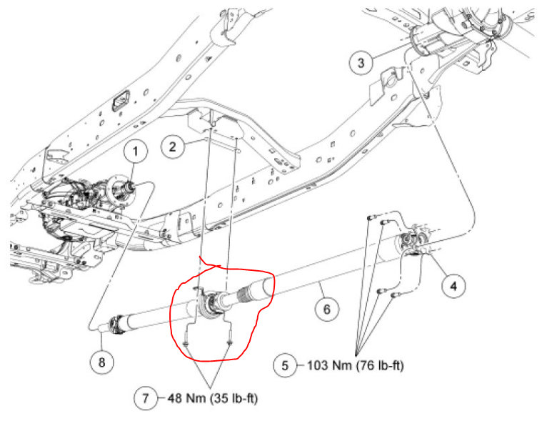

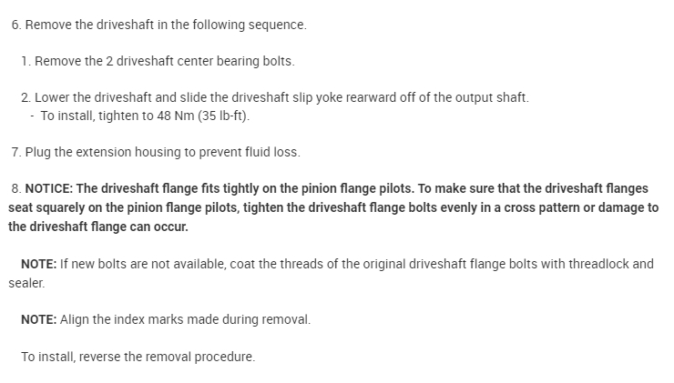

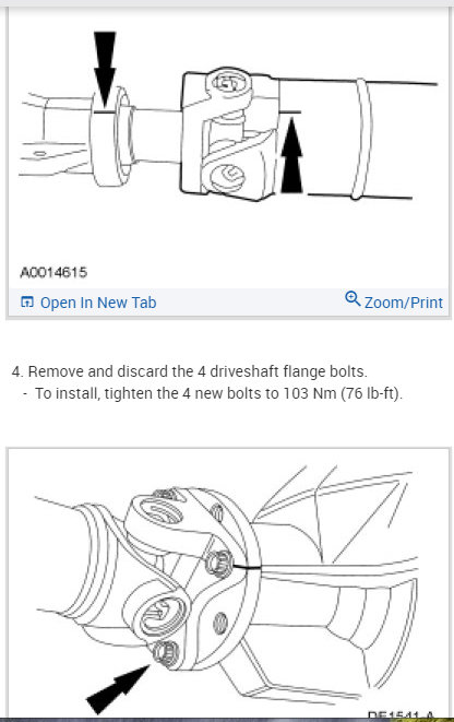

Yes, Your driveshaft is serviceable. It is a 2-piece design. You will have to have the bearing pressed onto the front shaft.Most auto repair places will have a press.Here is a tutorial showing how to remove a driveshaft:
https://www.2carpros.com/articles/how-to-remove-a-drive-shaft
I've attached a picture below of the 2-piece driveshaft for your Ford truck.I circled the bearing in red.Also attached picture steps for removal.Hope this helps and thanks again for using 2CarPros.
Friday, March 27th, 2020 AT 6:13 PM

If this is serviceable, then why are those bearings from Napa, and other center support parts showing up when they don't fit?
Friday, March 27th, 2020 AT 6:28 PM
  • 110,192 POSTS

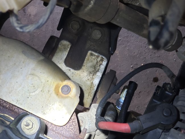

If I can jump back in, the part does look correct, but I checked it and it doesn't fit this truck. See attached. I can totally understand why Danny suggested it. It looks like it should work and when you type in what is needed, it shows that bearing. Ugh! Nothing is ever easy.
Friday, March 27th, 2020 AT 9:02 PM

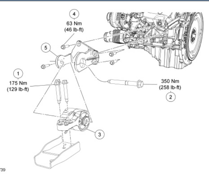

I would suggest loosening both main mount bolts and just doing 1 side at a time. Try using a floor jack with a piece of wood under the oil pan to lift 1 side high enough to get mount out. After replacing just install bolt but don't tighten. Move to other side and do that one. After both are replaced tighten the 2 main bolts.I've attached a picture below of what it looks like. Hopefully you have enough room to get tools and your hand in there. Hope this helps and thanks again for using 2CarPros.
Saturday, March 28th, 2020 AT 3:48 PM
