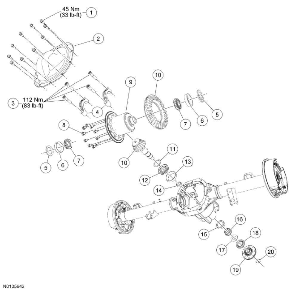

Hey guys. Took the truck to a shop and the ASE master tech said it really feels like the driveshaft splines need to be lubricated with Ford lubricant. He checked the mounts and they didn't move, but he said the engine will jolt forward when the splines get stuck. Apparently there's a TSB out on these.
Also there is a little whine coming from the rear, he believes it to be the bearing on the pinion gear, and to just watch for it to get noticeably louder over time. Is that something you can just take out or does the entire diff have to be rebuilt?

You can replace the pinion bearings without rebuilding the differential. IF you have the the exact differential in the vehicle, I will provide the directions.
Thursday, April 9th, 2020 AT 6:24 PM
CANNON1349
  • 908 POSTS
Its the 8.8 rig, no idea about gear ratio.
Thursday, April 9th, 2020 AT 6:25 PM

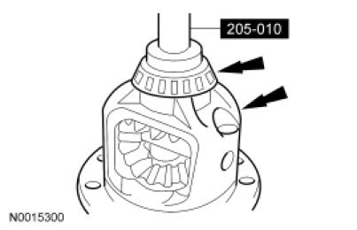

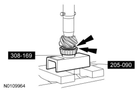

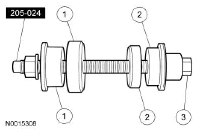

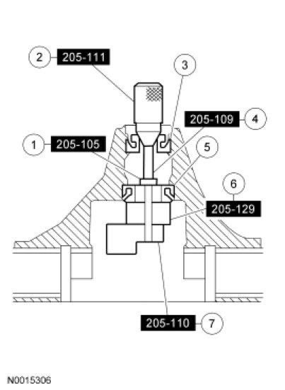

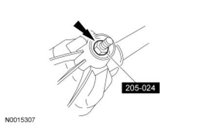

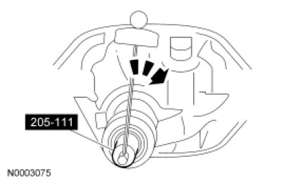

  • 110,192 POSTS

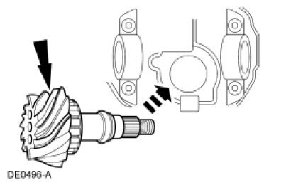

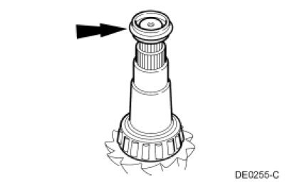

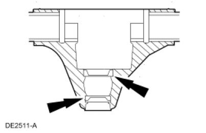

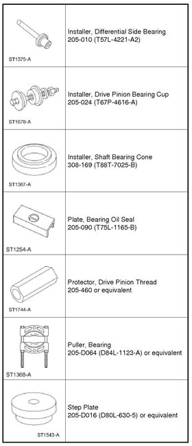

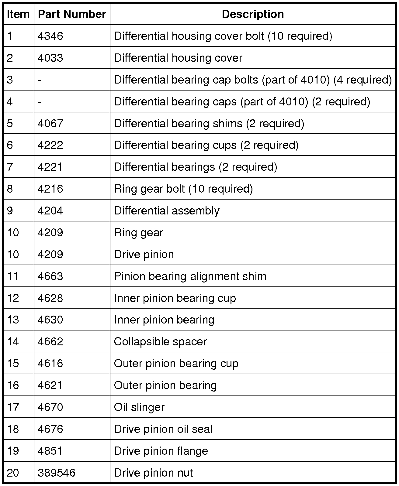

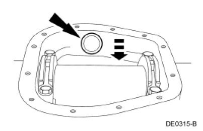

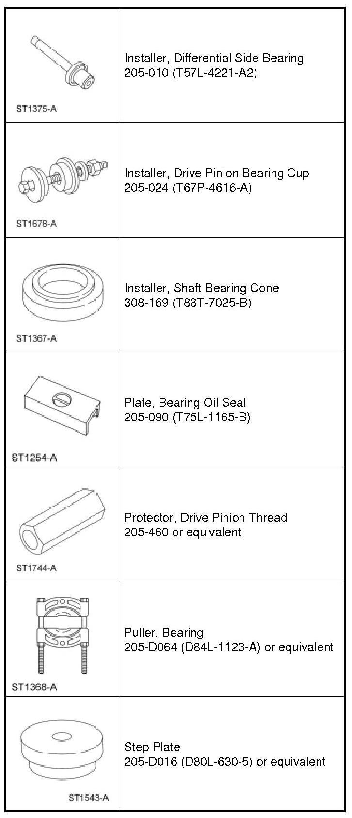

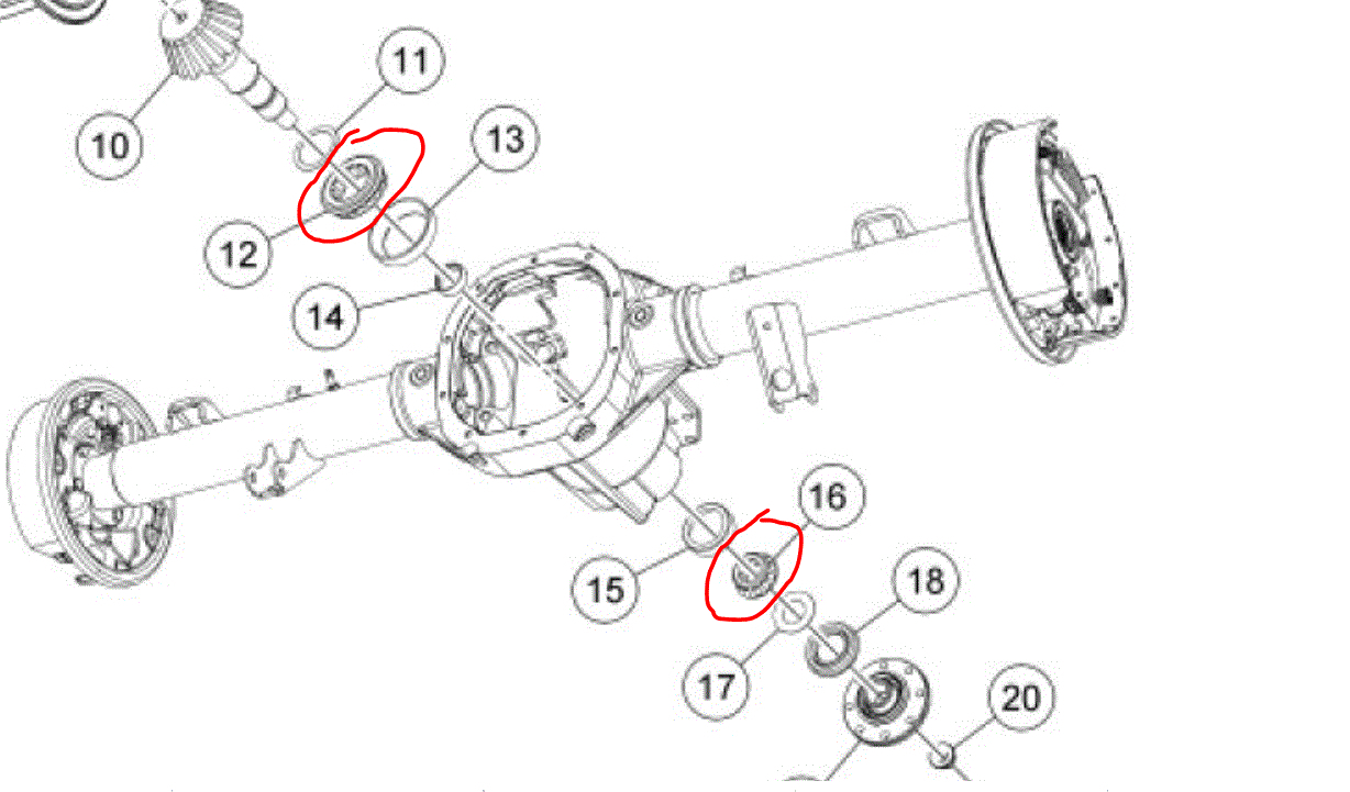

In the last pic, I circled the two bearings that need replaced. You will need to replace the race for each bearing. You will need special tools for this and a press. Note most parts stores will lend you the tools.

Vehicle Transmission and Drivetrain Differential Assembly Service and Repair Removal and Replacement Rear Drive Axle/Differential - Ford 8.8-Inch Ring Gear Differential Bearings
DIFFERENTIAL BEARINGS

Removal
1. Remove the drive pinion seal. For additional information, refer to Drive Pinion Flange and Drive Pinion Seal See: Pinion Flange, Differential > Removal and Replacement > Drive Pinion Flange and Drive Pinion Seal.
2. Remove the differential carrier. For additional information, refer to Differential Carrier See: Differential Assembly > Removal and Replacement > Differential Carrier.
3. Remove the axle drive pinion shaft oil slinger.

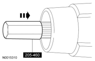

4. Using the Drive Pinion Thread Protector and a soft-faced hammer, drive the pinion assembly out of the outer pinion bearing and remove it through the rear of the differential housing.
Pic 5
5. Remove the outer pinion bearing.
6. Remove the drive pinion collapsible spacer and discard it.
Pic 6

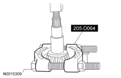

7. Using the Bearing Puller and a suitable press, remove the inner pinion bearing.
Pic 7
8. Using a brass drift, remove the pinion bearing cups by tapping alternately on opposite sides of the bearing cups.
Pic 8

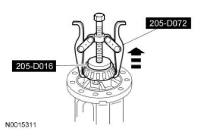

9. Using the 2 Jaw Puller and Step Plate, remove the 2 differential bearings.
Pic 9

1. Position the Drive Pinion Bearing Cup Installer and the inner and outer bearing cups in their respective bores.
1. After placing the inner and outer bearing cups in their respective bores, place the Drive Pinion Bearing Cup Installer on the inner bearing cup.
2. Place the Drive Pinion Bearing Cup Installer on the outer bearing cup.
3. Install the Drive Pinion Bearing Cup Installer.
Pic 10
2. Tighten the Drive Pinion Bearing Cup Installer to seat the pinion bearing cups in their bores.
Pic 11

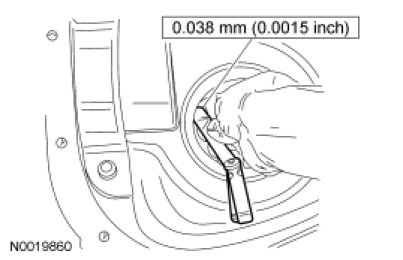

3. NOTE: If a feeler gauge of the specification shown can be inserted between a cup and the bottom of its bore at any point around the cup, the cup is not correctly seated.
Make sure the differential pinion bearing cups are correctly seated.
Pic 12

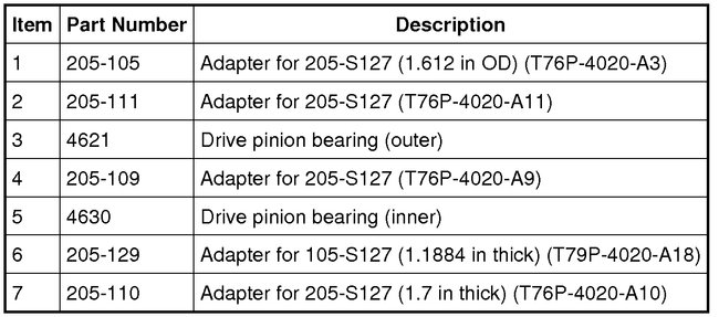

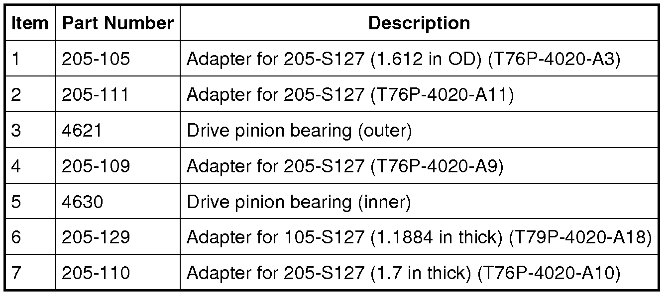

4. NOTE: Install new drive pinion bearings without any additional lubricant since the anti-rust oil provides adequate lubricant without upsetting the drive pinion bearing preload settings.
Assemble and position the Adapters.
Pic 13
pic 14
5. NOTE: This step duplicates final drive pinion bearing preload.
Tighten the Adapter.
- Tighten to 2.2 Nm (20 lb-in) rotational torque.
Pic 15

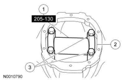

7. Install the Adapter.
1. Position the gauge tube.
2. Install the 2 differential bearing caps.
3. Install the 4 differential bearing cap bolts.
- Tighten to 112 Nm (83 lb-ft).
Pic 17

14. Using the Differential Side Bearing Installer, install the 2 new differential bearings.
