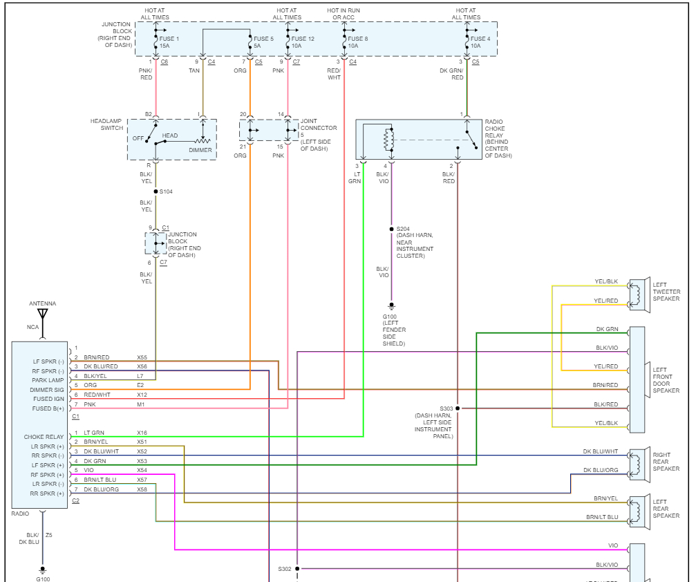

Needing wire diagram for factory radio too much info but needing information for this year model.

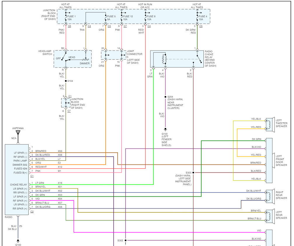

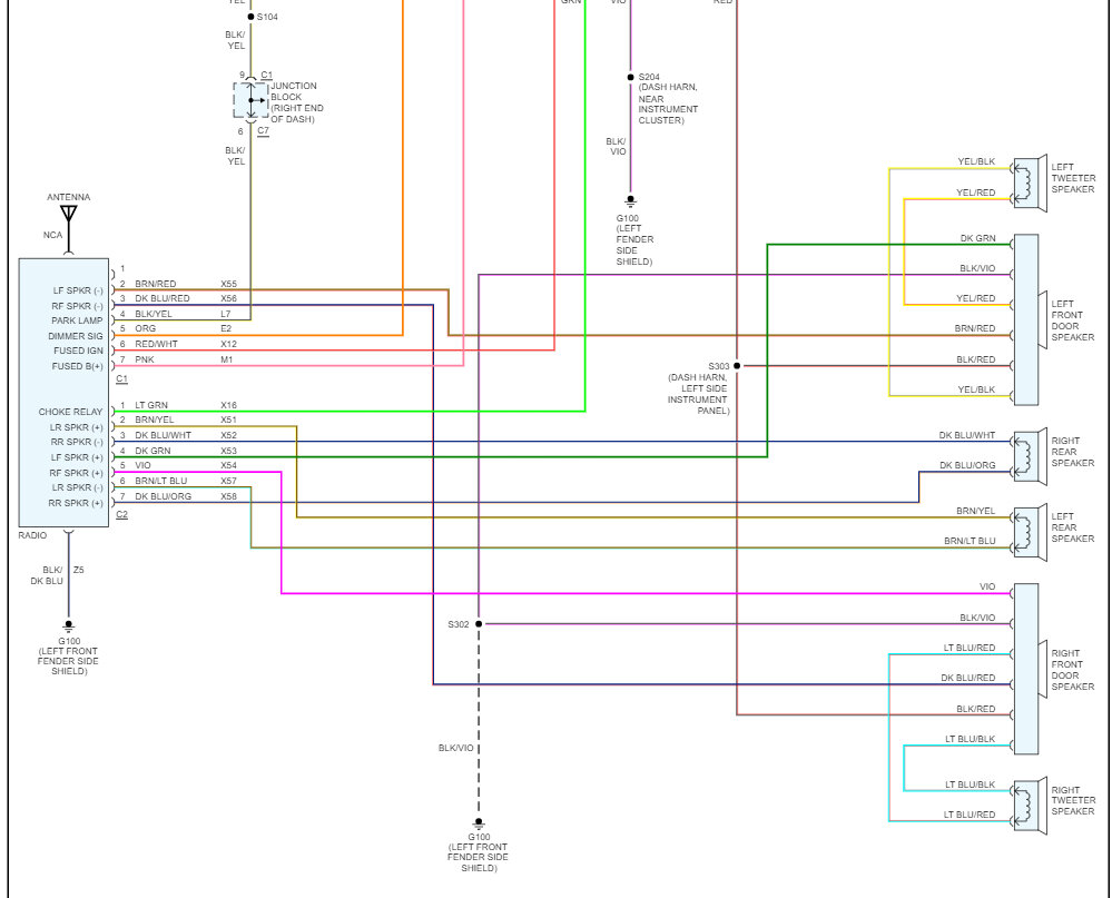

Sure, here are the radio wiring diagrams and a guide to help you test the connections:
