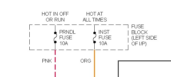

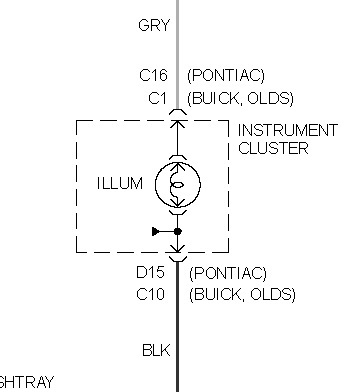

JDL
  • 16,098 POSTS
You need to check applicable fuses and ground for the instrument cluster. Check to see if voltage or ground is intermittent.
Use a voltage tester, check the fuses in the diagram. You can also check wiring at the instrument cluster connector. At the connector D-15 terminal black wire is ground
