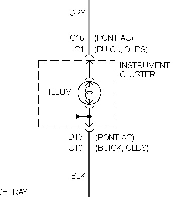

Instrument cluster not working. Checked all the fuses, they all have power in and out. Which wire on the cluster connector has power to it? Are there more than one and are they 12volts or a regulated voltage? Want to know before sending cluster for repair and also wheren can we send it? Thanks again!

Sorry for the late reply. Are you talking about cluster illumination? Sometimes the dimmer switch gets turned all the way down, no lite. In the diagram, gray wire is voltage and black is ground, for illumination.
