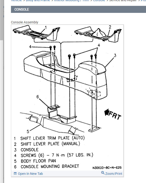

Where are the bolts that hold the console at. So I can get to the heater core
Monday, December 15th, 2008 AT 7:55 PM
MECHANIC
18,907 POSTS

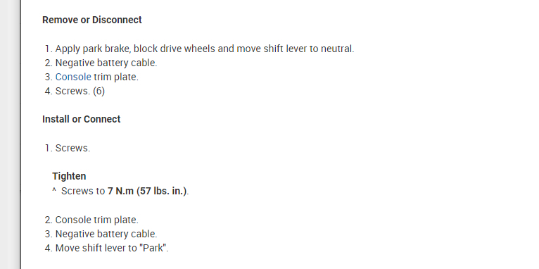

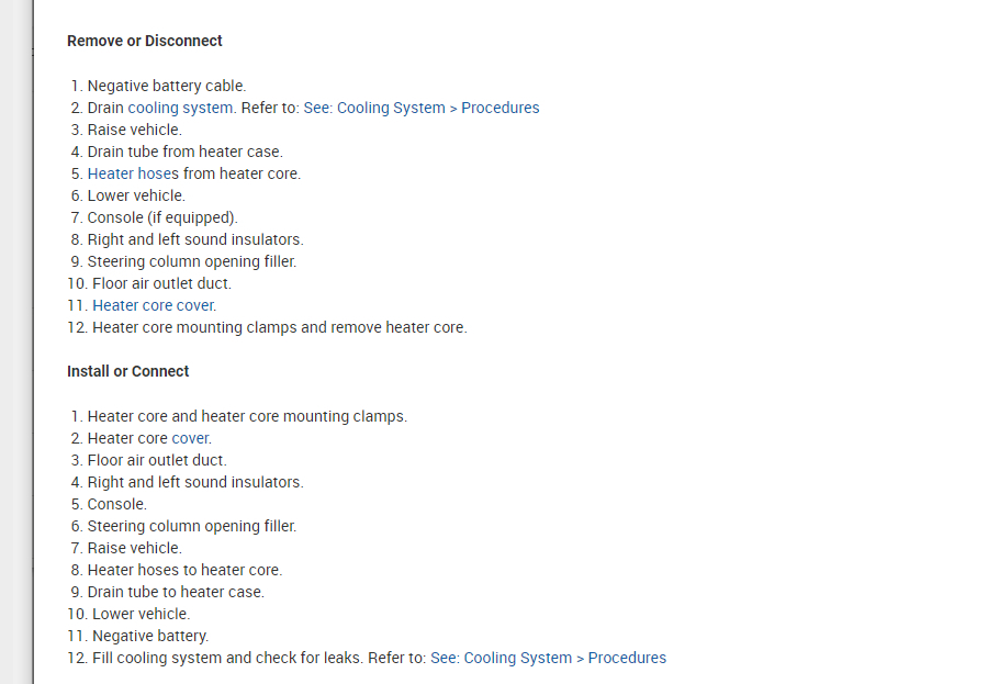

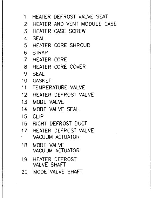

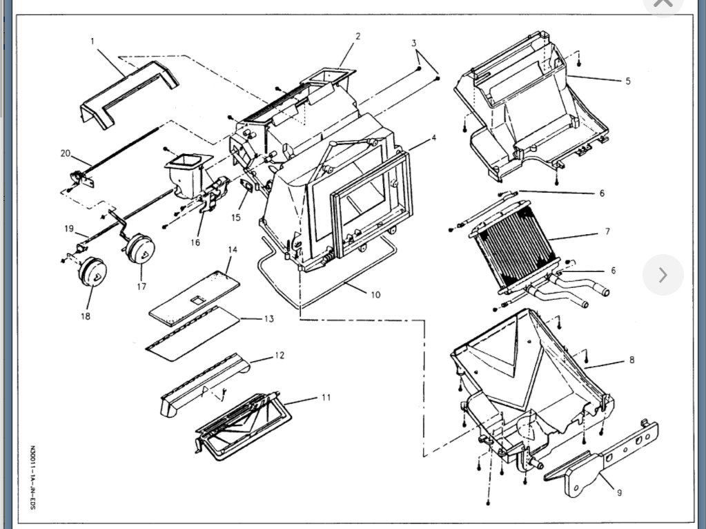

I am attaching the info below on how to remove the heater core and including the process on the console.
Also here is a guide that will help with replacing the heater core:
https://www.2carpros.com/articles/replace-heater-core
Please run through this information and let us know what other questions you have.
